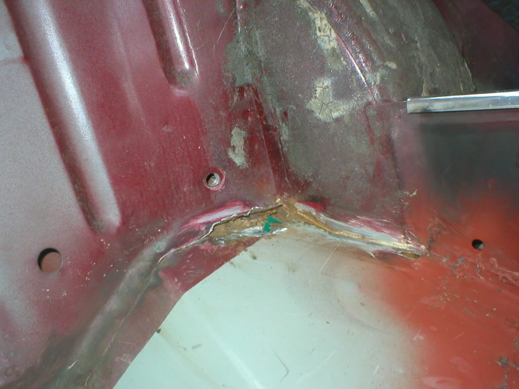

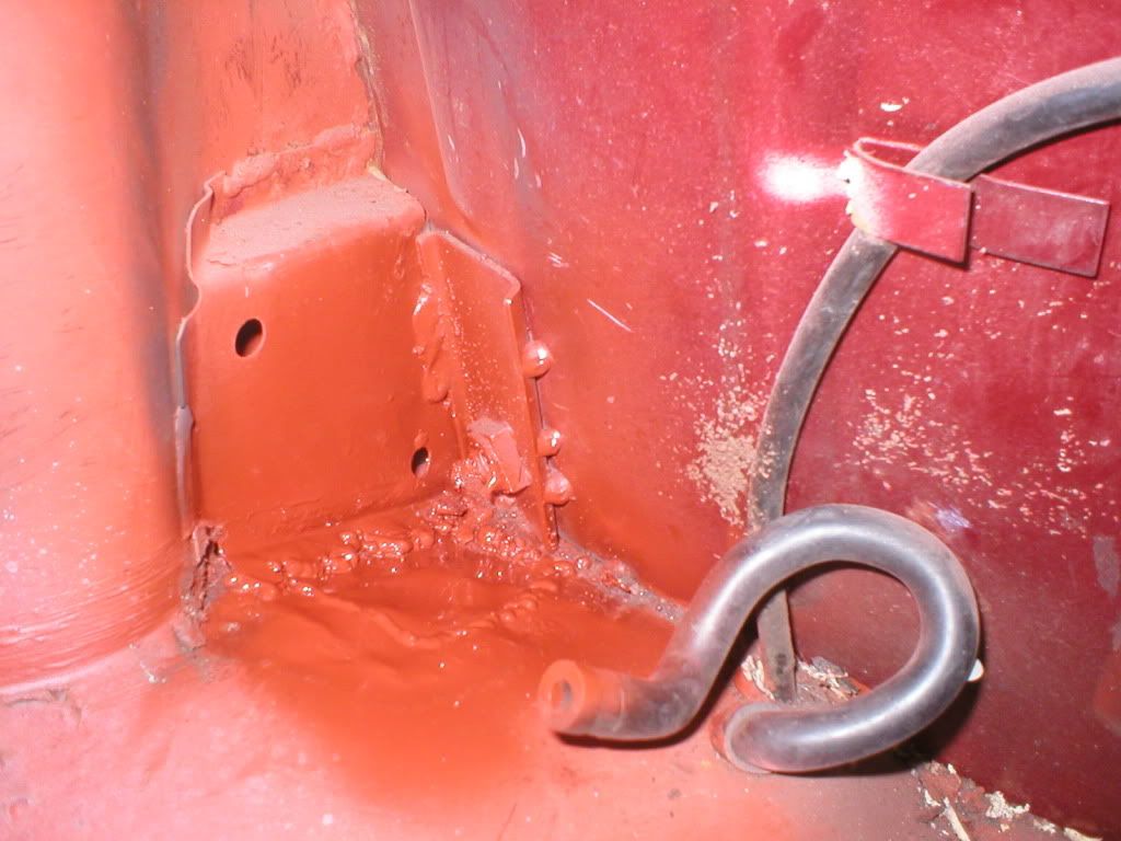

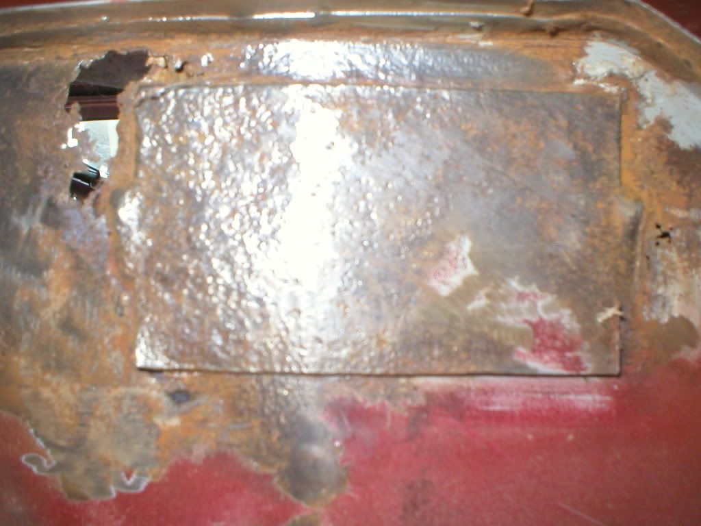

Hi Everyone.
It's official, I am fed up of finding rust!
How can I not have noticed this?!
I went round all this with the grinder a few months ago...
Urrgggghhhh.. Gotta get this thing painted and protected soon... The rust doesn't take long to take hold..
Anyway, I cut it all out..
And welded a new piece in..
The rear seat,
Underneath View
Boot corner view
I am starting to think that a new rear bench/boot floor panel would have been a better option.. Oh well, Onward and upward.. We need to make mistakes to learn from them..
I will grind the welds down when the car is on it's side. I am sick of banging my head for one day!
Thanks for looking, Joe.

Hi everyone. Not much progress today. I welded the new rear subframe resting bit onto the repair I did yesterday. It came out ok. I will grind the welds down when the car is on its side. Really fed up of faffing about under the car. It's really awkward to get in properly with tools.

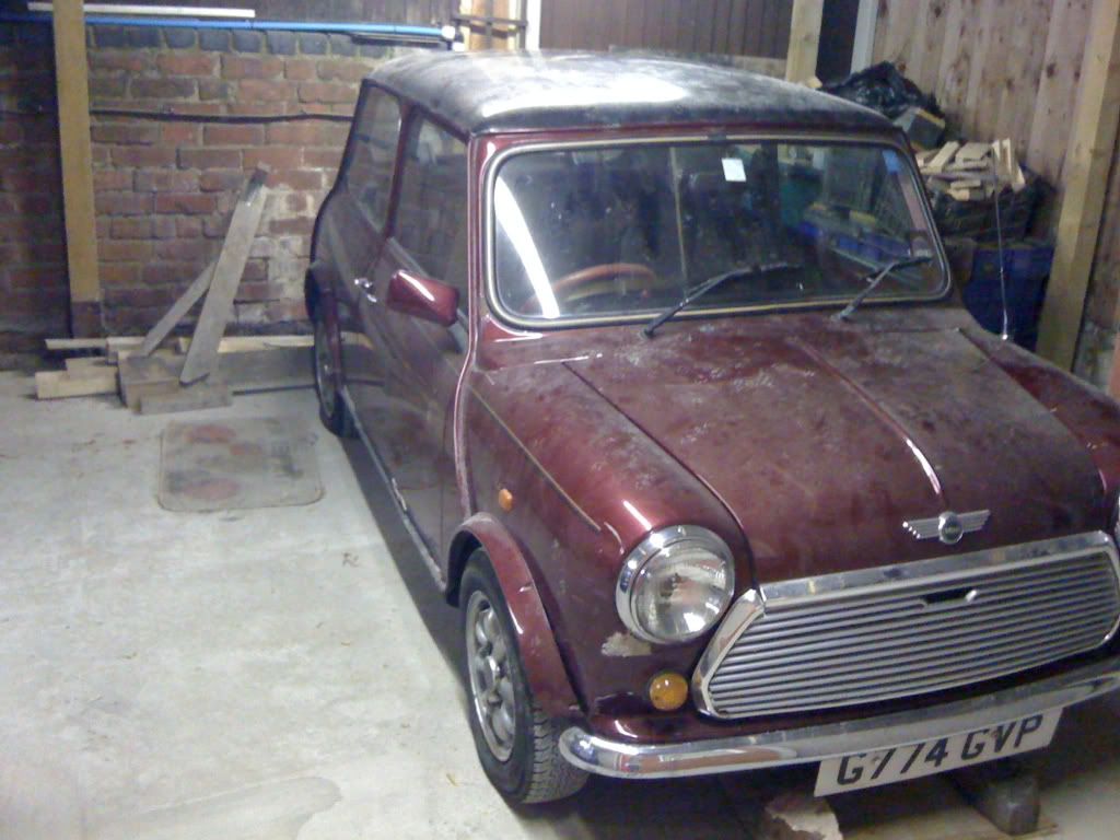

I also found some photos of the car before work started.. I felt quite sad after looking at them.. Lol
Still shiny under the layer of dirt.. Lol
Thanks for looking. Joe
