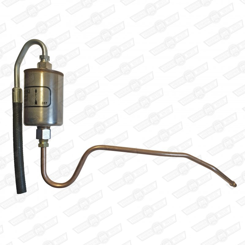

Then got to changing the in line fuel filter only to find that the connections have been modded. So currently trying to get a new piece of pipe made with a standard fitting on the end.

Too much hassle sorting the fuel filter pipes so ordered a complete new set from somerford...

New fuel pipes and filter fitted. All working well with no leaks so fuel tank back in.
