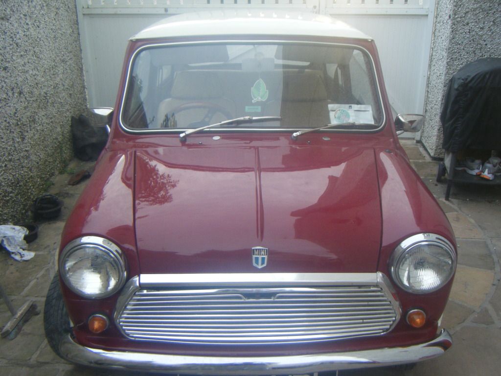

HI all welcome to project auto YA baby YA
i brought this 75 auto on monday.It has 34000 miles so ehgine and box are on the ball Its was first brought in the uk
at a garage in birmingham called Evans
It was 150 miles away in wexford and drove it home :lol: i know alot of you dont like a auto box but with that much
documented miles i could nt leave it
The first thing i did was change the drums to discs ...braking was poor

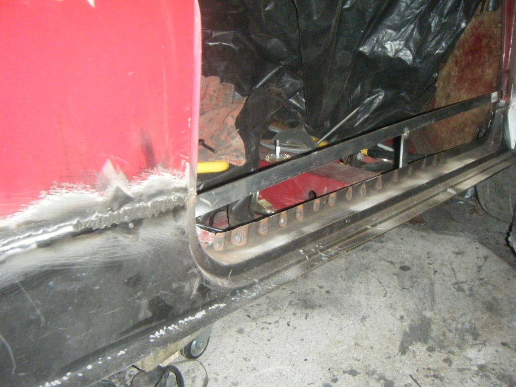

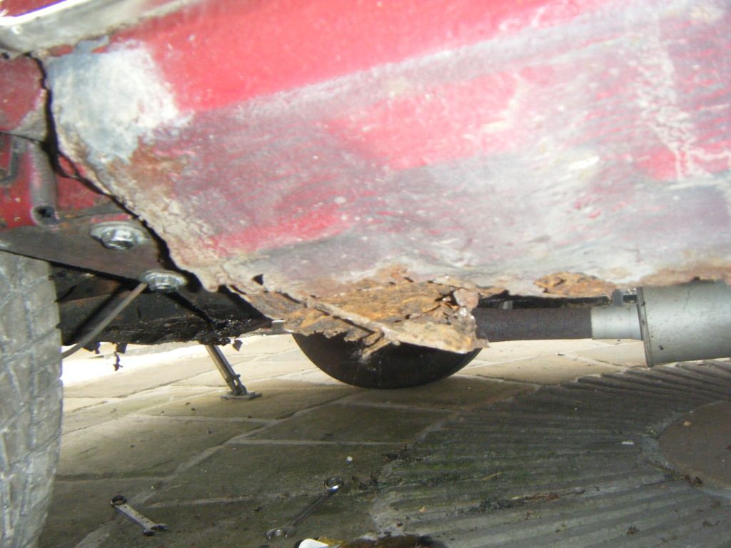

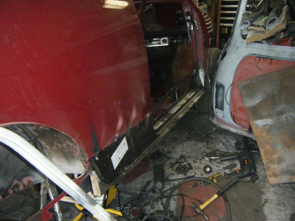

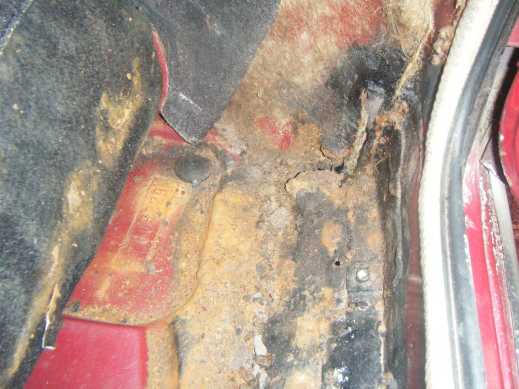

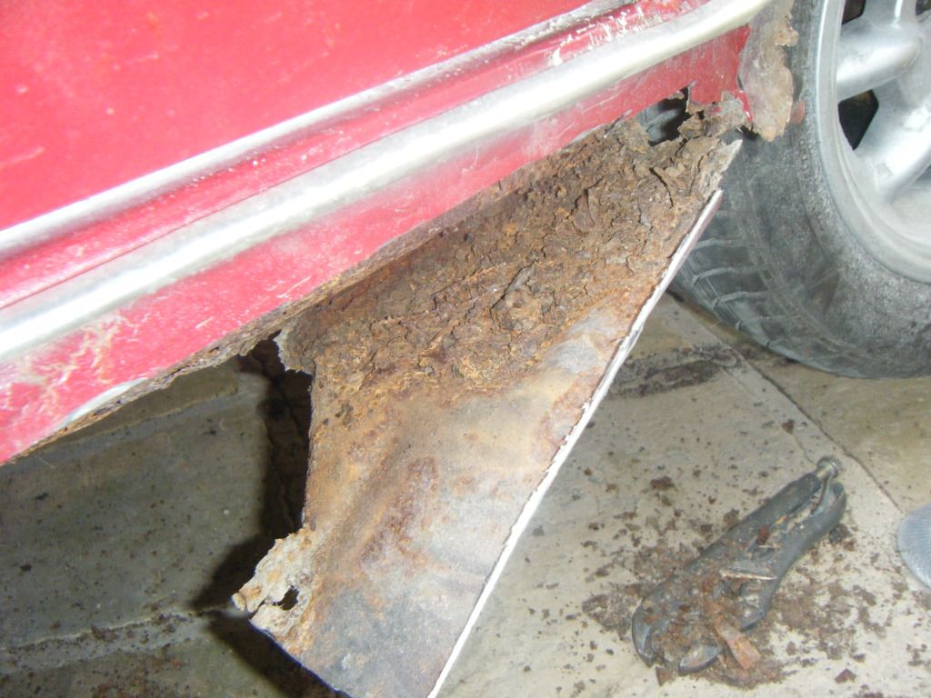

Like all minis it has rust and on the R/H side someone in the past fited a oversill :goaway:
now th rust
Dam oversill
Just waiting on panels :tumble:
Thanks for looking

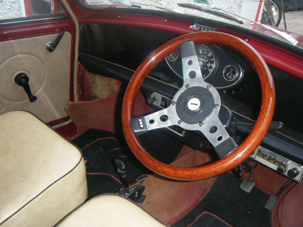

Posted 20 September 2012 - 09:51 AM
Nice mini!! Love the seats

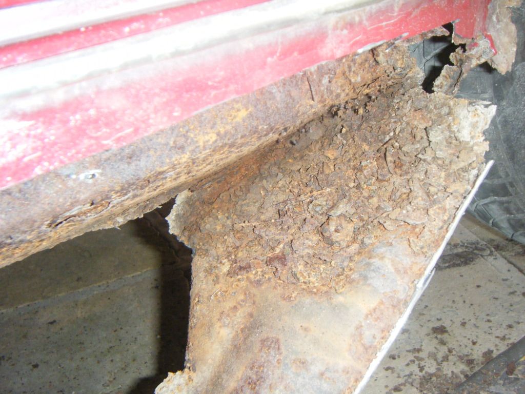

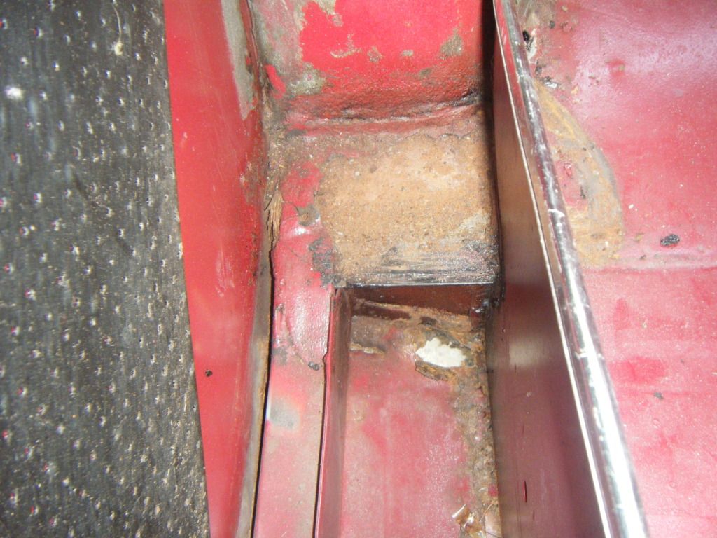

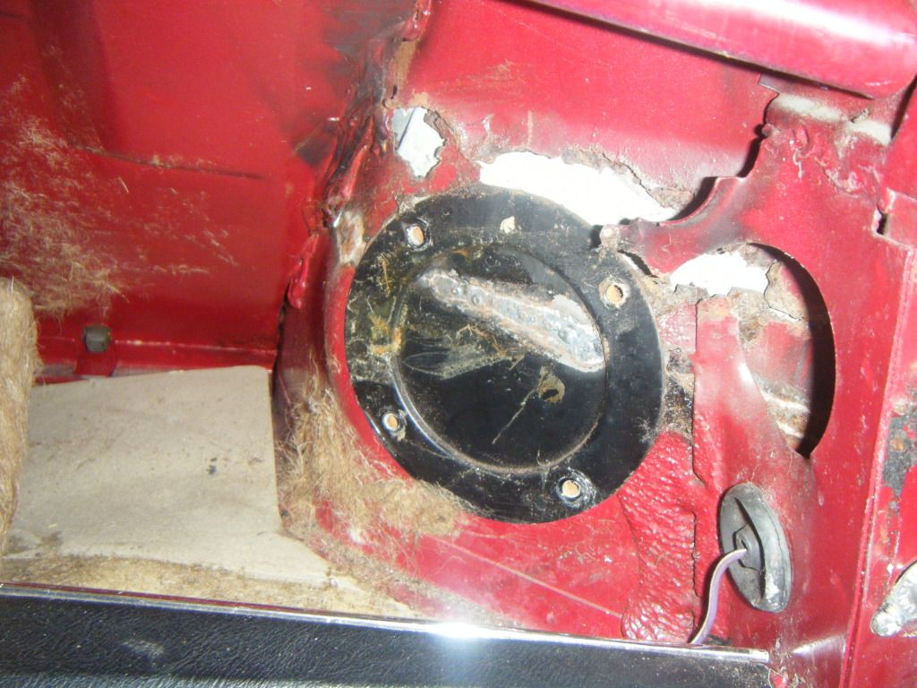

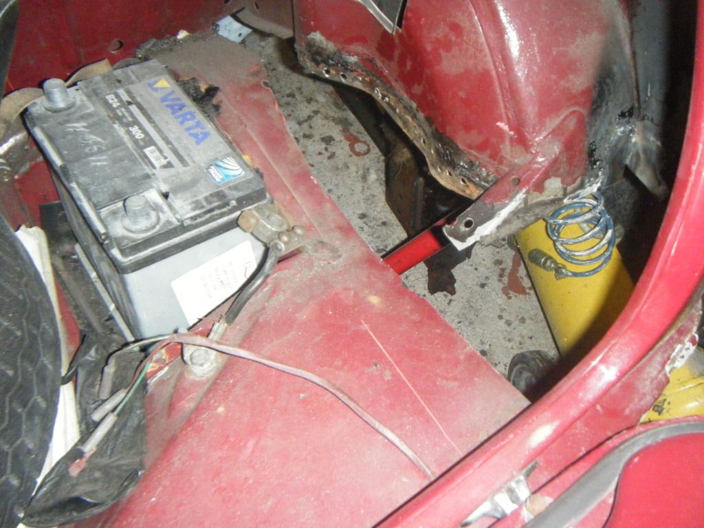

just done a small bit today i took out the drivers seat rear seats i checked the rear pocket and more rust holes
over some one fitting an oversill, the other side has a narrow sill and is very good nic
Also had a look at the air vent behind the dash and someone has done a bad job, just plated over the panel and never threated it
bloody crap :lol:

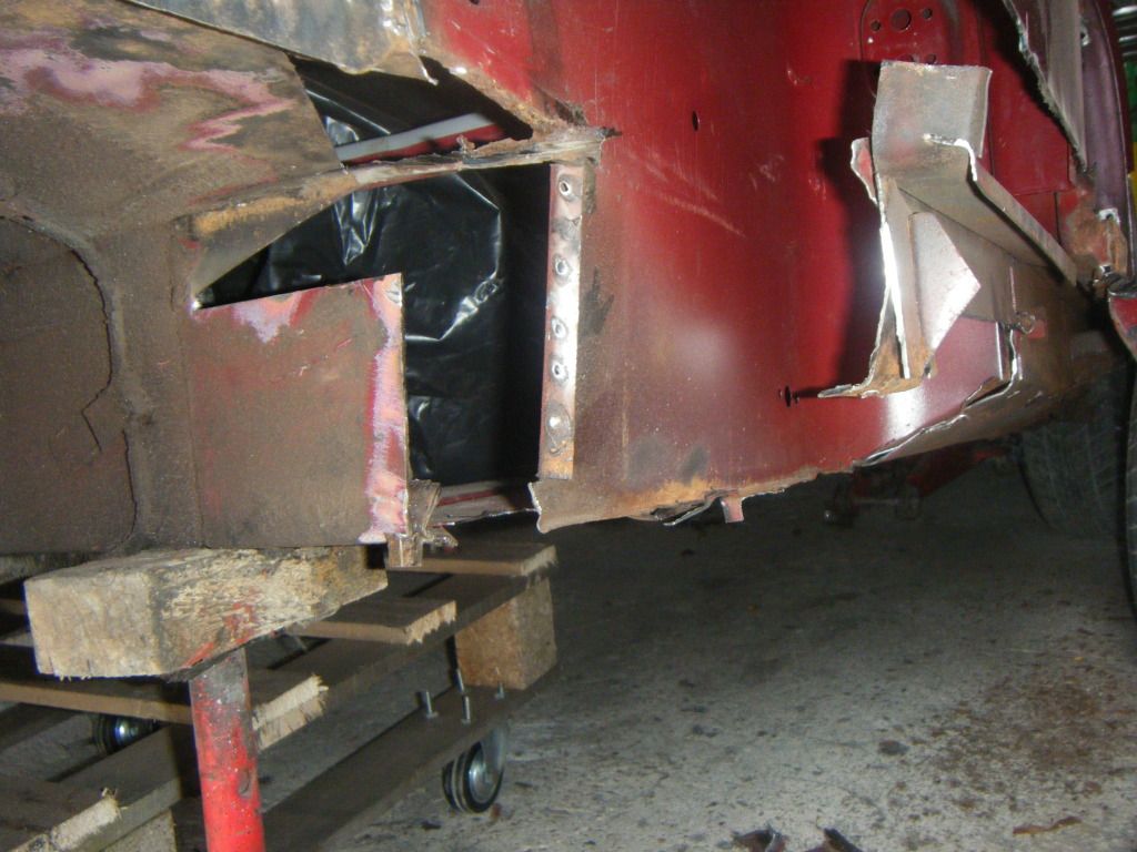

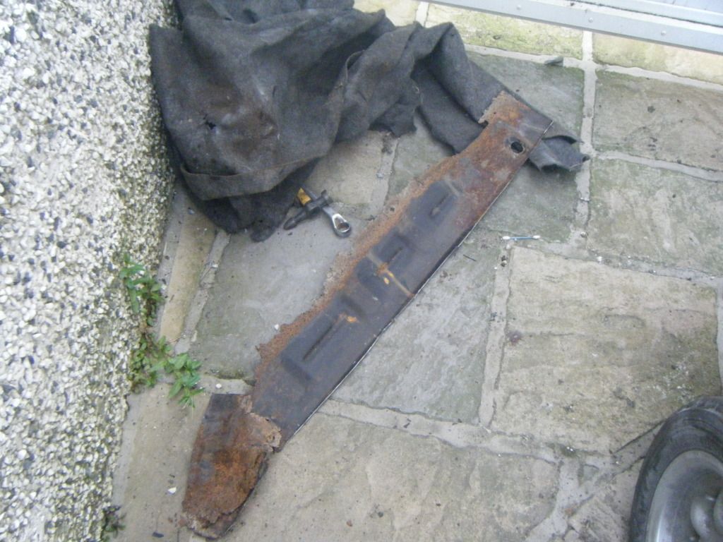

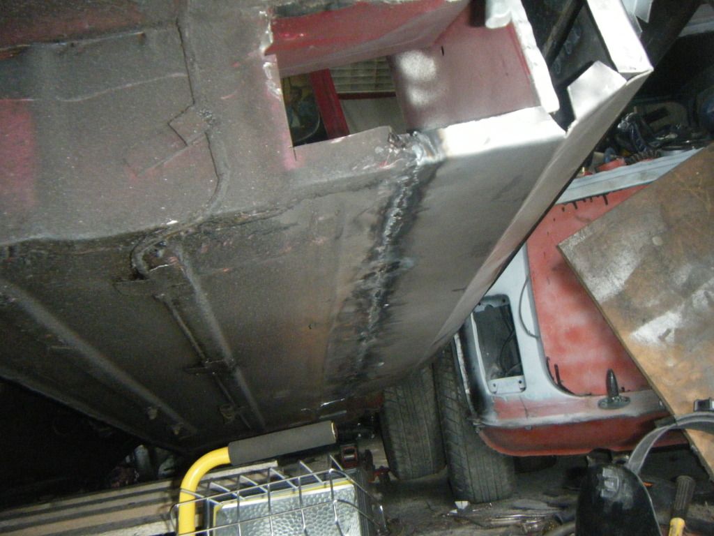

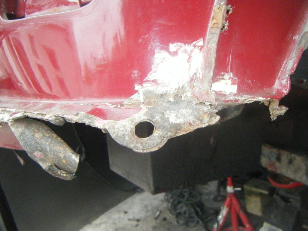

Got back to the auto today and started at the back ,owers in the past tryed to repair the pockets Posted Image
so out came the grinder and started to cut
started with a small repair
new steel in
Then the pocket panel
Then lastly the repaired the plate that goes on the the pocket panel
hopefully at it again monday to start on the floor
i think oversill should nt be sold all of the drivers floor in a bad way thanks to them

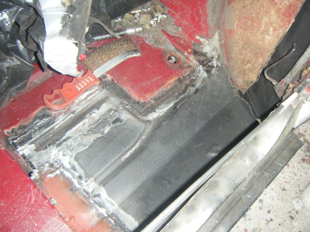

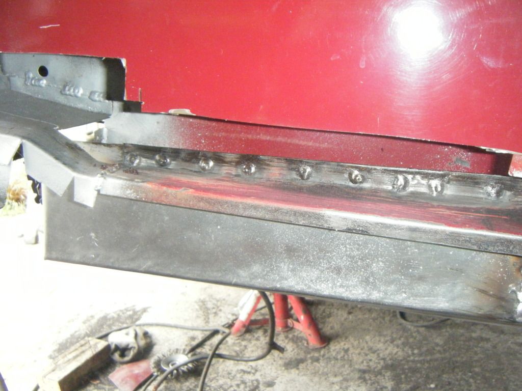

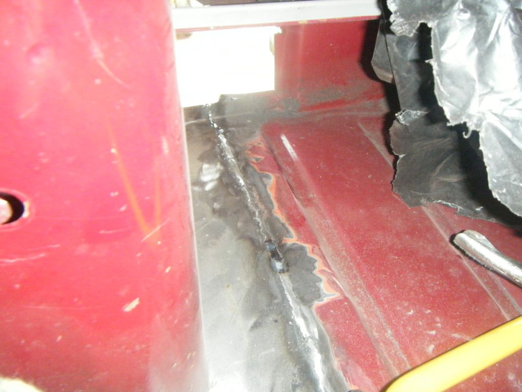

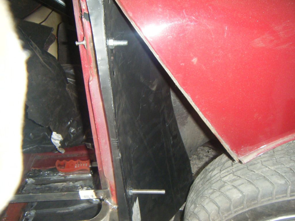

Hi all, more work done today i had to cut out the back of the floor to the crossmember because of rust
i had priced a half floor which was cheap but the p+p to ireland was £32 so i jack in that plan
and brought a sheet of steel and fab my own panel
So heres the panel in place
not bad for my first i think :lol:
Then it was on to the full length bottom panel
a small bit of messing around but it went in ok
Tacked in
seam and spot welded
moving along hopefully move to the rear subframe mounting plate and boot coner floor monday
Any comments welcome cherrs Dave

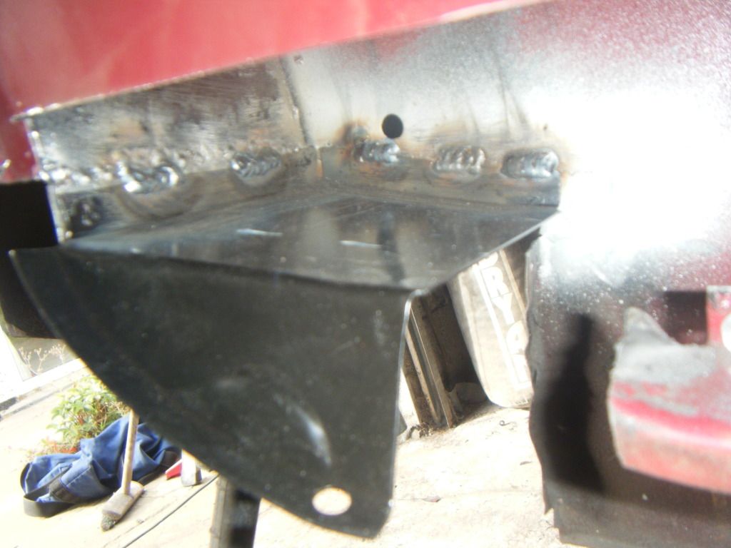

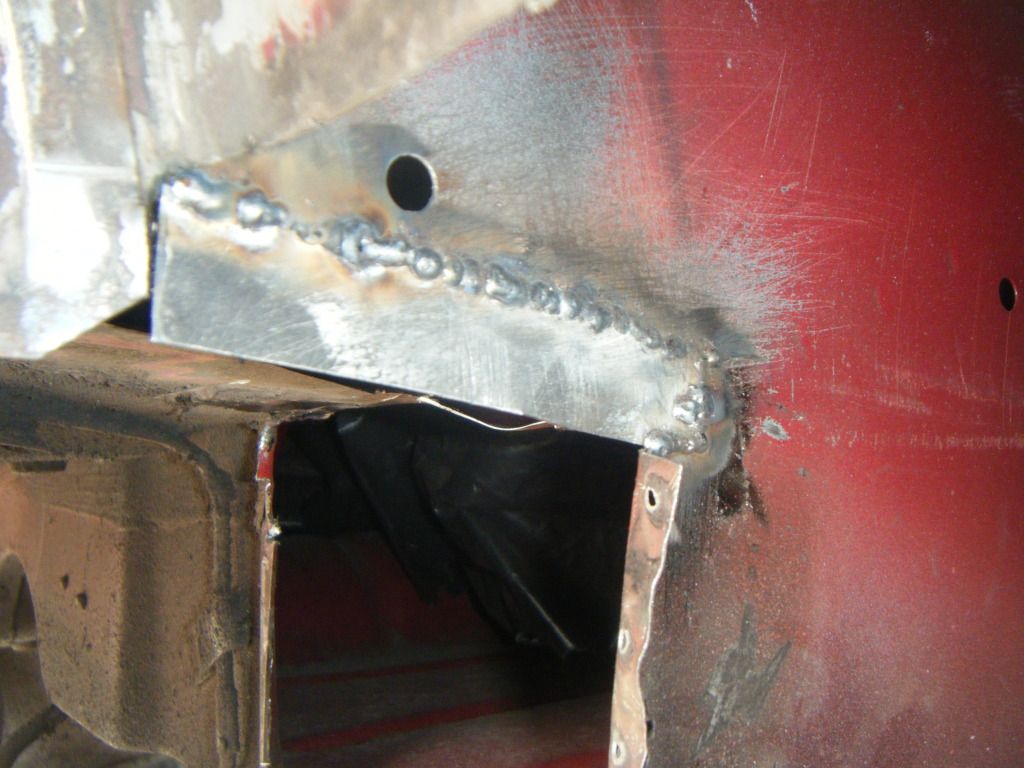

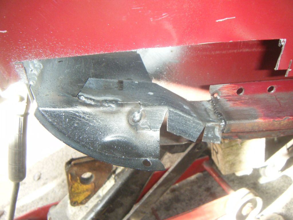

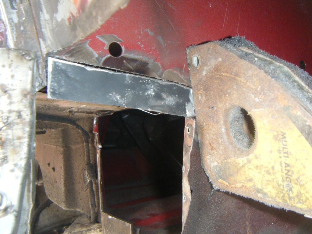

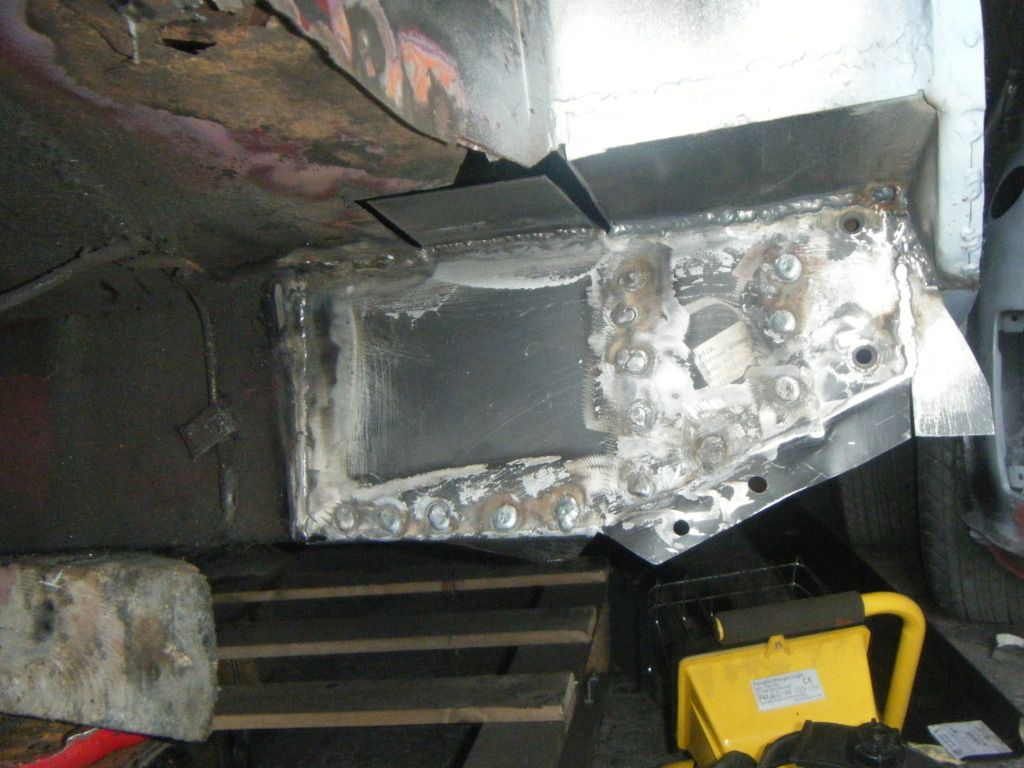

More work done today , i started on the rear R.H subframe mount i didnt get a full geniune one for this project
as i am doing it on a budget
it was a bad fit to start with , so i used a bare rear subframe to line it all up and there was a gap between the panel
and the lower end of the quarter panel
i also welded the nuts to the plate incase they decided to come loose
so welded in a plate checked that it all lined up spot welded and seamed in place

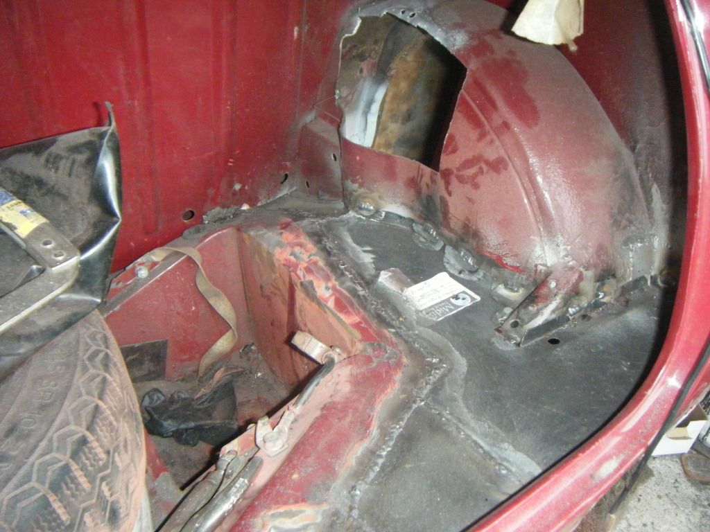

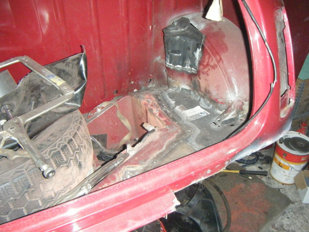

So after that i cut out the R/H side of the boot floor again i am going to be using patten coner panel hopefully put it in tomorrow
,while i was there ,i noticed some rust bubbles
Then i cut them out made a bottom piece and welded it in
Moving along , any comments welcome good, bad or other wise

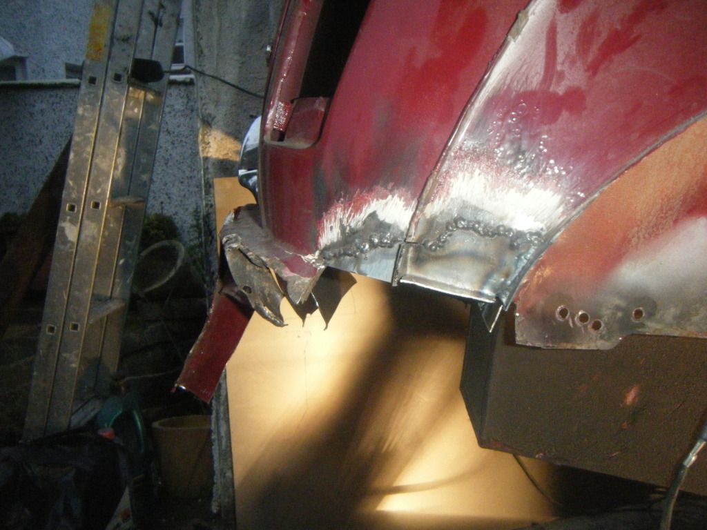

Hi got some more work done today on the auto the boot floor coner and also the upper part of the wheel arch
Moving along
cherrs for looking

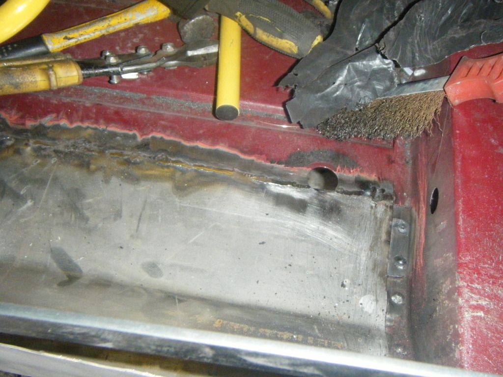

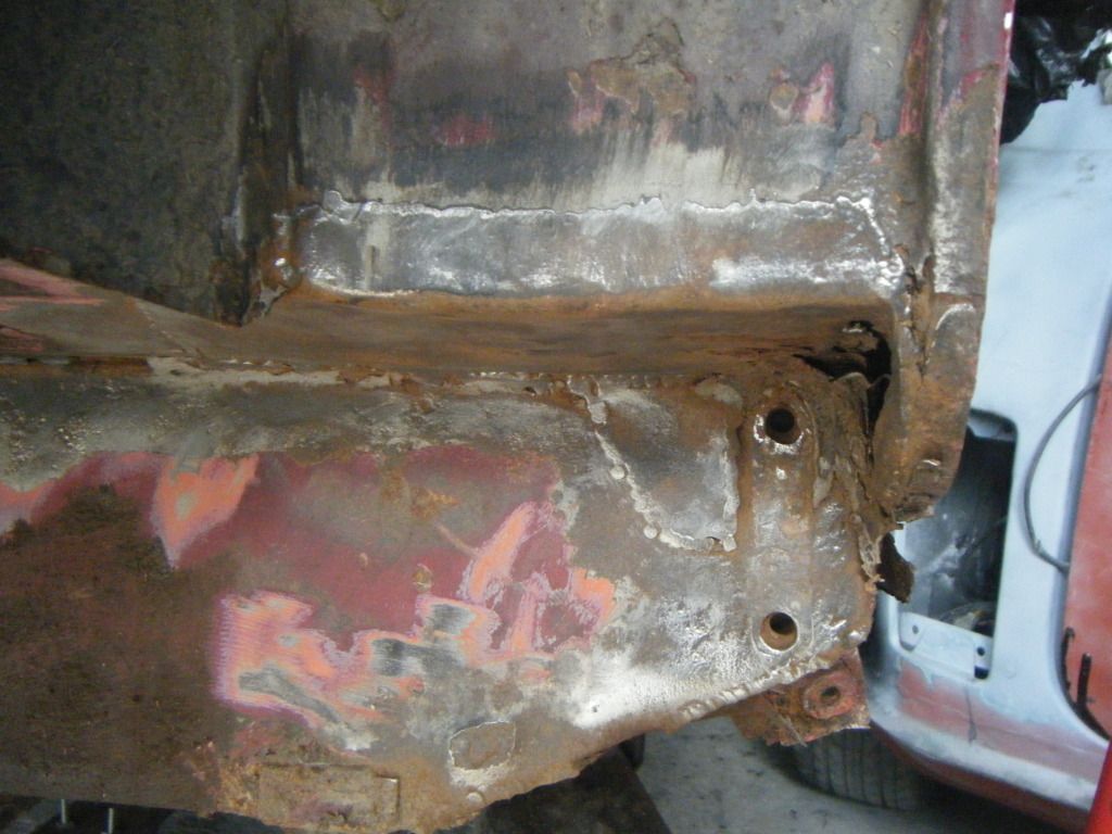

Hi all got some more done today on the auto first was the drivers floor ,i cut it out during the week
someone had plated it in the past and i guess never painted over it
so then welded in a new cut off
Then i moved on to the fitch panel and again it was plated over
so now i have the fitch in place
Thanks for looking

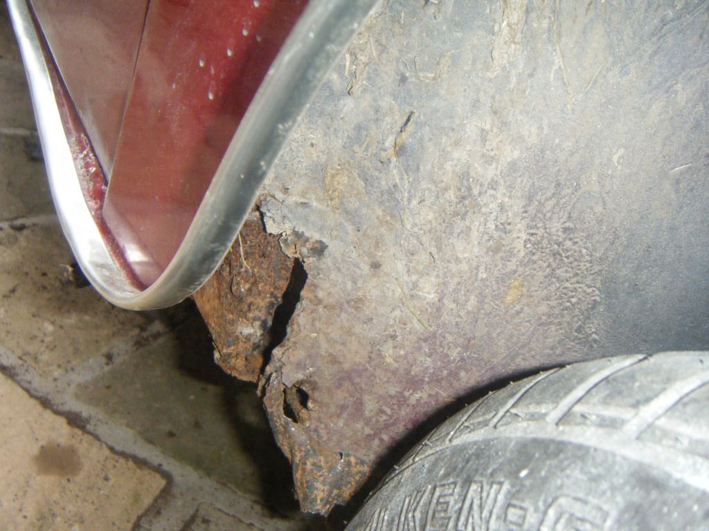

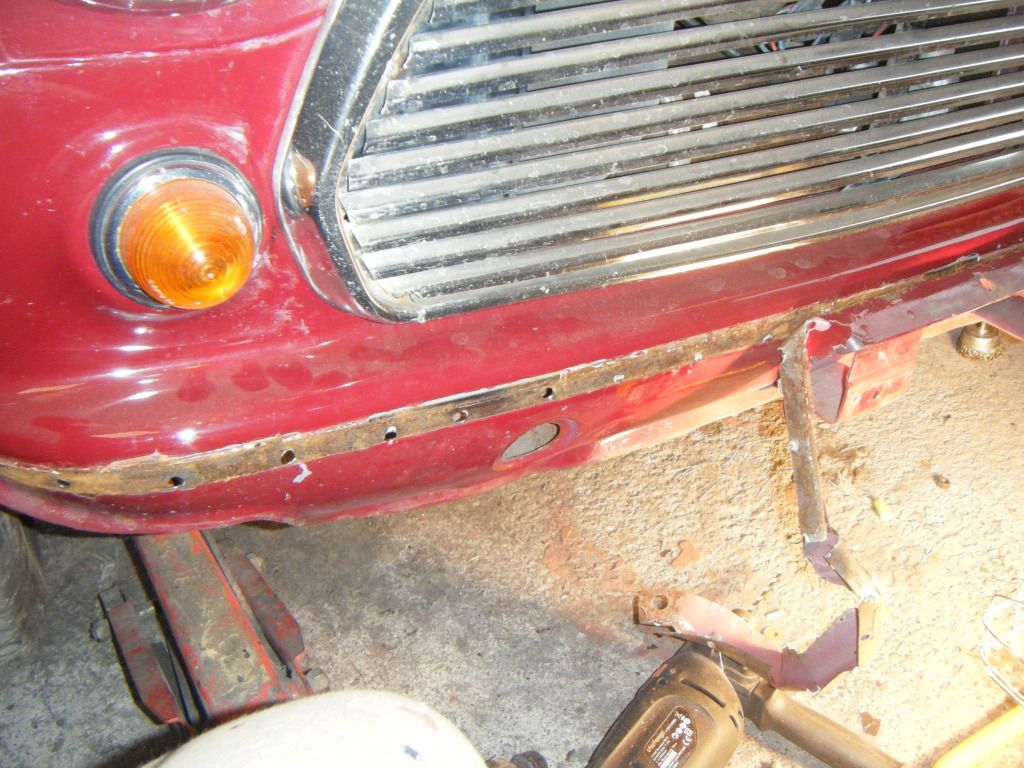

Hi all went out today to do a bit and i ran out of g >_<

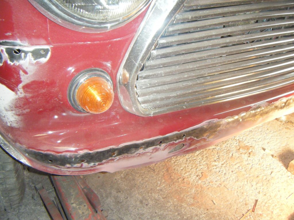

so i decided to de bumper the front by removing the lip by drilling out the spot welds

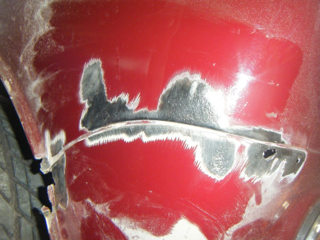

while there i noticed some bubbling on the wings
there is some pitted steel
should i cut this out and weld in a new plate??
cherrs for looking
Any advise would be great
