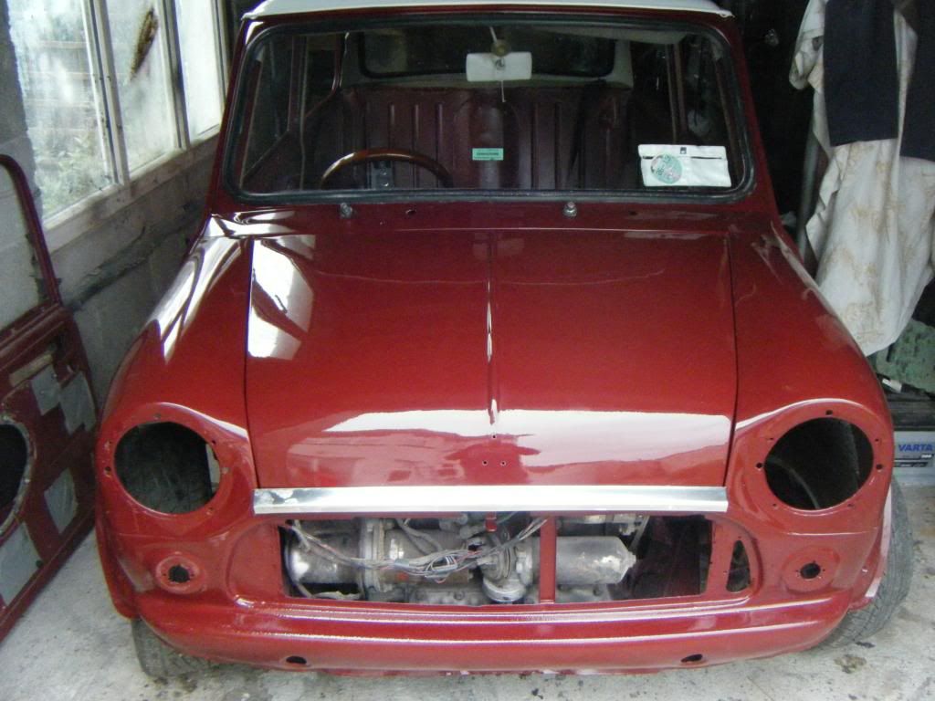

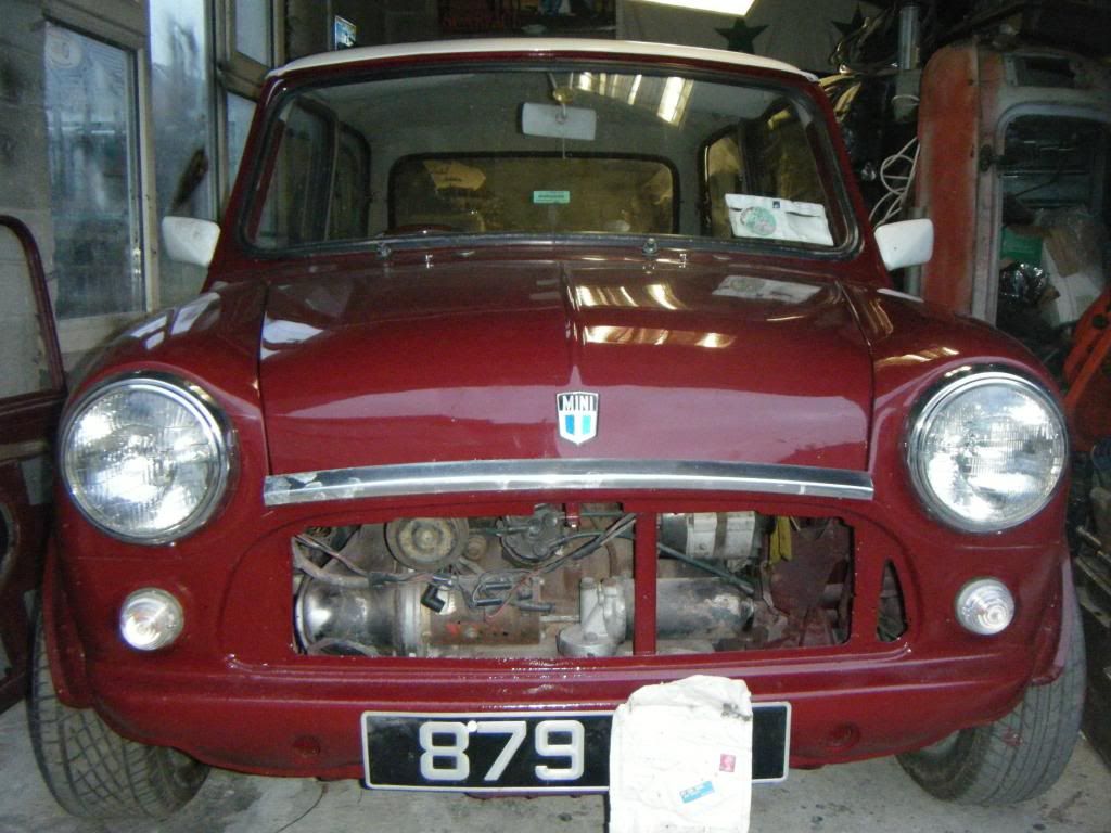

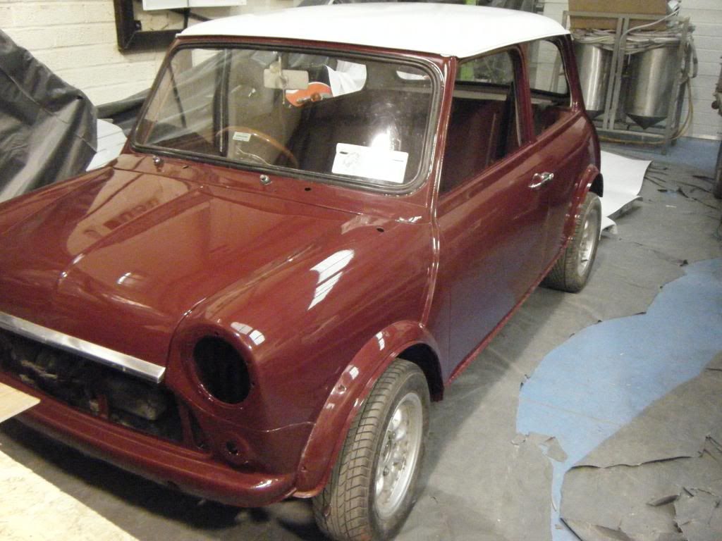

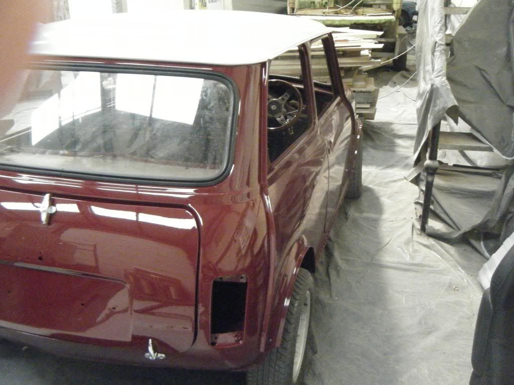

Hi all, went to look at the auto today and sadly its nt painted yet........so hopefully next week.
I am going with Damask red the colour that was on the car first day and also after much thinking
the roof is going to be red and not white , also a set of group 2 arches in black
so here a couple of photos

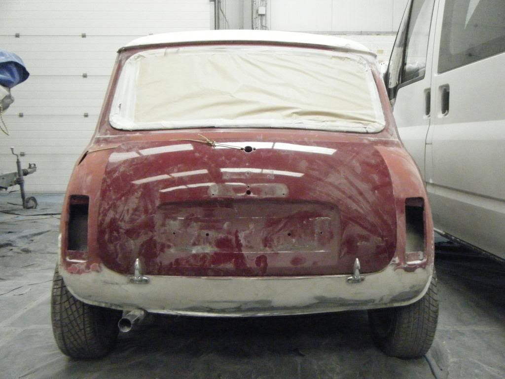

also a photo of the rear
love the debumpered look
Thanks for looking any comments welcome
Dave

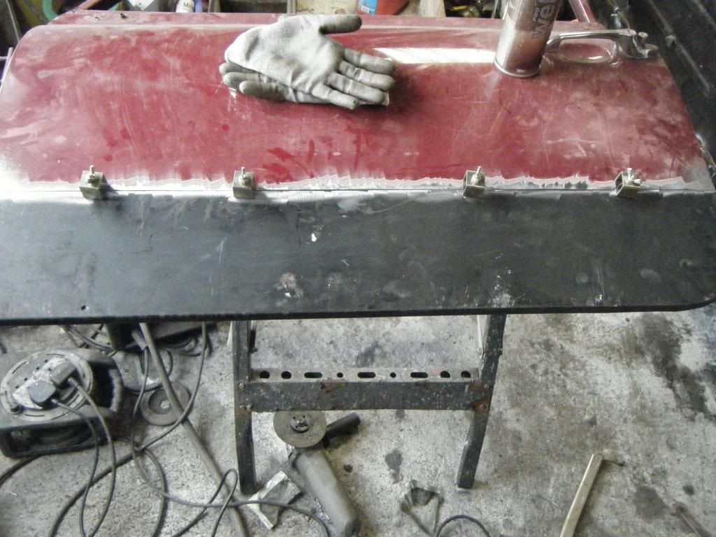

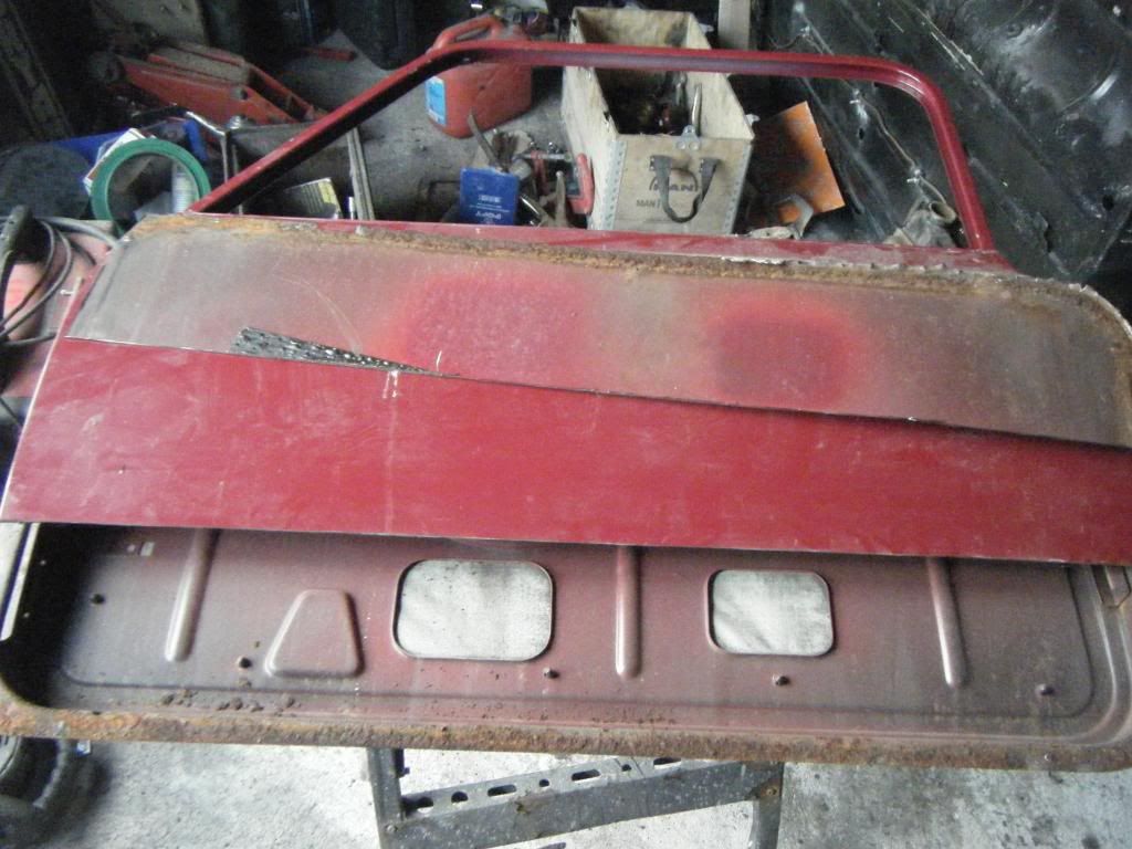

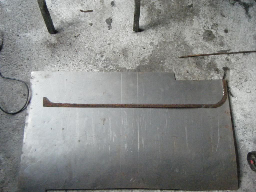

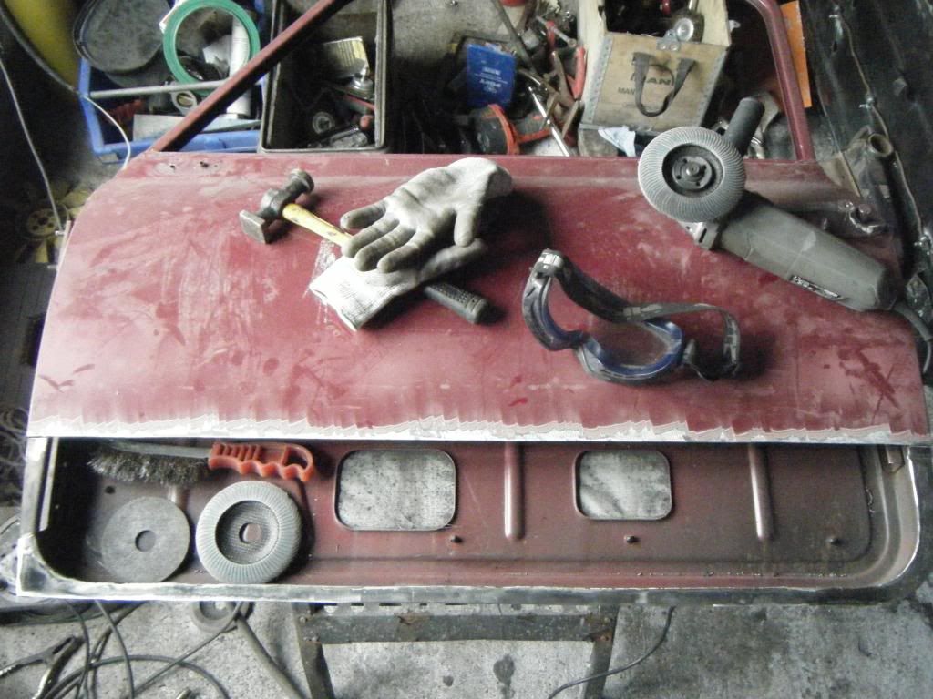

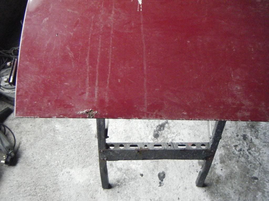

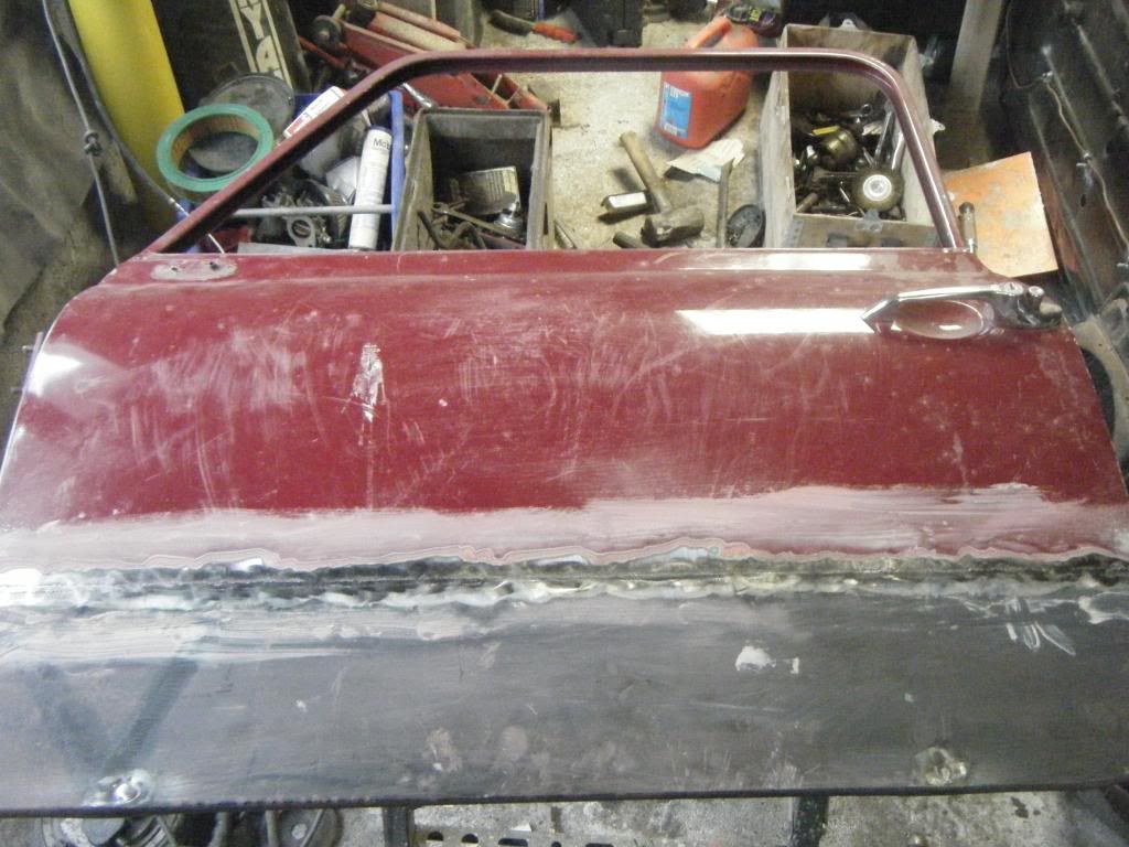

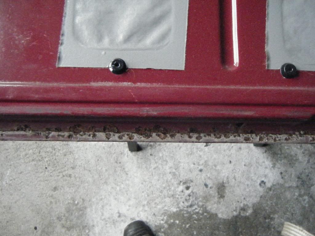

A bit of a update with the car at the painters i have two spare doors that needed a bottom repair
So i started cutting and good old rust
Cut out the bottom flange made a new one and welded it in
Then tack in place and i used some cold front, and seam welded in place
Thanks for looking
Dave

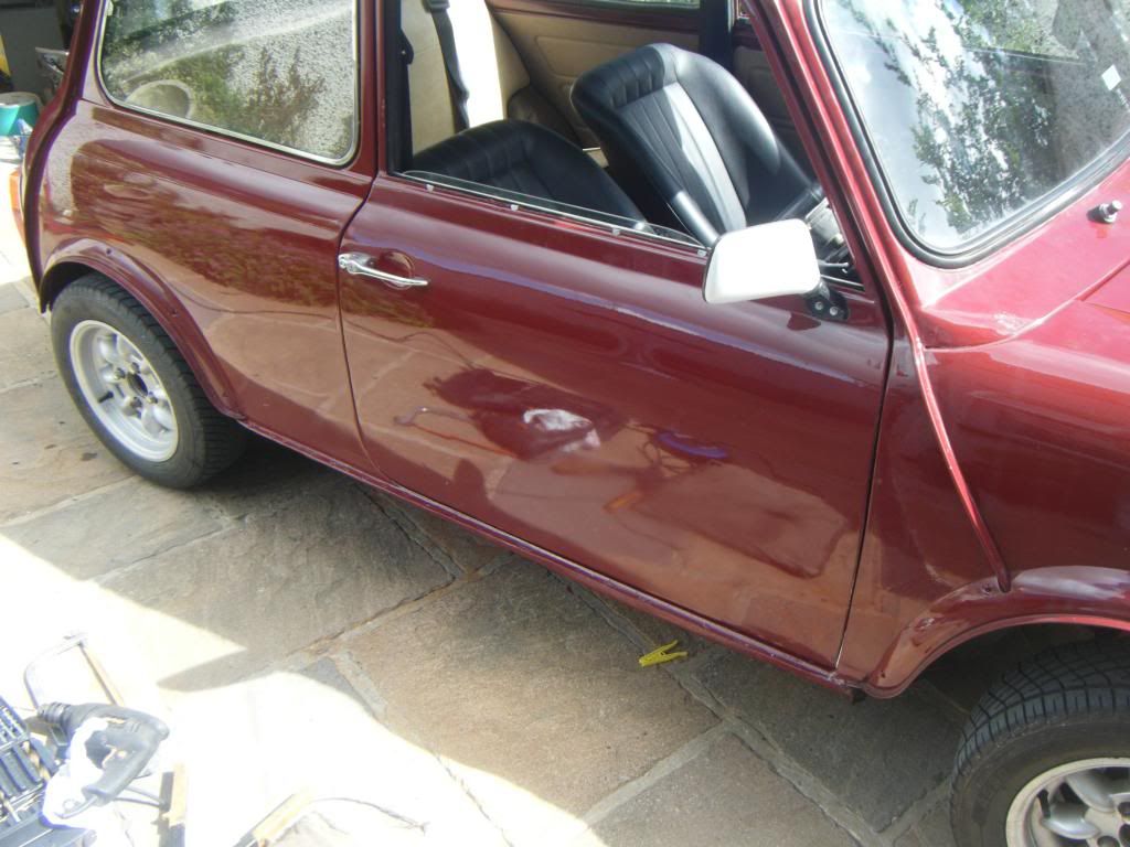

Posted 22 April 2013 - 01:04 PM
Hi all,

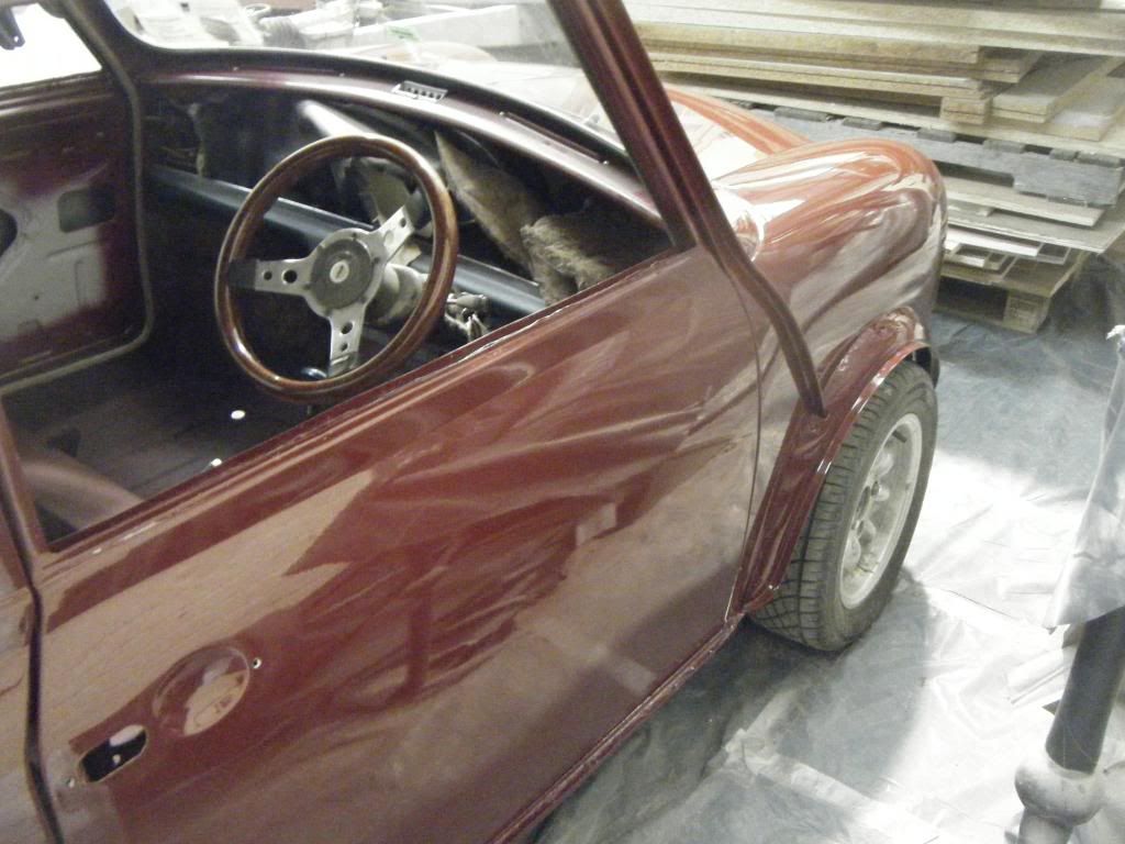

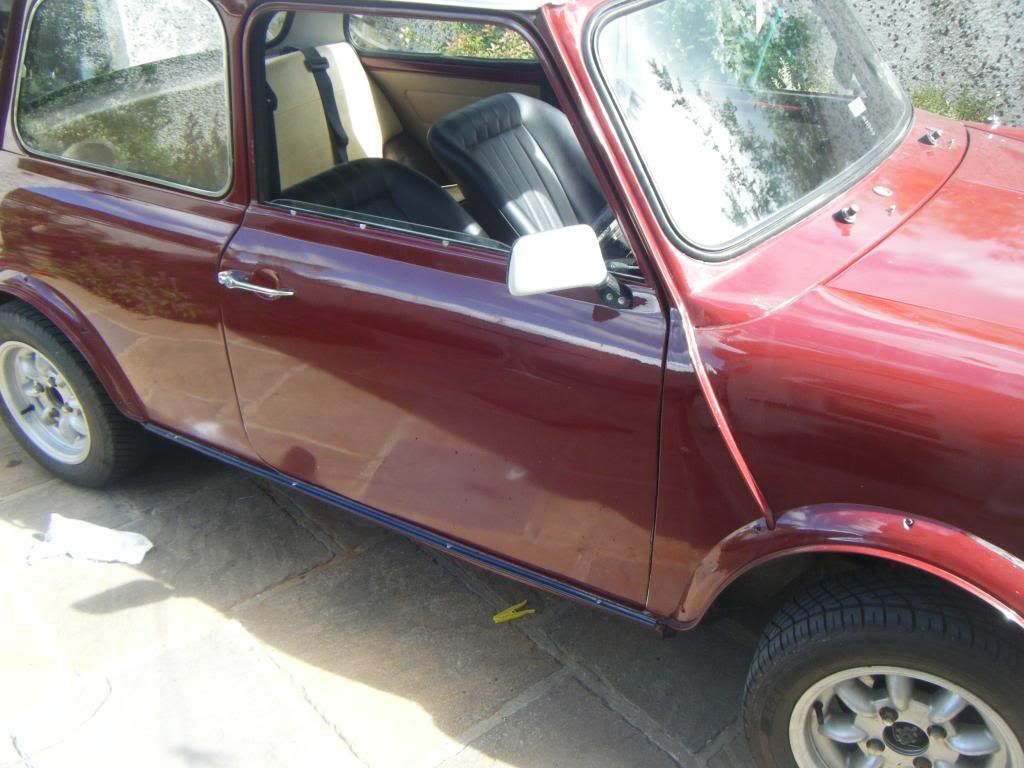

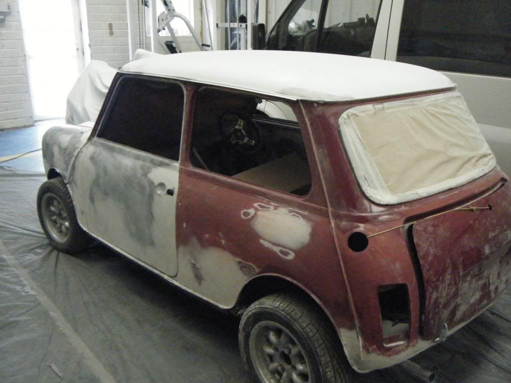

A bit of a up date the auto is now painted :highfive:
So here it is ,think its lovely so over the next few weeks be putting it back together keep ye posted.
Dave

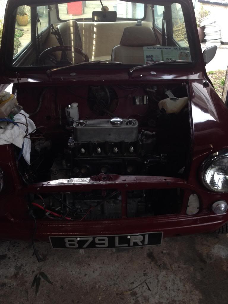

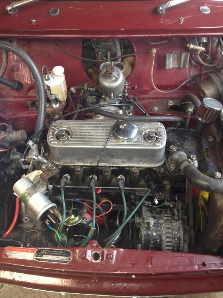

Well a bit of a up date,i had a few hours free today  so i put the head lights on ,door mirrors .
i also had a bit of a problem with the engine, i was getting a metal to metal sound when it was running so i started to have
a look around , in the end i took of the rocker cover i noticed the rockers where getting no oil.
When i put a bit of oil on the noise went, so took off the rockers and notice that there was no oil hole on the rocker
gear to allow oil to get to same (really weird)
So onwards and upwards ..........

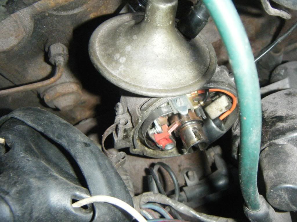

to move up the ladder  so hopefully :gimme:  anyways I had token the car out for a spin yesterday and while heading for home
the car just stopped running  so I had to get the car towed back home with a friend of mine

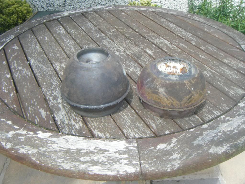

so when I got it back we were getting no spark so I took off the dizzy cap and saw this
so I havnet decided to get new point or get a whole new dizzy as I heared that the dizzy in auto isn't really great and be better off with a dizzy from a manuall

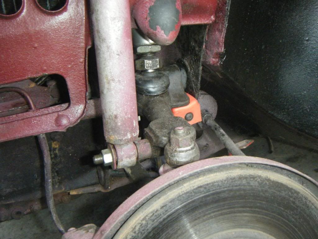

today I fitted my new cones well one of them with hi low on the front passenger side just look at the old one to the new one
SO here it in with hilos and new red buffer
Thanks for looking

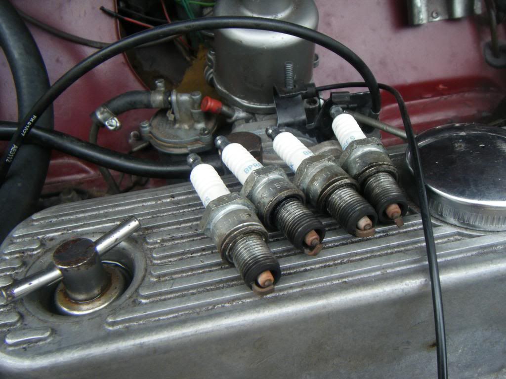

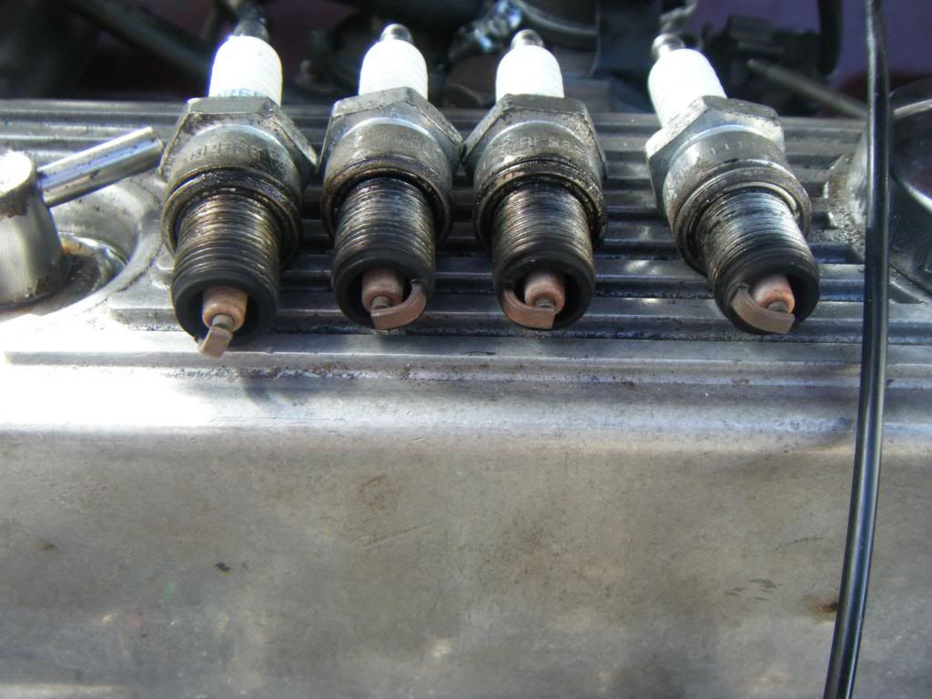

Its been awhile  but I am tuning the engine these day from help with member Jaydee,
I have a stage 1 kit stage 2 head electronic dizzy car is going well now
Here is a few photos of the spark plugs that how I was tuning .....no rolling road just adjusting timing and carb mixture
After all how did they do it years ago ?
Thanks for looking

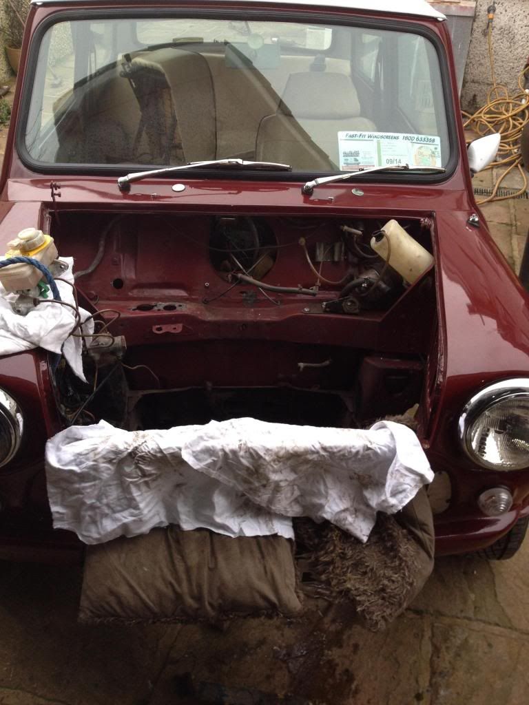

Hi all,
Thanks Neil I think I will just leave it alone...
I have been driving the auto for about six months all going well....

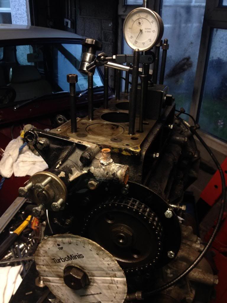

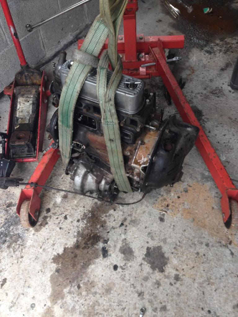

but I have a manual 998 which I rebuild a year ago along with the gearbox and diff which I changed to 3.44  to go in a different car but it never happened :ohno:
The auto was just changing gears very fast but as soon as it got up to top gear it was good fun...but I needed a change
I put new bearings, rings, flat top pistons , sw5 cam , lightened flywheel ,stage 3 head , and a dizzy from aldon in the manual
so it should have a good bit of poke
so out with the old and in with the new ya!!
oh no no engine!!
Auto out
right time to time in the SW5 with DTI and protractor and so help from members on here..Thanks :highfive:
manual in...
so I got up real early this morning to get things done
so it was in with pedal box , clutch master cylinder, slave cylinder, gear linkage , exhaust system RC40, Rad , etc etc
I think tomorrow I will try and turn the engine over see what happens :ohno:
Thanks for looking Dave

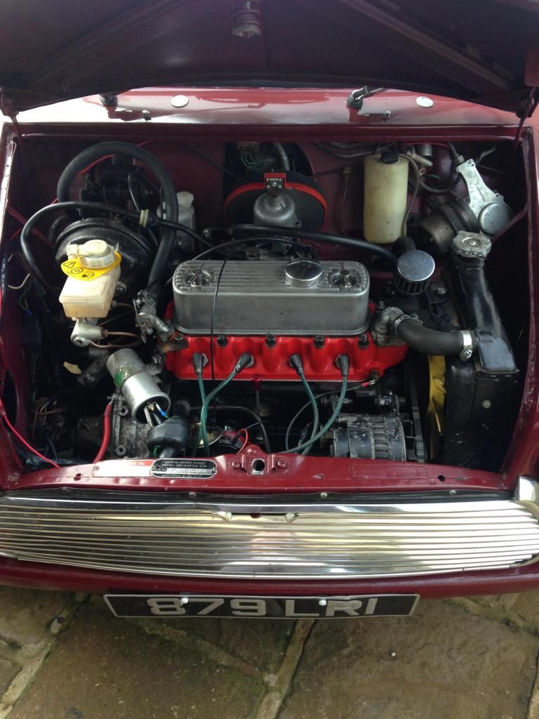

Its been nearly a year now so I think I will do a bit of an update
I finished off the 998 engine and fitted it to the auto its going really well but I have  a MG metro unit to go in
The 998 has now got a 12g295 head and also lovely sounding MED stub stack
