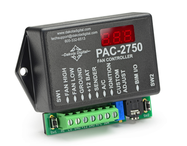

Radiator took 2l of water to fill back up so pulled it outside for further inspection. That's when I noticed I had turned the fan thermostat right up so the fan wouldn't keep cutting in whilst setting the timing, the engine must have over heated a bit, pressure built up in the cooling system and caused a pin hole leak in the bottom of the rad.
So, I've ordered some radiator seal from Wurth as I read it's the best of a bad/bodge situation until I can get the radiator out to be re-cored as it's probable that it's the original still.
I've also noticed the odd drip from the top hose too where the temp. probe for the thermostat is inserted. It's never really sealed properly since I've fitted it.
So, looking about on ebay, one of the expansion modules for my gauges is a 70Ah fan controller, it takes it's info direct from the main control module for the gauges direct from the water temp. sender.
That should hopefully be here in the next couple of weeks.
