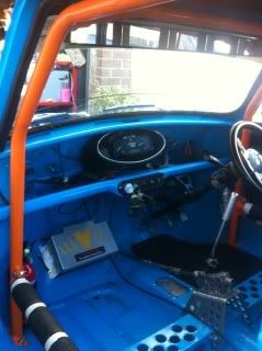

Posted 11 January 2013 - 10:04 PM
Here's how mines done
I notice everyone is mounting them back of the original - is that comfy ? or is it to compensate for the change in angle ?
I was thinking of mounting on the tunnel at the same angle - but may cause too much of a change in angle ?
