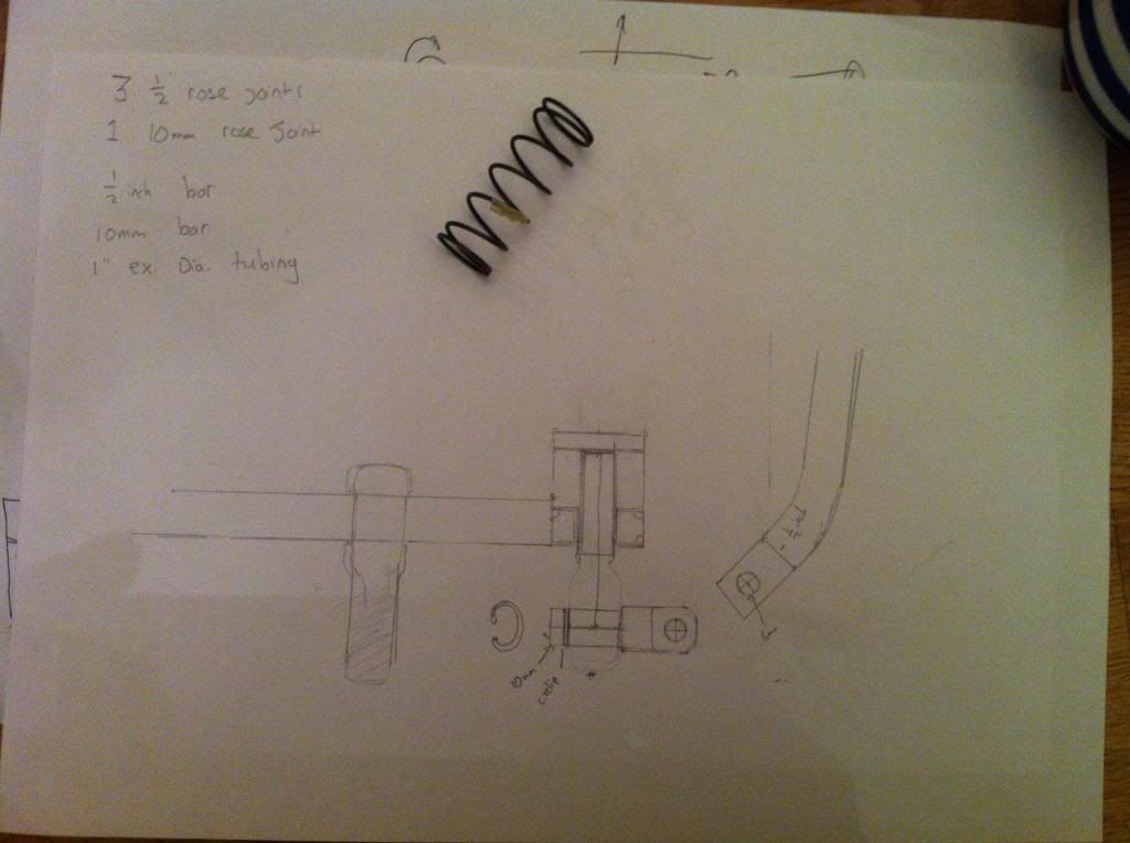

the plot thickens! drawn up, some modifications done and i have a parts list for the mornin' :D need to use a lathe for this so im gonna have to use a mates.. really need my own!
havnt included any form of bracing or mounting but thats the easy part!
the use of a complicated rose mounting for the gear change is because it needs to slide to account for the transformation from a side to side movement in the rod to a rotational movement. im using a rocker spacer spring as a sort of helper spring and a center return. if it didnt have this it would be sloppy..
edit: damn, no idea how to rotate, can anyone help? XD
Edited by Artful Dodger, 13 January 2013 - 07:02 PM.

Posted 13 January 2013 - 07:09 PM
you'll just have to twist the gear nob as your changing :lol:
#42 Artful Dodger
Artful Dodger
    " I AM THE SPECIAL ONE"
  • 4,435 posts
Posted 13 January 2013 - 07:10 PM
why? :shades:
