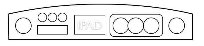

i would like to see a dash that i can fit a weber box behind. so no glove box. angled gauges. oh and definitely a cup holder
I would have thought a Webber box would fit behind any after market dashboard? Or do they intrude into the cabin that much?
Andy @ Optimise Automotive
Email: contact@optimise-automotive.com
Phone: +44 (0) 1782 579 080
Ya unfortunatly on a sports pack the radio and 3 clocks dont allow for a box. im not a fan of centre consoles so i would like to ditch the glove box (mainly because it rattles too much) and move the 3 clocks left with the radio
and if im feeling generous install an Ipad mini in the centre as its slim

Good evening,
That dash layout wouldn't work unfortunately.
There simply isn't enough space at the sides of the dash to mount a CD player, as the air vents and air pipes for the windscreen vents (mounted in the top dash rail) get in the way.
Its certainly something that we could look into as a custom option and we could have a look to see if a CD player would fit there is you removed the air vent and air pipe - which would obviously mean demisting your windscreen would be a nightmare.
We will have a section on the website for custom layouts and if they are simply a change in layout using one of our existing dashboard templates they will be an additional £10.
Also, I best point out that due to the height of a dashboard (for top padded dash rail fitted) I don't think you would be able to fit the three 52mm clocks above the CD player if it was located at the side (they only just fit in the middle).
