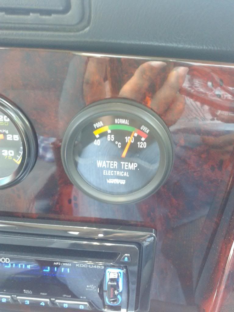

i used my standard meter and it goes slightly pass 3/4 and to be sure i used another temp gauge with its own sender unit and got a temp reading of almost 90+ but stays there..
91 deg stat?

thanks for the reply.. yeah with the air cond on it gets hotter the faster i drive.. if its off it stays till half.. my country on a hot day can get up to bout 35 degrees Celsius.. but most other mini owners here dont have that problem.. also ive done 600kms since the rebuild.. and the thermostat when i bought it i sorta boiled it in water and put a thermostat in and the temp it opens up is around 87-88 degrees.. this is the current temp.. picture below..
this is my second gauge reading the same as my original gauge
