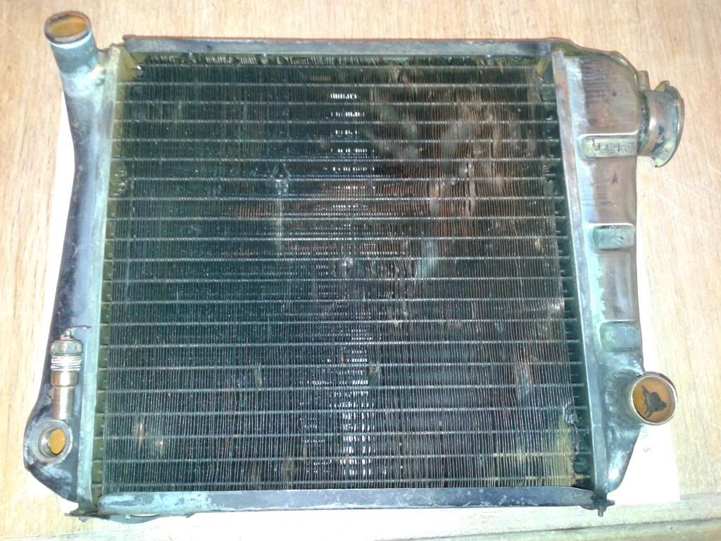

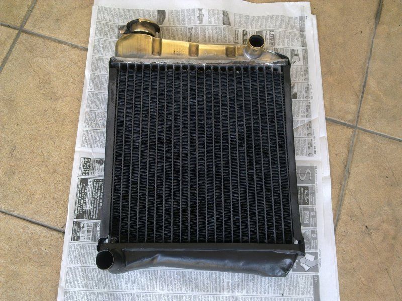

heres some updates.. i found my old 2 and a half core rad and compared the fins to my current 3 core rad.. heres some pics.. a lot of difference
this is my current radiator the 3 core one
this is the old original 2 and a half core.. the fins are totally different.. one is the old style and one is the new type..
im going to try the 2 and a half core and see if its any better than my current one.. fingers crossed.. but if it isnt then i guess as a final result of being not able to find the cause of the problem i might have to save up for an aluminum radiator.. a standard stage one engine on aluminum rad...lol

Hi daenish. i am betting that the old radiator will run cooler - those fins look nice and dense to me (hopefully the squashed ones aren't too bad) but the honeycomb style of your new one does make it hard to compare

Yeah I agree with you observation mate and I have fitted the old radiator and hopefully I'll see some difference tomorrow in the temperature when I take it for a test drive.. Wish me luck.. Will keep you guys updated

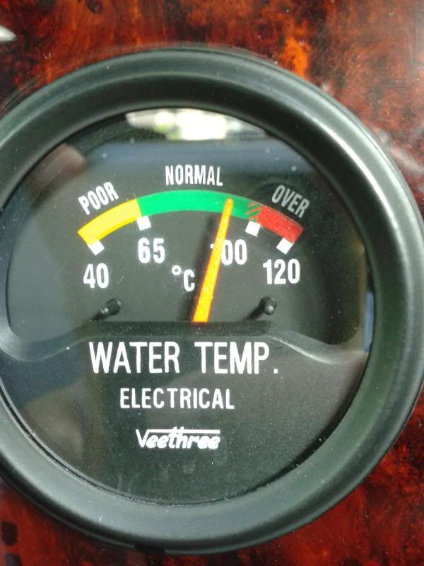

hey guys thanks for waiting.. so it was raining really heavy this afternoon so had no choice but to test the car at night.. temperature outside currently is 27 degrees celcius.. so took it out to the highway with air cond off and blasted it for about 5 kms at 100- 120km/h which is about 60-75 mph... then exited the highway and immediately switched the AC on speed 2 so compressor was on continuously for about 5 minutes i was driving bout 60-70kms and then stopped at the side of the road for another 5 minutes to simulate a jam situation and then drove back home.. below i have the temperature readings from the head and from the bottom of the radiator..
this is the temp from the head/block
this is from the bottom of the radiator after it has cooled..
im not too sure if this is good but its slightly better than the old radiator.. next up i have to do the test when its the hottest in the afternoon to see if the temperature holds..

it looks ok, however as you say it has to be tested in the heat of the day.

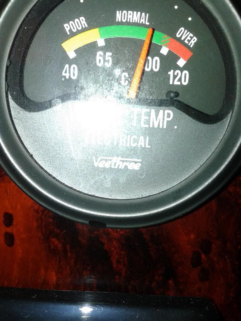

Okay i have good news guys.. i took the car out for a drive with the air cond on speed 2 and temperature outside bout 33 degrees celcius and got these temperature readings..
this is head temp
radiator temp..
i think its good.. well good enough i suppose.. would like to thank everyone who helped and thanks for being patient i really appreciate it.. also hope that through this topic, people from hotter climates can use this as a guide to troubleshoot their problems.. wish i was in the uk would take you guys out for some steaks and beers :) cheers
