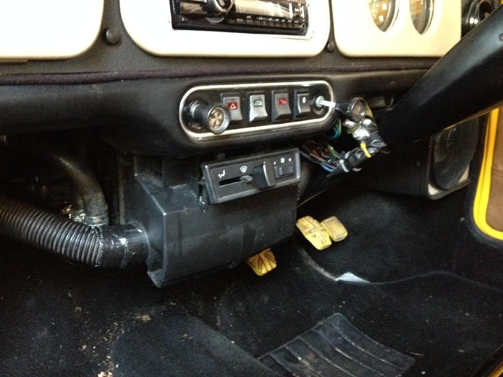

OKAY! finally got the heater all plumbed up and fixed into position. Still need to source bigger bore ducting for the windscreen, these ones dont really fit on, hence the duct tape =) massively improved though and actually clears the windscreen. Next for the interior is to change the dash, change the door cards to black, change the headlining to black, pop a cage in there and that'll be that =)

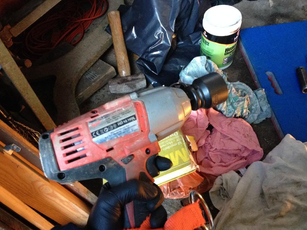

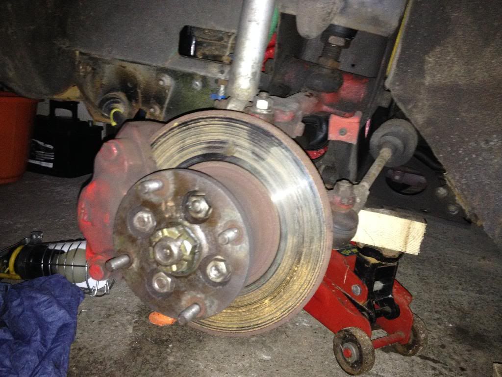

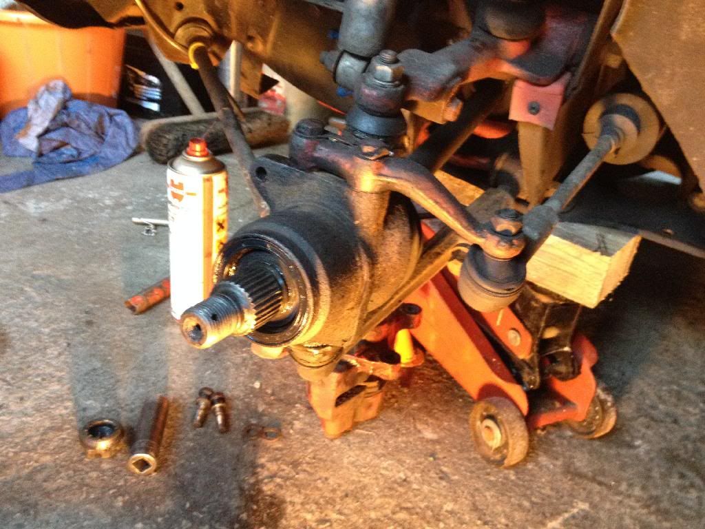

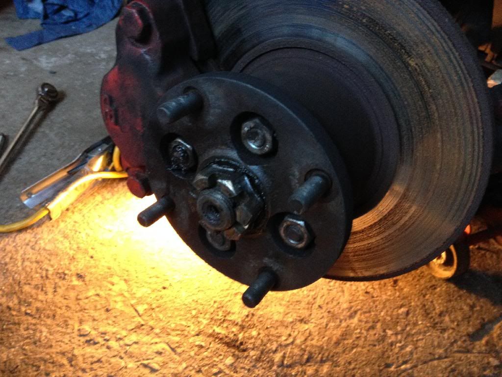

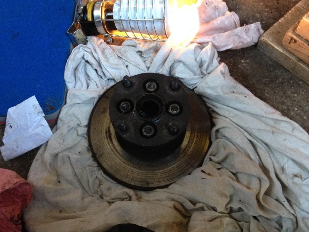

So, we decided to start the brake conversion. Not a bad little job in the end. Just struggled with the hub nut. An absolute ball ache to release.
ACFB3E78-F03D-4439-A8B1-8EA4814504AB_zps
9AADBB6C-D09B-4DF7-86A4-A3C06E5F38D2_zps
After much annoyance and many brews...we were ready to sack it off but i tried my wizzy gun from work, worked a treat! Buzzed it straight off, so the build was back on!

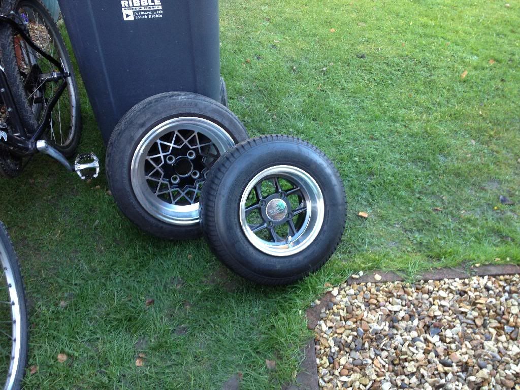

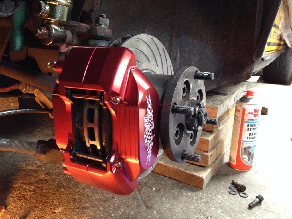

Picture of the new 10's that will be going on =)
B4B7EA12-5232-4422-803D-430AAE296054_zps

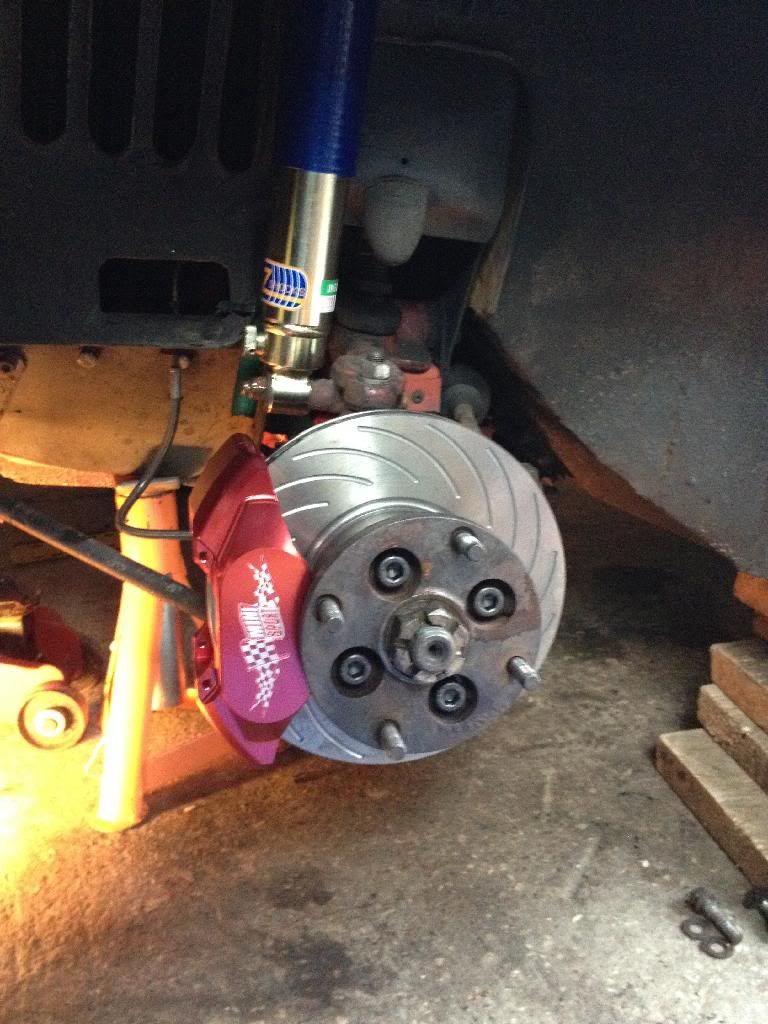

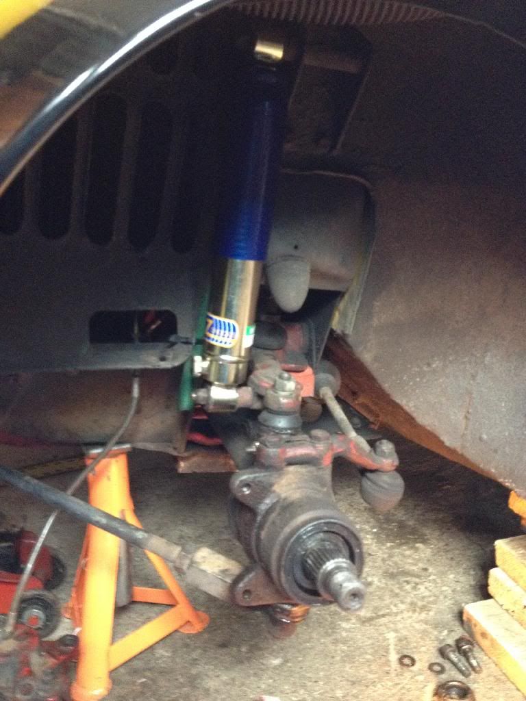

When everything was removed we then decided to pop the new GAZ shock in place, again as the mini has been looked after it wasnt the hardest job in the world =)
44E49E60-1703-44DA-BF30-2D6CB170B6D2_zps
Then, it was a case of bolting everything back into place. The kit is great because you get new nuts and bolts, and everything fits in the same holes, so theres no modding needed. Once the caliper was in place then the pads slipped straight in =)
3B3517F5-E1A4-4607-92C5-43F2AFDF2B93_zps
5D925B46-55D0-457E-8994-EBF62970BD91_zps
The suspension will be setup by my friend next week, as the geometry will have changed slightly.

Bit of an update...this is what she looks like now with the new 10 inch wheels on. Handles brilliantly now and with the new brakes stops properly too!

Posted 29 December 2013 - 06:21 PM
Your discs are technically on the wrong sides, but it won't cause you any real issues.
Looks really nice now though! You've done a good job
#22 Midas Mk1
Midas Mk1
  • 5,787 posts
  • Location: Manchester
  • Local Club: S.U.N.M.C
Posted 29 December 2013 - 06:24 PM
The discs are on the correct way!
Looking Good!
#23 benjy_18
benjy_18
  • 1,038 posts
  • Local Club: LSMOC
Posted 29 December 2013 - 06:56 PM
The grooves should be facing the opposite way, makes no difference on mini brakes as the vents are straight and don't follow the grooves.
For future reference the vents should always allow air to be drawn out, so the vents should effectively face backwards. Buy as I said above, the vents on mini brakes are machine straight so realistically makes no difference either way around

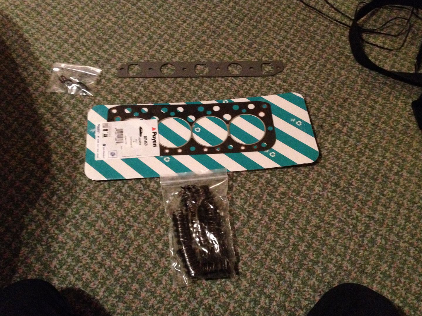

Okay, after a while of being annoyed and pissed off with the performance of the mini, i decided to get something sorted, behold...the HIF44 carb!
We removed the twin 1 1/4 inch carbs and actually the manifold cracked on removal, probably giving me a nasty air leak...causing poor performance.
I also bought a set of 1.5 roller tip rockers, a turbo head gasket and a new manifold gasket. And also bought the uprated valve springs
53AECC50-A38B-4EA6-98DD-6421A39CE613_zps

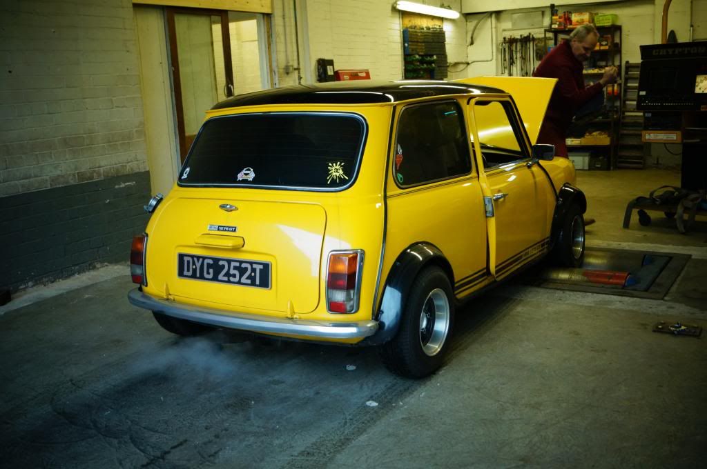

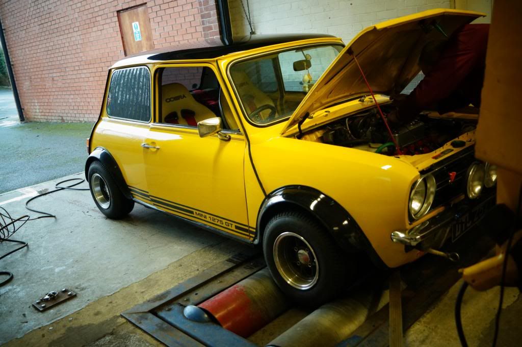

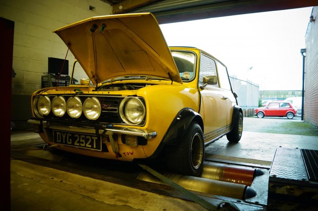

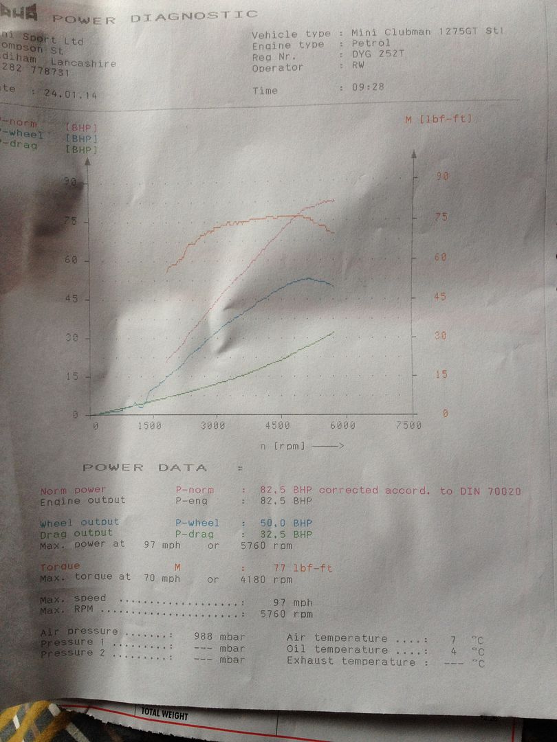

Once everything was fitted and setup...it ran pretty well. But I still wasnt very happy. So I booked it in for a rolling road session at MiniSport. Here, Rob sorted it out. Filed the profile on the needle slightly, disconnected the vac, adjusted the timing and had a bit of a fettle about.
We also did a power run and it produced some great results!
And heres a video =)

Posted 29 January 2014 - 09:15 PM
A36FB982-3924-4222-91D5-1EE361982B41_zps
And heres the graph!
Producing 82bhp and 77ft/lb torque. Not bad for a relatively standard engine =)
