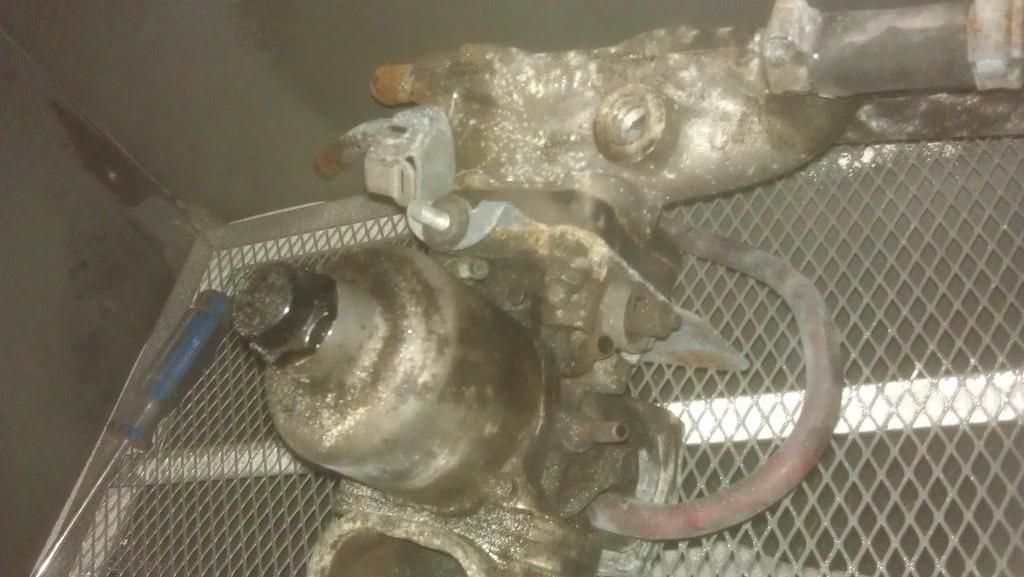

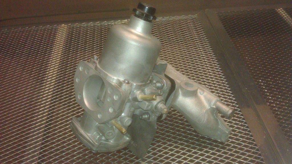

just get them blasted, dishwasher tablets, solvol, brasso etc will just waste your time.

That's ok as long as you make sure to get ALL the media out after. The last thing you want is any of the common sandblasting grits etc going into your engine. It also leaves a dull finish in my experience that takes as long if not longer to get to a mirror finish than scotchbrite and wd40/ autosol so you end up saving no time at all. Also you need to budget for the cost a new gasket set for the inevitable strip to clean it out. Does work well though if you only want the clean look rather than polished and were planning a rebuild anyway.

ooooh that blasted carb DOES look nice.
it's not hard to get all the media out and seriously, scotch pad and autosol quicker to polish with??  i'll dig a dashpot out over the next couple of days and spend about 5 minutes polishing it and post a pic of it for you ;-)

normally use either bead or garnet, just depends on what i'm using in what cabinet at the time.
generally blast then if there are no casting marks/rough spots etc use a 400 on an expander wheel, 600/800 paper then onto polishing. grey on a sisal, then light green on a stitched mop, blue on a coolair and then pink, white etc.
