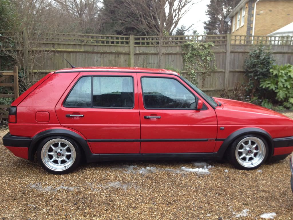

I love mk2's !!!!!! Wish I never sold mine I sold it start of this year :(
Here's my old one :(
