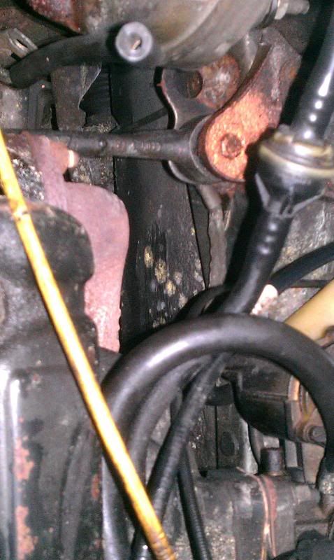

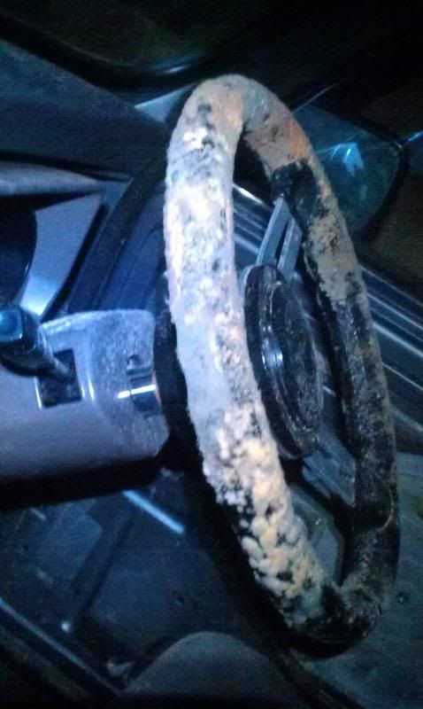

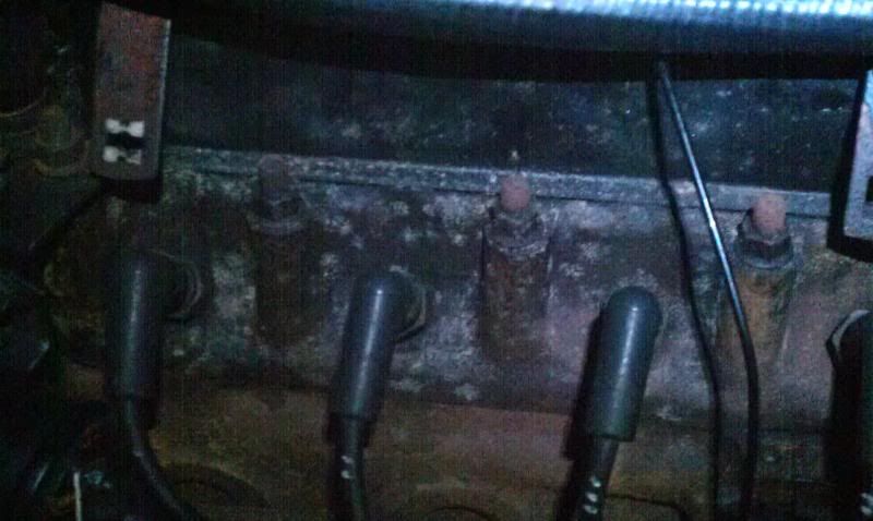

UPDATE!
Thought you lot would enjoy seeing this nightmare unfold further. I washed down a load of bits with antibacterial wipes after it all happened and whatnot taking the damaged bits out. But after a few weeks, this horror emerge.
Spores in the air have gone nuts and ruined anything non-metal.
Even the sump, underside and engine block have gone furry. It's unreal. And this is just the spores in the air and whatever wasn't cleaned from the backsplash. The more I clean it up, the faster it grows back.
I am gutted.
Engine
Engine bay

Steering Wheel

This is the problem I knew would come, a quick scrub up would make it look fine instantly, but the untold long term damage is now beginning to blossom. I've sent an update on my report to the council. The door insides are also nice and fluffy.
I've got a car that is effectively toxic, and is embedded with spores from actual turd and wee.
Nobody will buy this if I resold it and knew, and it actually needs fully stripping, cleaning, respraying and whatnot before being safe and usable.
Lucky I wanted to do that anyway, but if I don't do it this winter it's going to die entirely.

That's perfectly normal on a car that's been in a damp atmosphere. It would have happened if the water that flooded the garage was clean and quite probably even without the flooding incident (although that might have contributed by getting the interior wet). Clean it off and DRY it and it won't come back. I really do mean dry it - wiping it over with a dry cloth is not going to do it and at this time of year air drying outside or in a normal garage is a loser from the word go. You need to get the moisture out of the car so seats and carpets need to come out and go home with you - wash them properly and keep them in the house where it's relatively warm (if your heating is on even better). Metal parts will get condensation but so long as they are not bare metal it's just a wash off to get rid of whatever grows. In the engine bay wipe over what you can get at and then when you start using it the heat and fumes will soon get rid of everything else.

As above, I'd be inclined to think that was more to do with the damp atmosphere, than what it's all been contamaminated with. In my youth I once lived in a damp flat where everything went like that, I opened my wardrobe one morning to see that all my clothes had grown a coating of green/grey fur and looked much like your steering wheel does.
If it were me, I'd thoroughly treat everything with a anti mould/fungal treatment like "de.solv.it" or similar, and then hire a dehumidifier and run that constantly in there for a few days until everything has fully dried out.

Took all fabric out, dettol rinsed everything furry and am gonna set the dehumidifier on all weekend. Fingers crossed.
