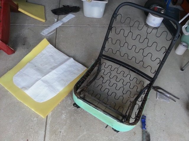

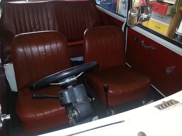

I got into the seats and door trims and happy how things turned out.... I took the seats down and re-did the foam and fixed some of the springs. The cover was still good so just gave them a clean and all went back together good...
I made some new door cards and again. put the original cover back on...

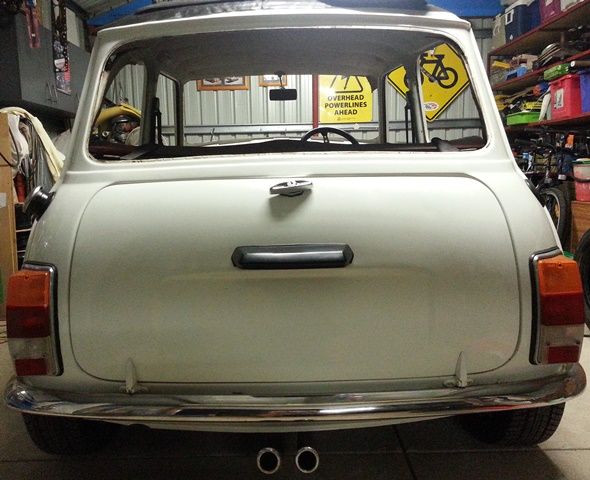

The front and rear screens are in... I had a crack at it myself and it wasn't that difficult so glad I did...

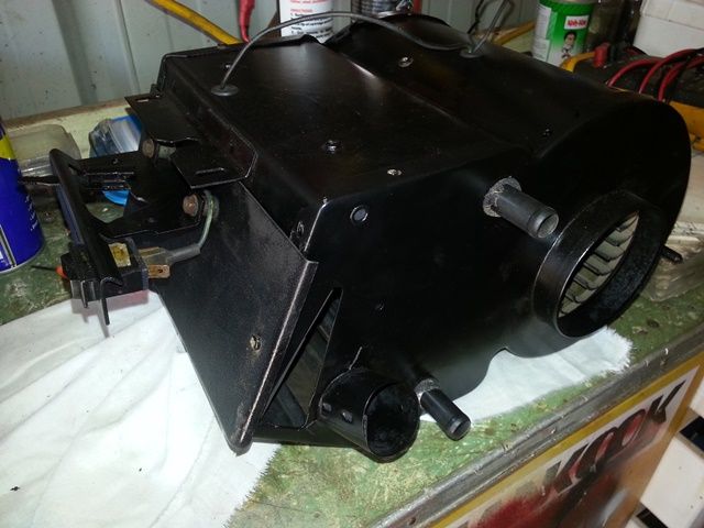

Well... I have finally fitted the heater as it took a while to get all the bits... its all in and plumbed...

I re-foamed my other seats also so fresh foam all round with the original covers which are in ok shaps...
