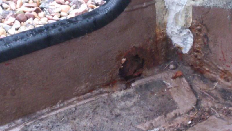

Posted 16 September 2013 - 01:02 AM
Nothing too bad, just rusty inner sills. I knew they were scabby, but there are big holes. Cant copy pictures on my phone, will do it on the pc in the morning.

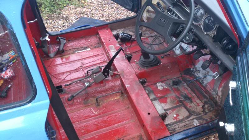

Posted 16 September 2013 - 06:28 AM
Drivers side sill and doorstep panels.
Drivers inner sill
Passenger inner sill
Overall of floorpan

Posted 16 September 2013 - 01:51 PM
Hmmm. Just chopped out the inner sill on one side. The doorstep fell out at the same time because it was filler. It was held to the outer sill by ONE spot weld. But. It's a cover sill, with the original sill underneath!!! Or at least, what's left of it. So, hammering, brushing, chiselling etc. Most of it is out now, ready for a Hoover once the sludge is dry. Just taking a break to stop the flow of blood from my freshly sliced knuckle. To the bone, bloody cover sills.....

Posted 16 September 2013 - 04:10 PM
That whole side is now chopped, cleaned and prepped. I also chopped out the lower part of the rear quarter. Underneath that, I also found the remains of the rest of the old sill, which is now cleaned out as best as possible. All the remaining steel has been cleaned and coated with rust killer. Ready for a quick clean to bright steel with the grinder, then welding new bits on. I did find a 5/16" spanner which had been left inside the old sill when it was covered over! Free spanner!
