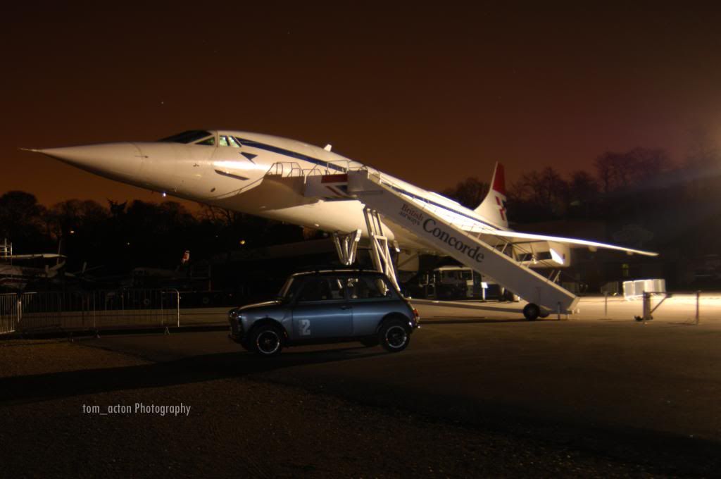

Forget any thoughts though if its metallic as you don't stand a chance...
you can roller metallics, just its 1000 times harder.
2185379382_24dd068777_z.jpg?zz=1
