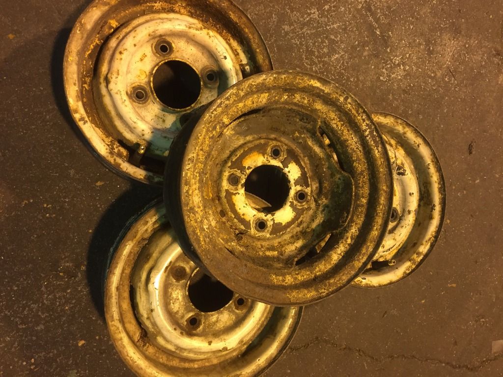

I think these wheels are going to be a bit of a challenge :-(

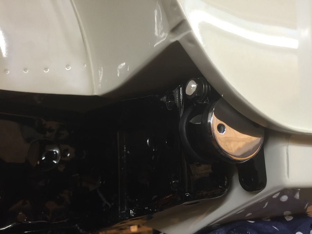

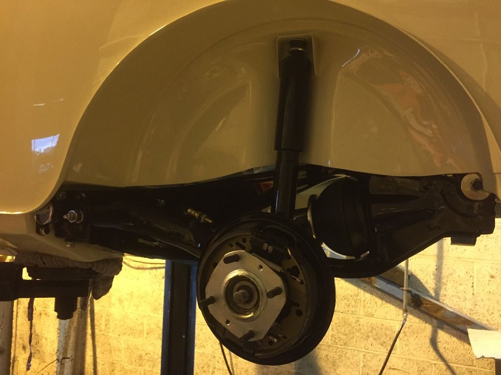

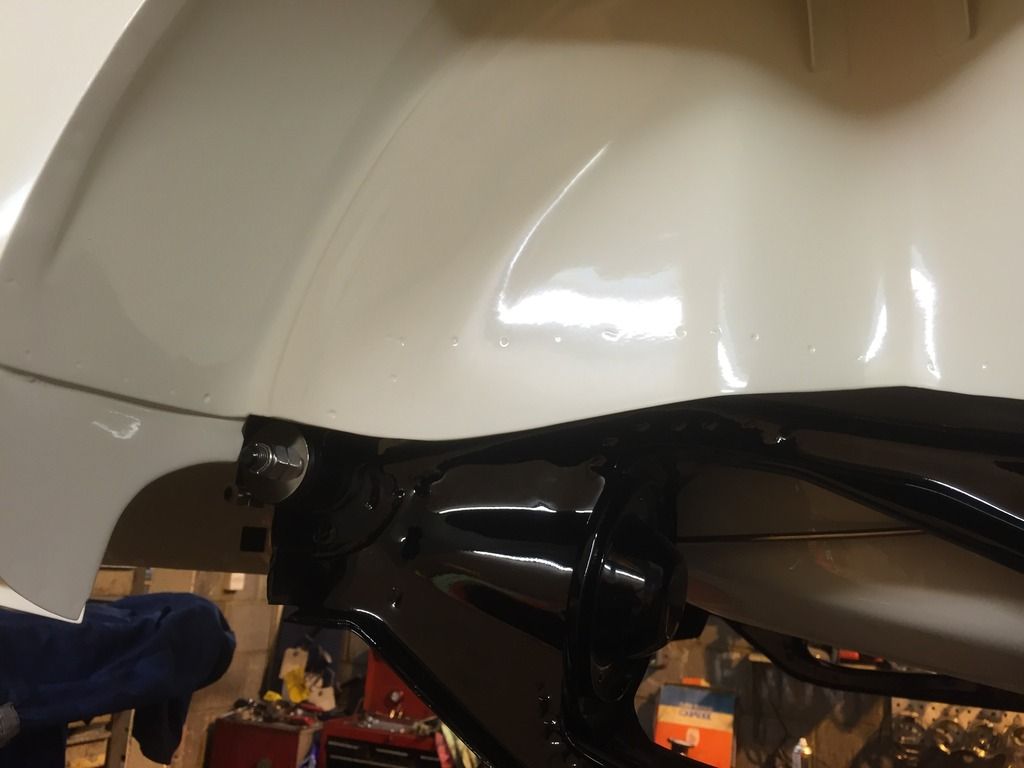

Outstanding Spike, I am not sure but it looks as though you might have fitted the rear shock absorber top bushes wrong. there should be a rubber either side of the arch tub with the conical washer on the top inside the load area. Might be just the angle of the photo and you might have them like that already.

Just a quick helpful comment - you've got the rear brake shoes in back to front. The front should have the end with the bigger part with no friction material at the top, the rear one should have it at the bottom.

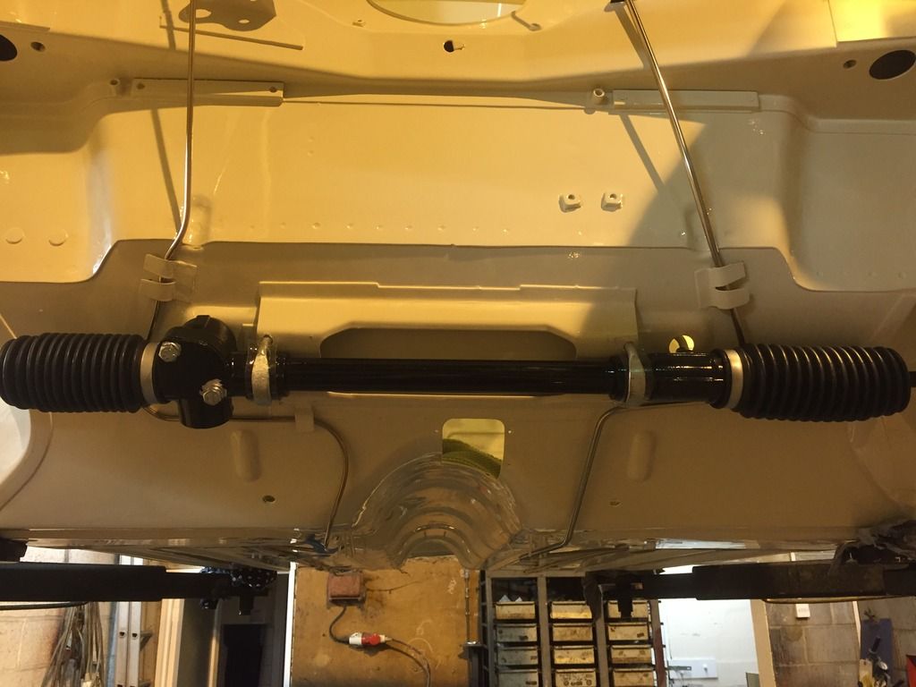

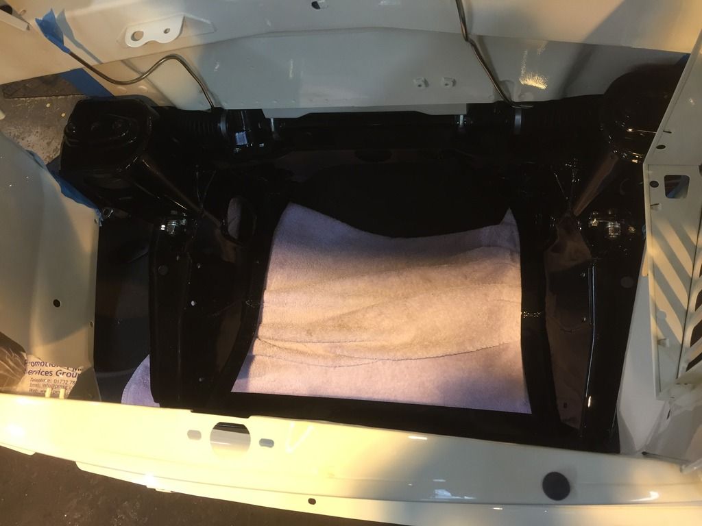

Stunning!!  Quick Question what material are the break/Fuel lines made from? Steel, S/S, Cupro
I cannot make out from the photos
#210 spike 25
spike 25
  • 322 posts
  • Location: KENT
Posted 26 October 2015 - 10:37 PM
Fuel line is Stainless steel and the brake pipe is cupro. Go to the top of the class :-)
