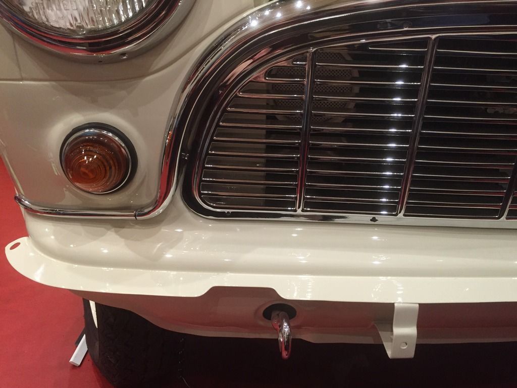

How fiddly were these whiskers to fit!!! I now know why I see cars without them :-)
#237 Vinay-RS
Vinay-RS
  • 2,115 posts
  • Location: Cape Town
Posted 01 January 2016 - 05:39 PM
This is so pretty. Random question: How does the towing eye attach to the car? Also how do the whiskers stay on (are they just clipped in)?
#238 spike 25
spike 25
  • 322 posts
  • Location: KENT
Posted 01 January 2016 - 05:55 PM
Hi
The tow eyes bolt through the subframe and the whisker have clips that slide along the inside of the whisker and you drill holes in the front panel and you rivet them from behind . If that makes any sense :-)
