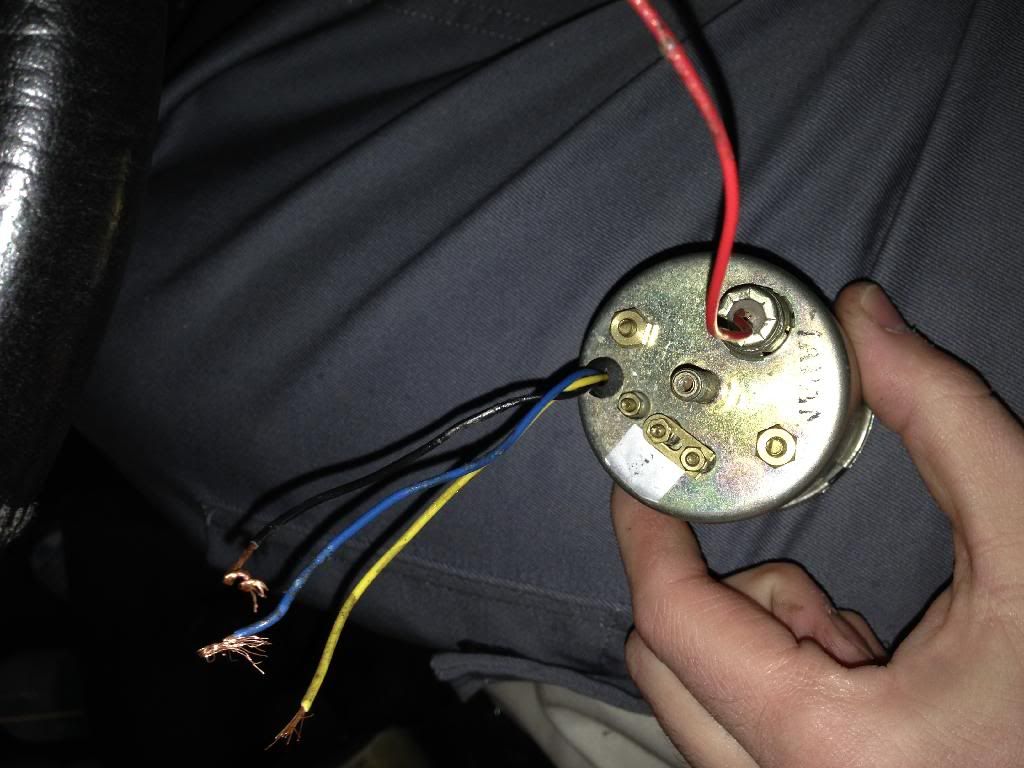

That does indeed Doug look like a Yazaki Tacho here is the wiring which came in the box, pay attention on the wiring for the short red wire and the long red wire though its shown in the colour picture, long red is side light feed in for the bulbs, short red is wired to either blue/yellow depending on the cars earth
Very odd I must say but one way of making a dual polarity tacho.
Thanks it has 4 wires
Blue black red yellow I will get a pic up later

Those wiring colours are inline with a Yazaki Tacho and the above document shows where the wires go, if after trying those out and the Tacho does not work then it time for the parts bin I'm Afraid

5A116245-351C-44E0-A34C-9B4055F426B3_zps

Wire it up and see how she goes
