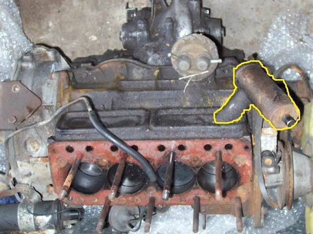

loads of info to read lol… The breather coming out of the engine is at the rear right and its sort of like a 5 - 6 inch black cylinder. is this like some sort of stock catch can tank? You can just see it in this pic (the bit with the little filter on)

Heres a pic I found from google, Should I just connect this direct to the carb? -

Posted 31 May 2014 - 10:52 AM
Thats how my 998 is with a standard HS2 Carb, one pipe from the top of the canister to the side of the inlet manifold on mine.

Posted 31 May 2014 - 11:00 AM
ok, I will do that and see if it eliminates the oil leak issues before stripping things down and fitting new seals as oil is coming from all sorts of places...
#24 CityEPete
CityEPete
  • 3,920 posts
  • Location: On my soapbox....
Posted 31 May 2014 - 11:19 AM
As long as the canister was not blocked up then it will have still been venting out possibly with some oil but it wont have held any pressure to make the other seals leak, oily hands time again, Lol.

well the breather canister seems free flowing, attached a pipe and blew down it and could hear air at the oil cap area
