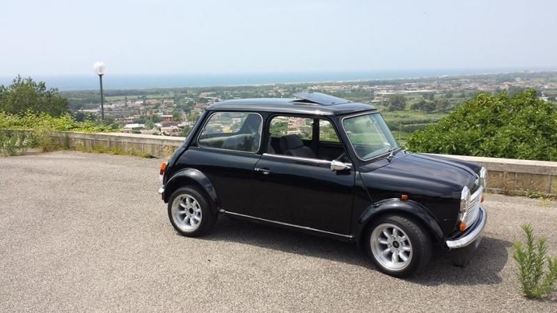

I just purchased this sweet 1990 Mini Saloon.
Being a lifelong gear head (petrol head according to Jeremy Clarkson) the urge to make changes is incessant. I was told that the alternator is only a 45 amp model and as I want to add an electric fan, electric fuel pump, and an aftermarket (MSD) ignition. There items make me think the original alternator won't be up to the task.
So, I guess all that was to ask what are some swap alternator solutions that would give me a good electrical foundation on which to build?
Eric
