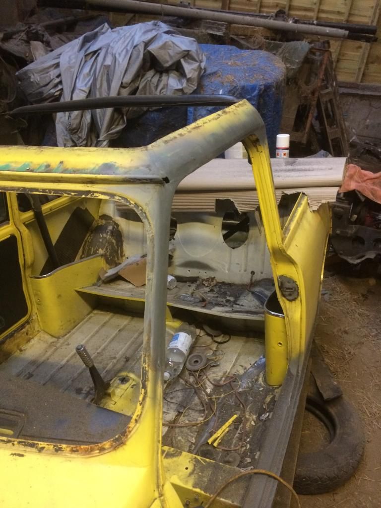

Busy day in the office........

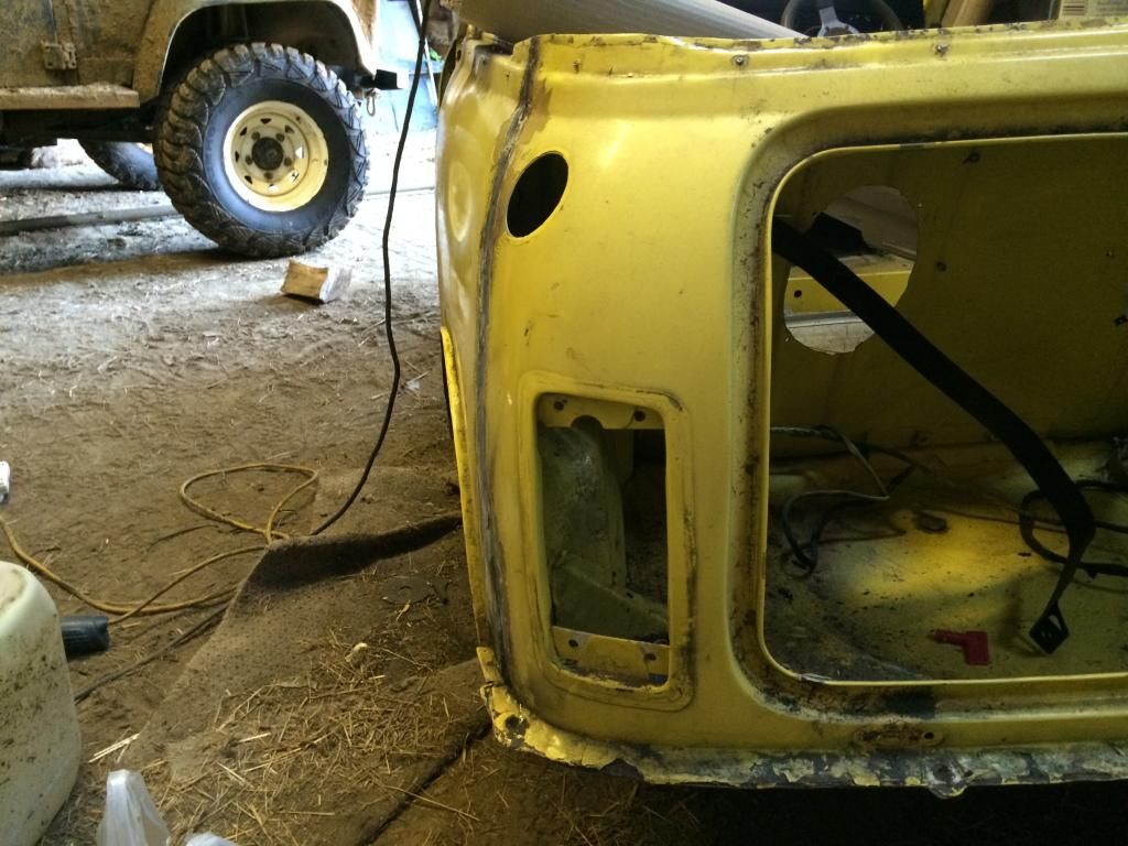

It was interesting too today to unearth the Vin plate in the engine bay. Hidden among the dodgy cheap alarms and horrendous botched wiring i found a paint code NMF - Arum White. Im now in 2 minds as to what colour i fancy. revert to original, go nuts an retain the crazy yellow or just throw down a colour i fancy, maybe yukon grey.
Discuss....

Looks pretty sounds underneath.
If i am honest, i don't like the idea of painting it yellow but then again, it is your choice.
I think a nice summer colour like a pale blue or turquoise perhaps?
Ben

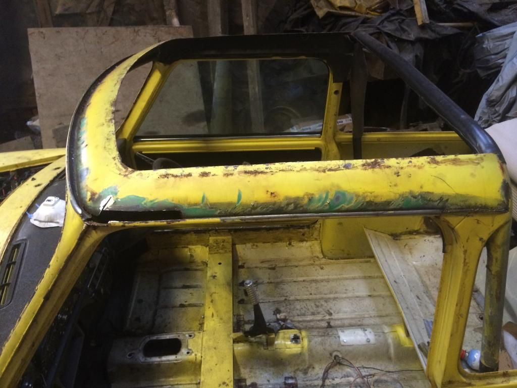

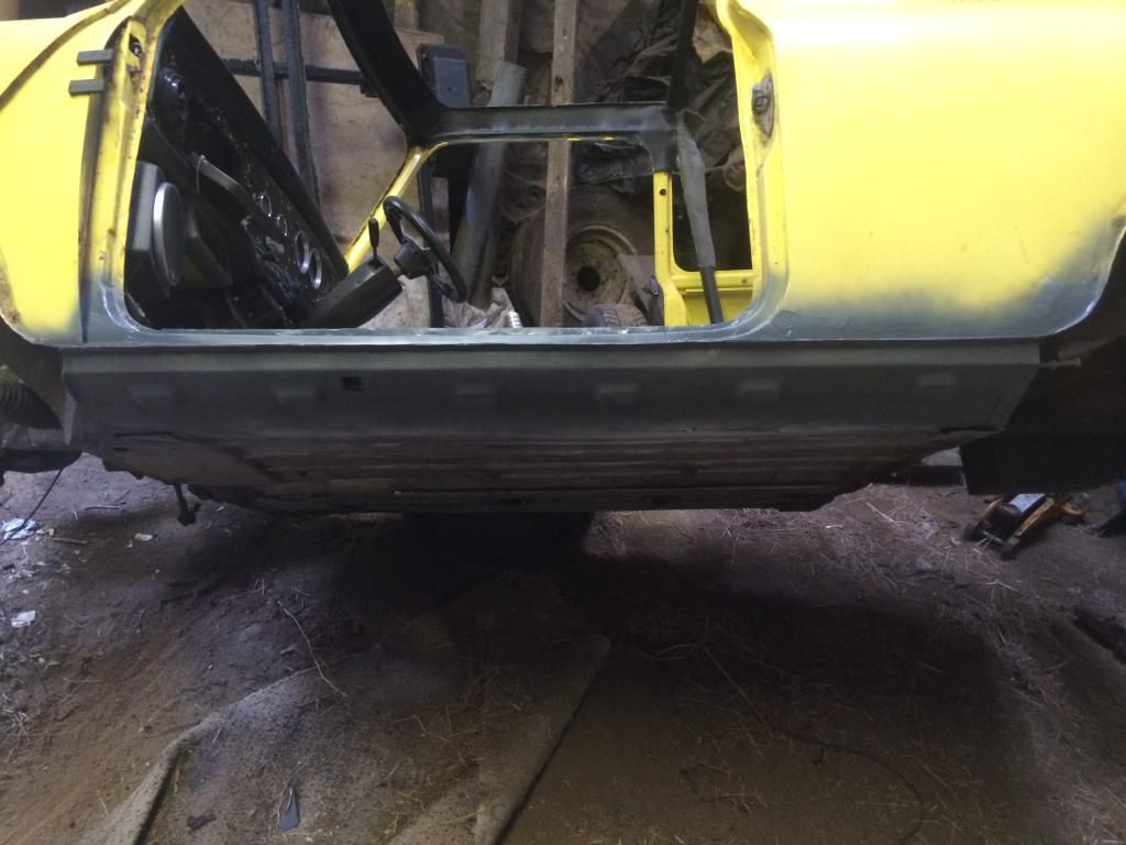

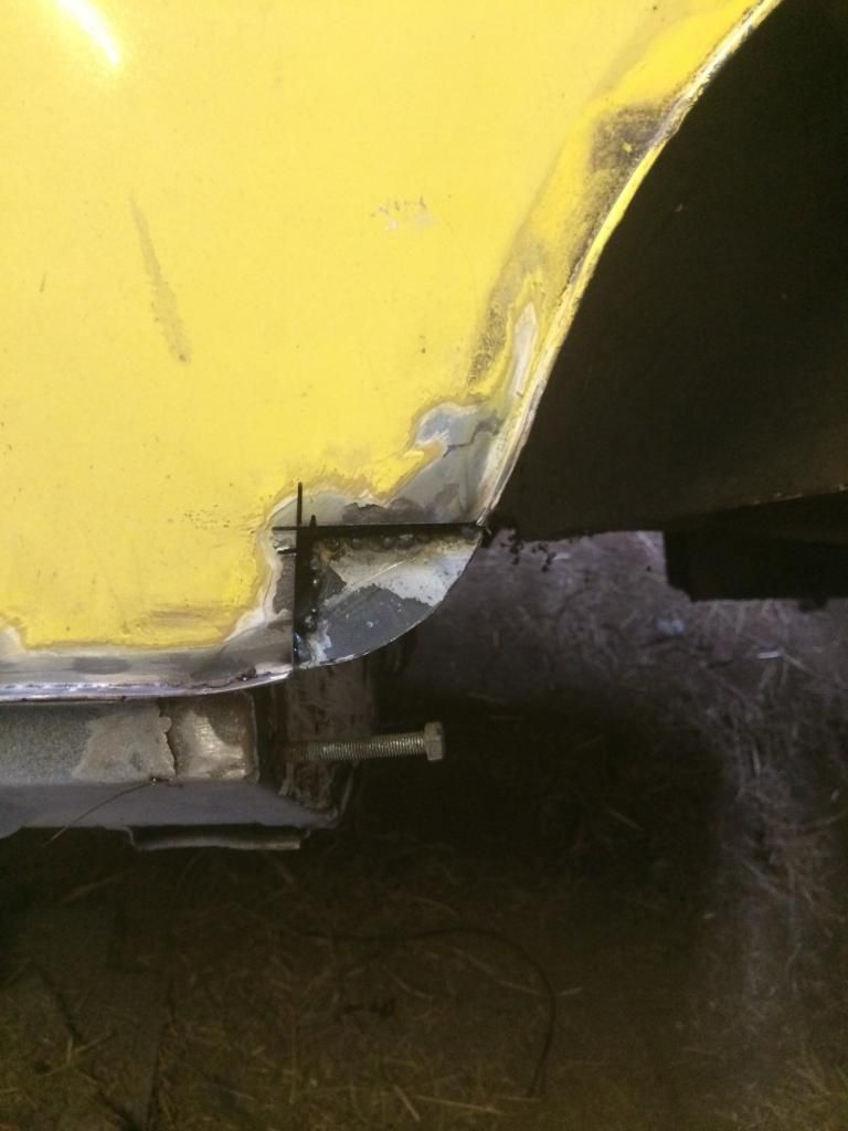

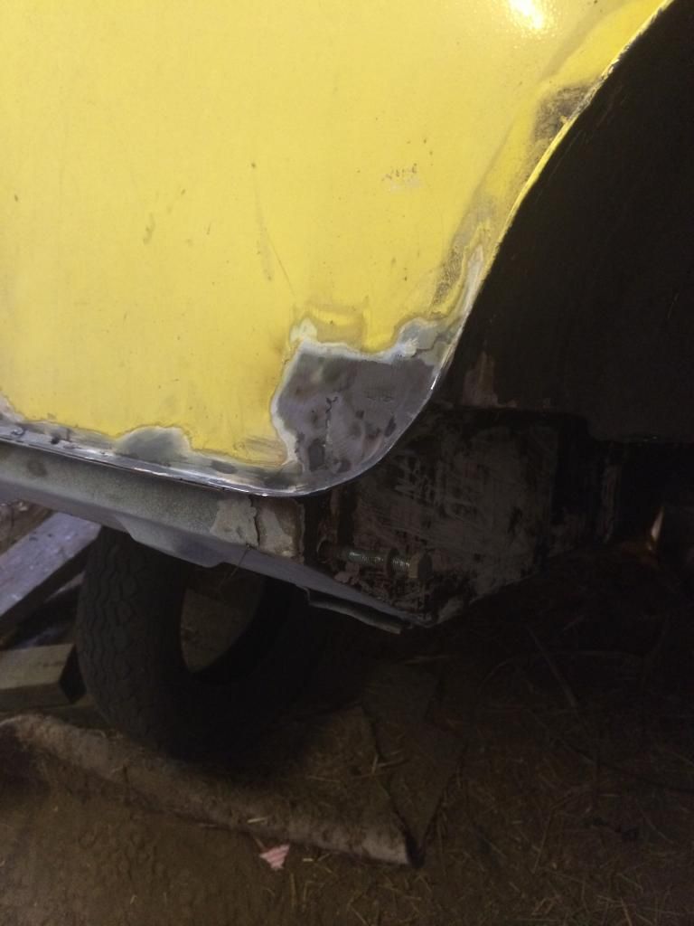

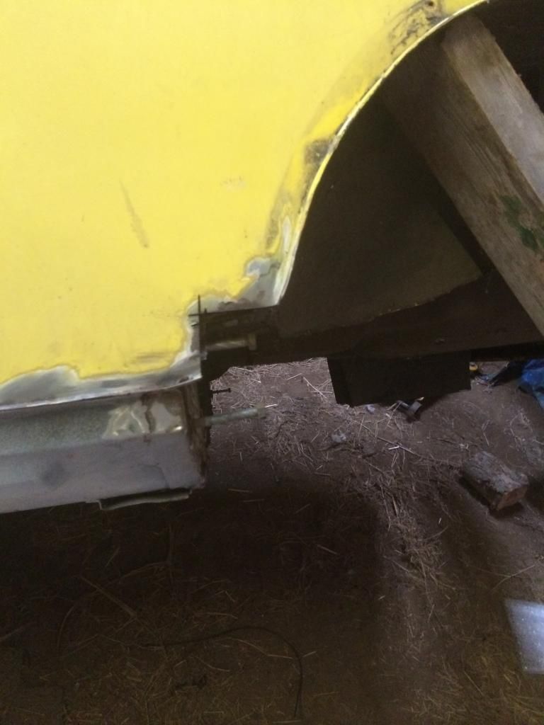

Hi again all, so its been a quiet-ish period. Being in the Military I've been away a lot. I have however managed to squeeze in enough time for a few days work.
 got door steps and sills replaced
Also a small repair......

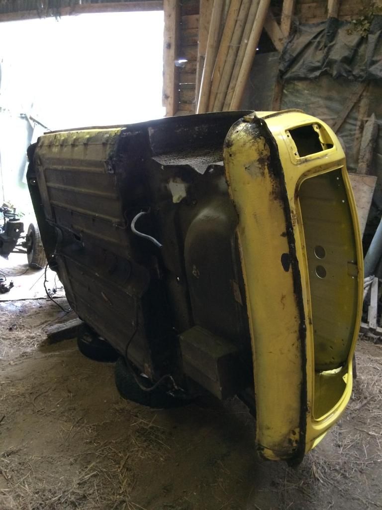

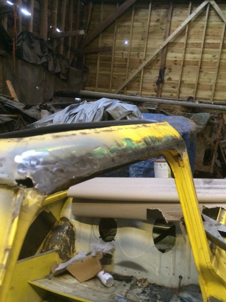

I moved on this morning to the rain channel/gutter. They were badly corroded and I've been dreading this. 2 options, source a replacement roof and mix and match some sections or take the plunge. Ive always wanted to try de seeming my mini so what better time :)
Slow progress but including doing some ongoing repairs its looking good. Cant wait to lead the joints and have a good look.
Edited by garethr123, 31 October 2014 - 09:14 PM.

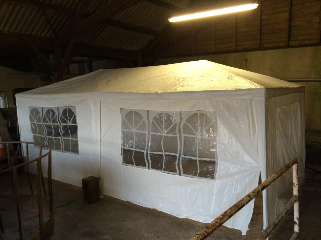

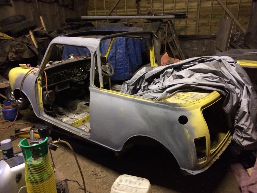

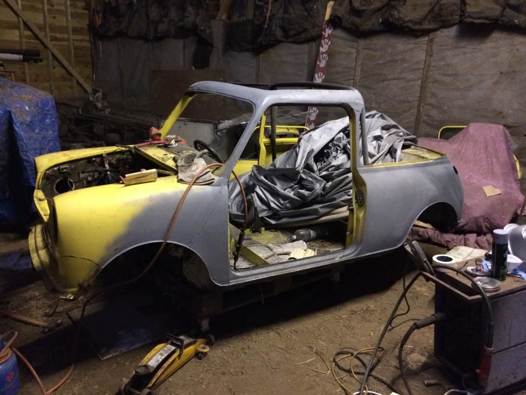

So a couple of day off have led to some more work on the mini. Majority of my time is being spent with the de-seaming, leading the the joints and some filling! laborious but I'm happy with the outcome so far. Still plenty of fill,sand,fill,sand,fill,sand until ill be really happy however!!
A nice little delivery too arrived last week, finally got around to erecting it today, a 6x3 m gazebo. This from now on will become my spray booth when the time comes around (hopefully just after xmas). For £50 I'm over the moon, hopefully will do the trick.
Has anyone used a gazebo to spray in before? I have a valour cad heater which i shall pre warm with and also a large fan that ill use to suck out what fumes are about. All this combined with a wet floor and some pukka lighting should lead to a good job...... Im hoping :)
I have painted cars under a Gazebo before with good results
That paint job was done with an Earlex spray station and was a full respray after i repaired heavy front end damage.
Not too bad for a cheap DIY job

Has anyone used a gazebo to spray in before? I have a valour cad heater which i shall pre warm with and also a large fan that ill use to suck out what fumes are about. All this combined with a wet floor and some pukka lighting should lead to a good job...... Im hoping :)[/quote].
Yeah this was painted in gazebos.

These are awesome. Makes me realise I've made the right choice :)
