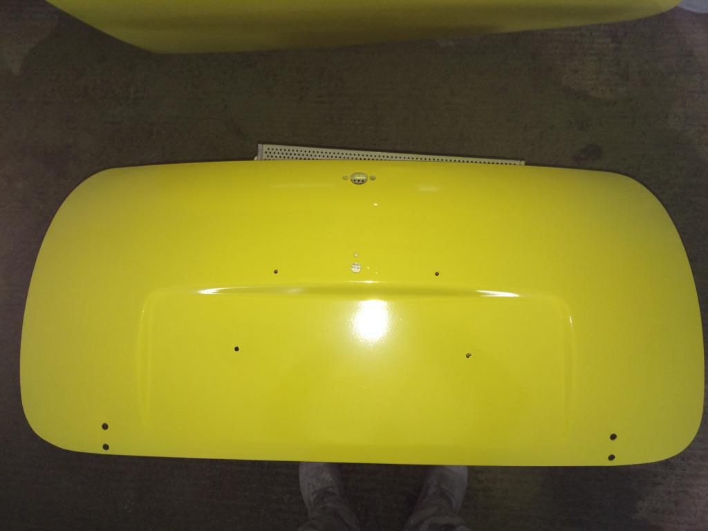

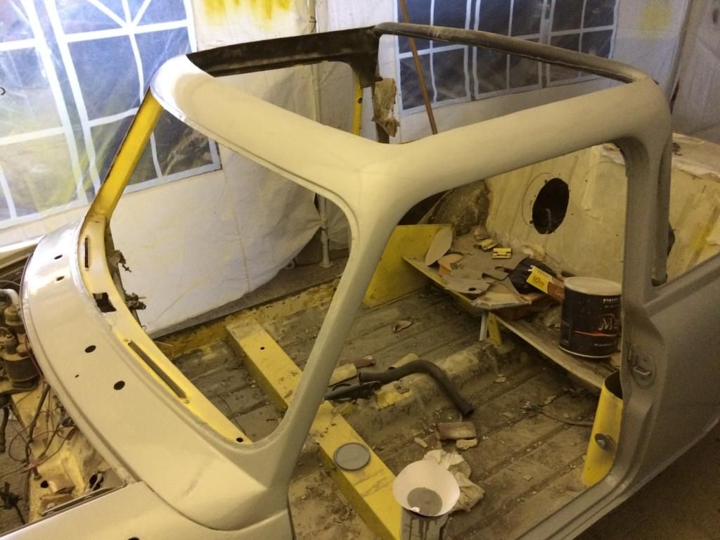

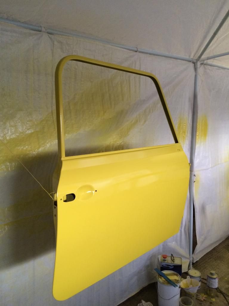

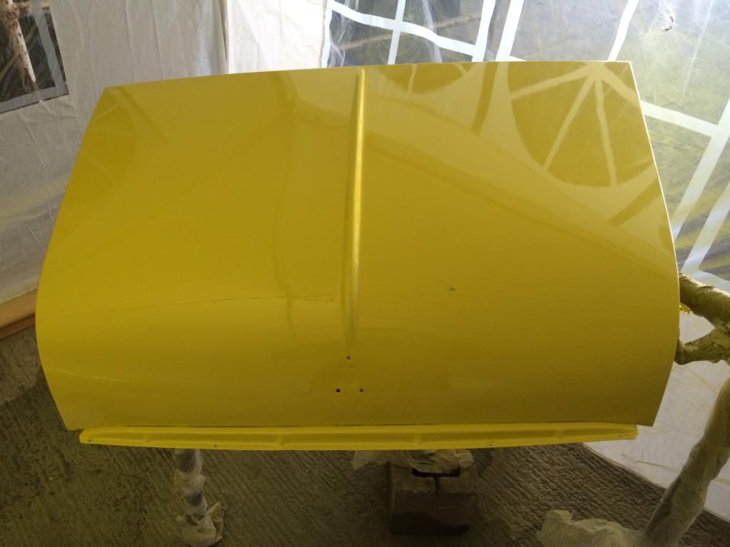

Hi all. So its been a short while but between work and christmas life I've managed to get back into the swing of the yellow peril.

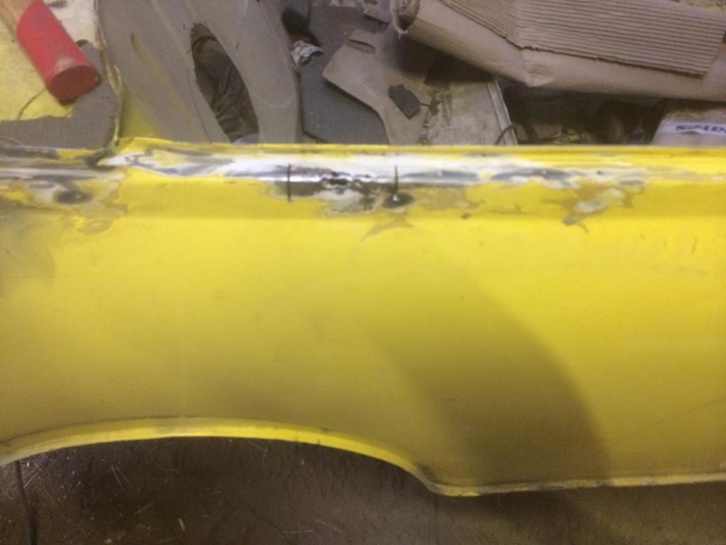

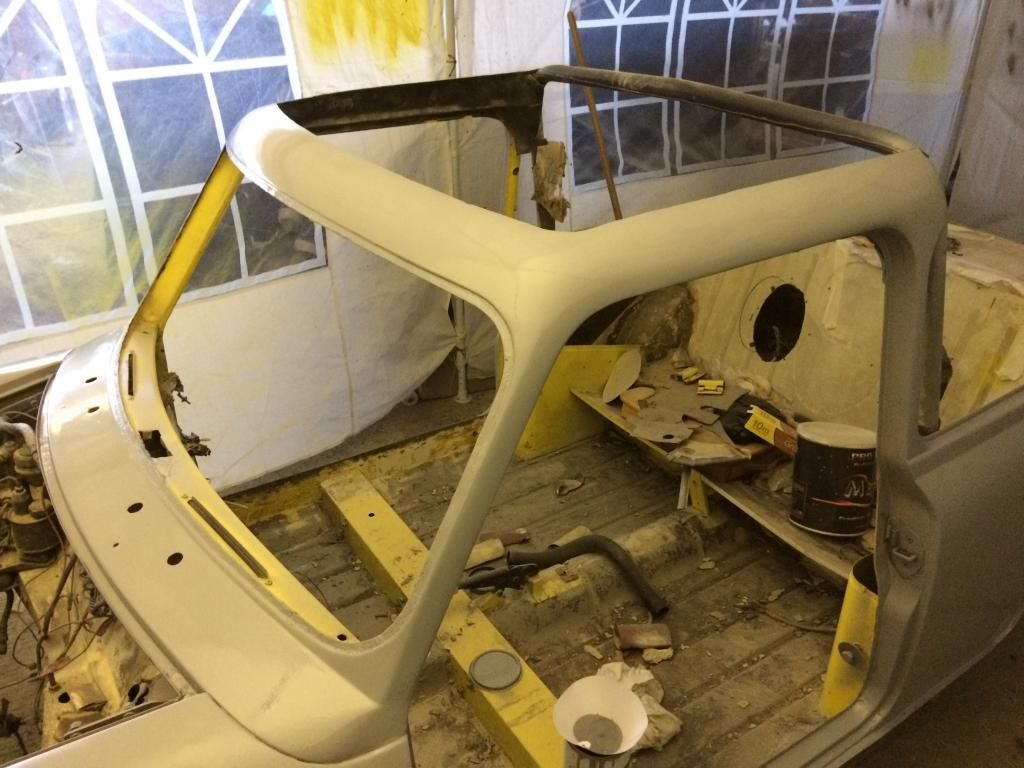

Ive finally managed to de seem fully and what a pain in the backside!!! Its no mean feat by any means but now its done its worth it i think.

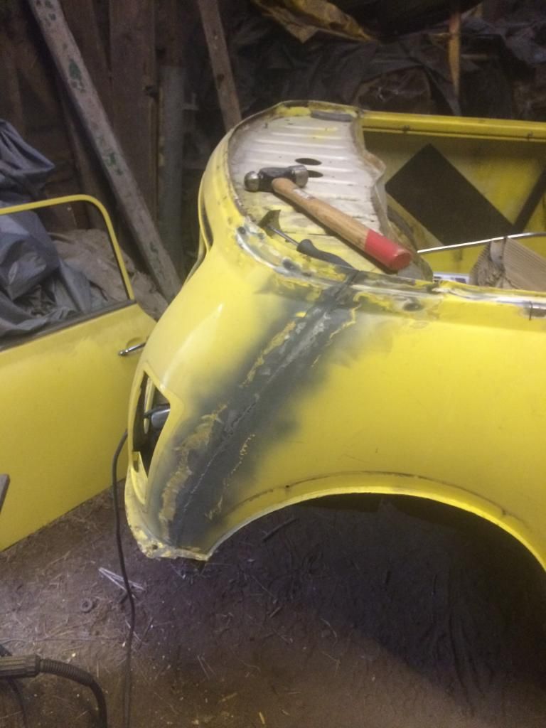

I lead filled the gap after welding the seems together, this was followed by several small skims of filler and eventually today, I'm happy with the smoothness!! All will show once in primer however!!
Another small patch of rust discovered under filler and paint!!

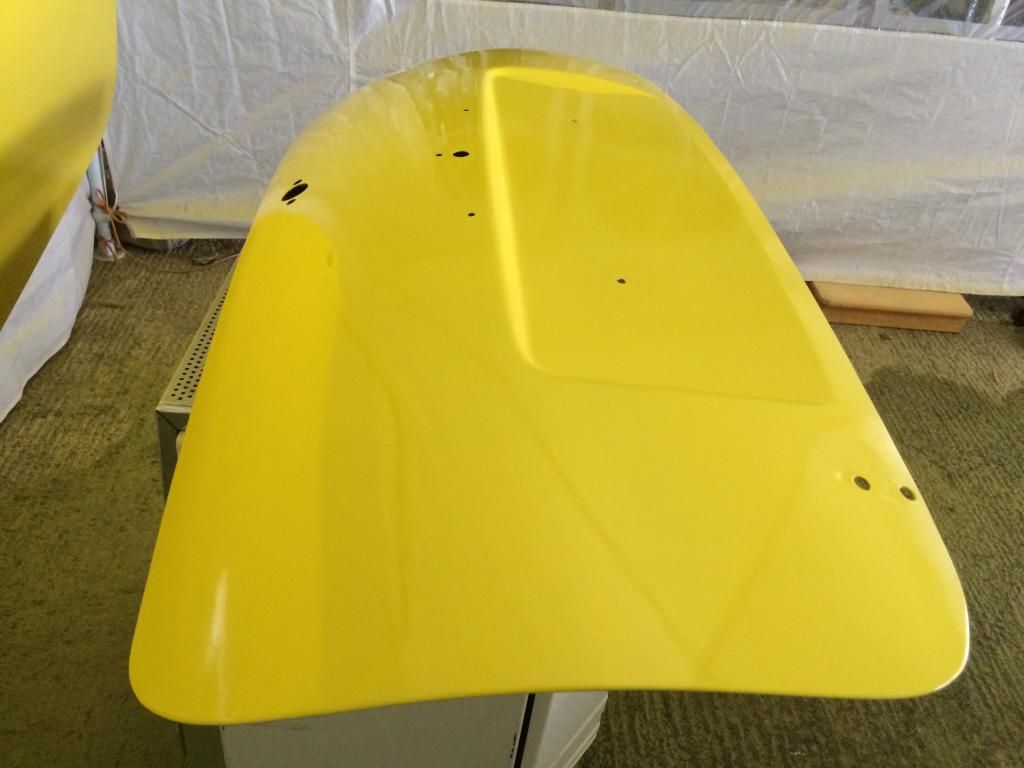

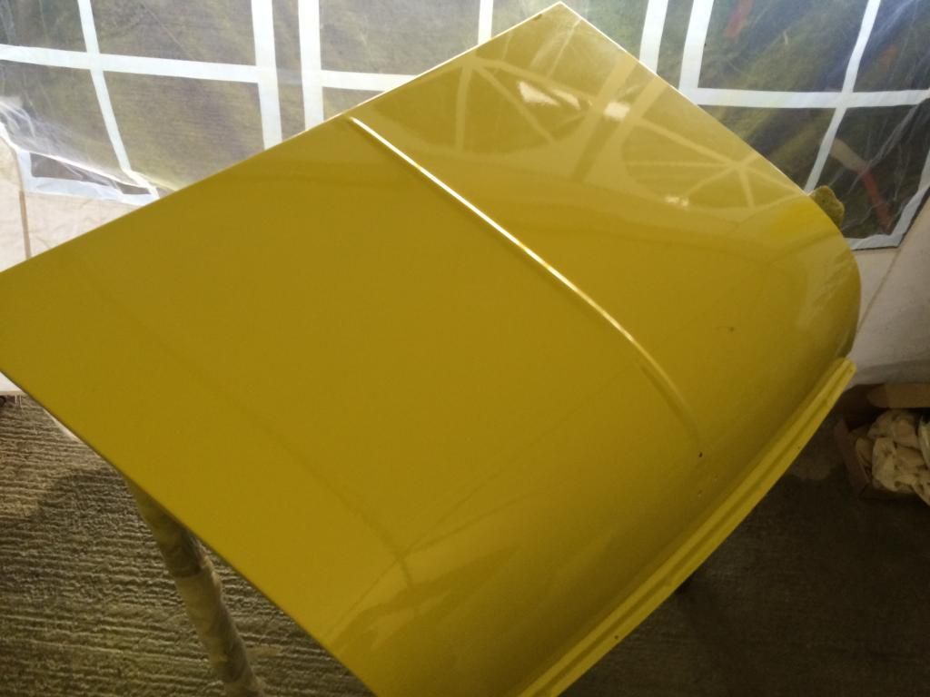

So i primed the doors, boot and bonnet last weekend with some high build primer. They were flatted off, small low spots filled and then reprised yesterday.

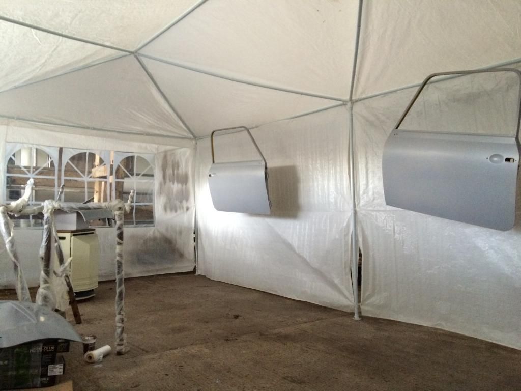

Hanging in my new booth :)

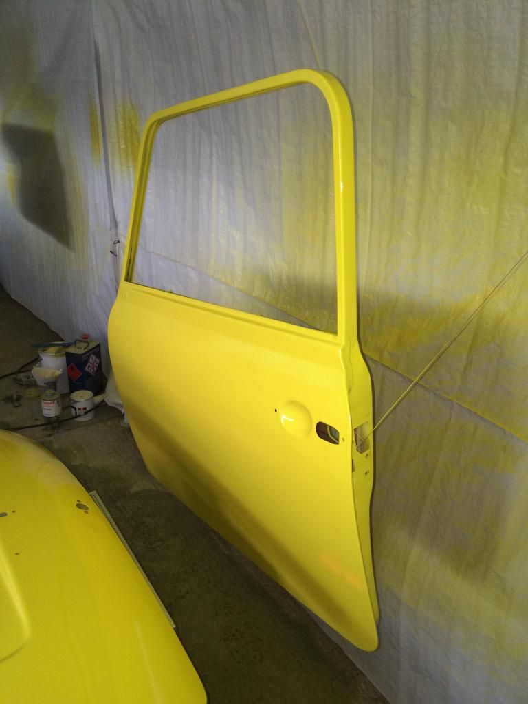

This morning I flatted off with 600 grit Wet and Dry, cleaned up and sprayed. So happy with the outcome especially as this is my first attempt.
This was 4 coats of 50/50 cellulose.
Door

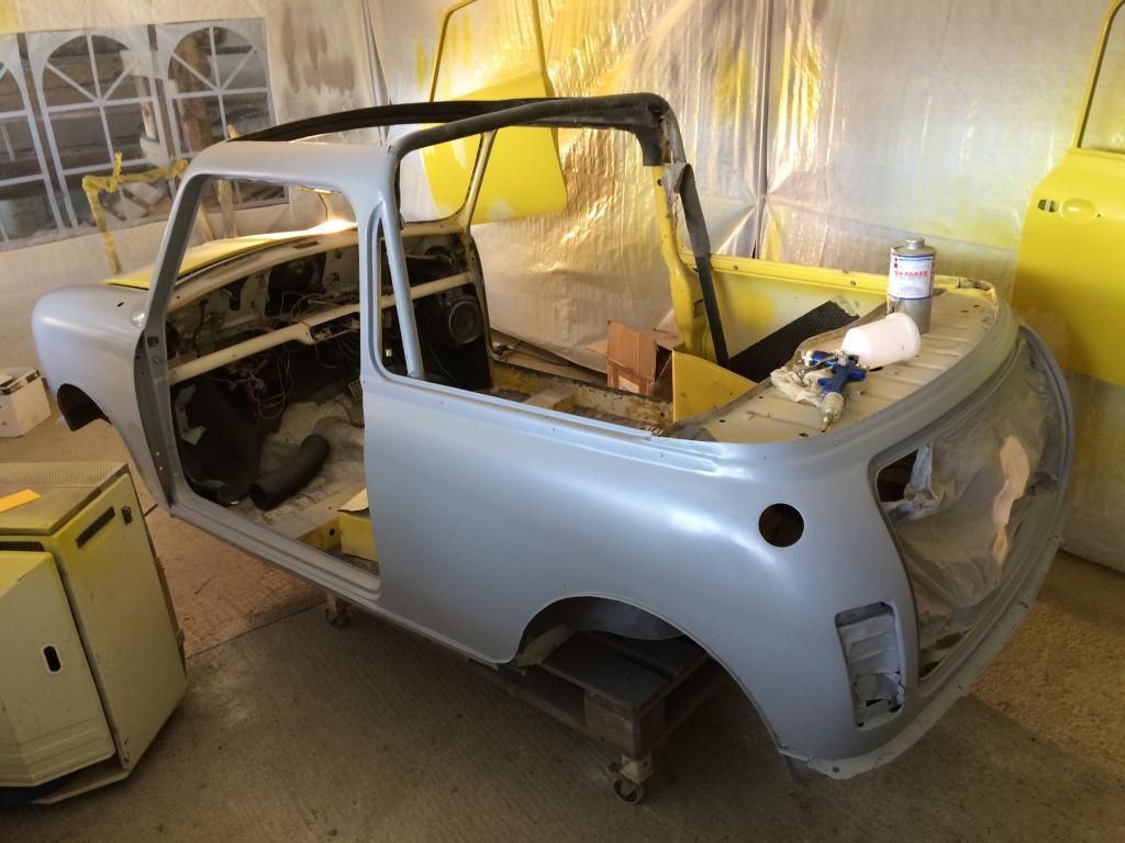

Bonnet
Boot
 And other door
As the eagle eyes about you will spot, i managed to touch the bonnet with the air line, Left me infuriated but it'll repair later.
Im hoping now tomorrow i can finish the rest of the shell and get it in primer over the rest of the weekend.
The yellow parts will possibly be colour sanded and buffed but ill worry about that at a later date.

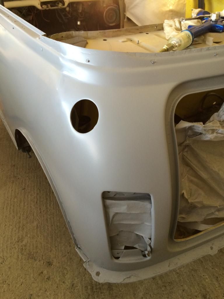

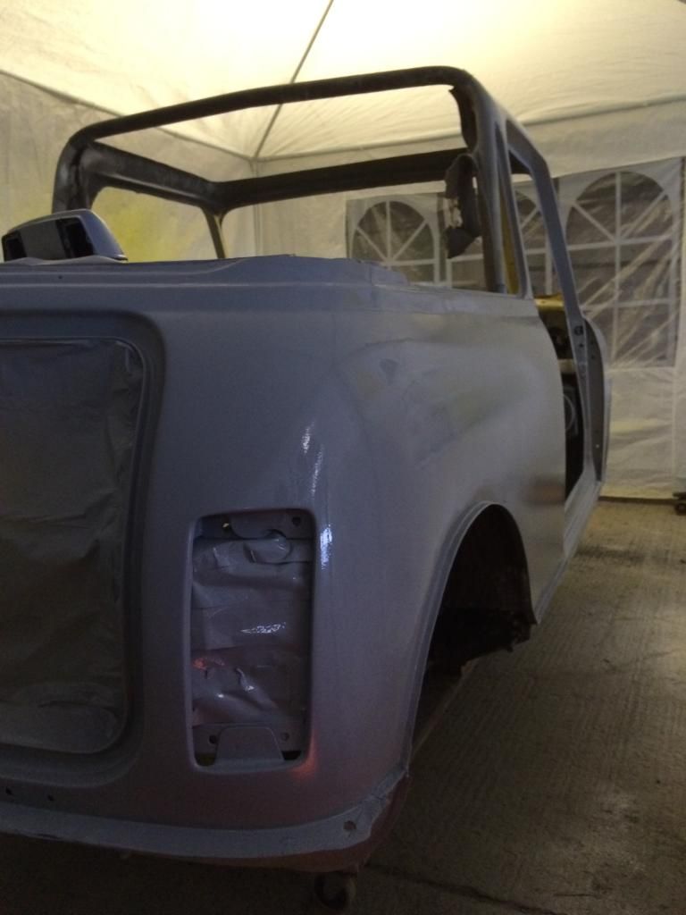

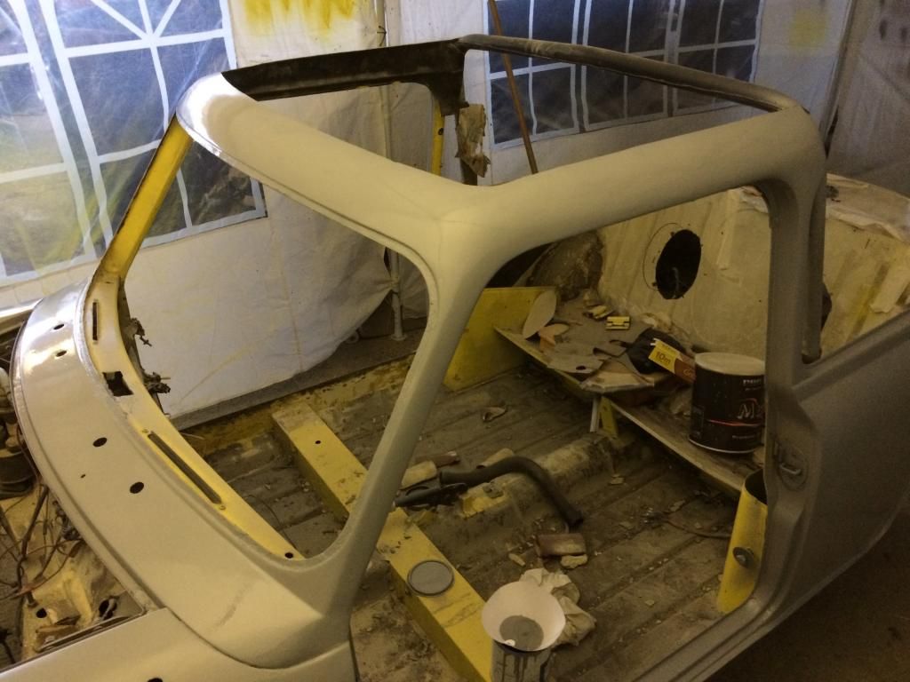

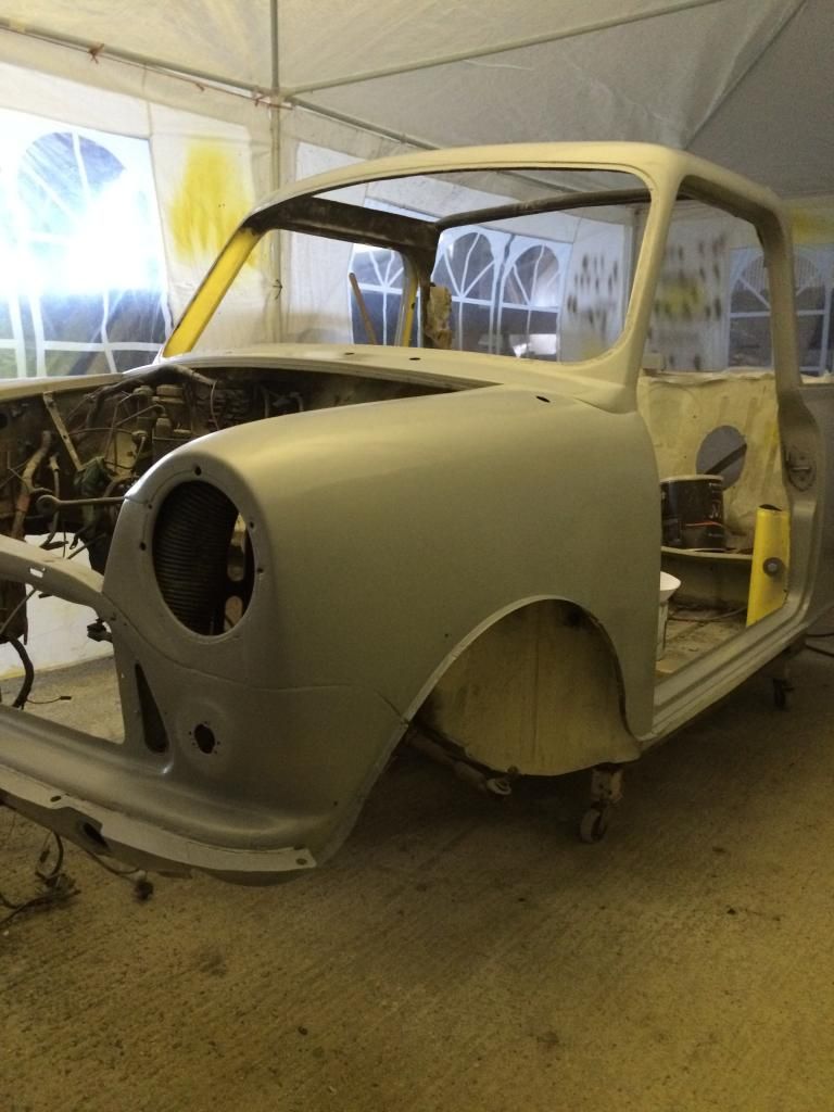

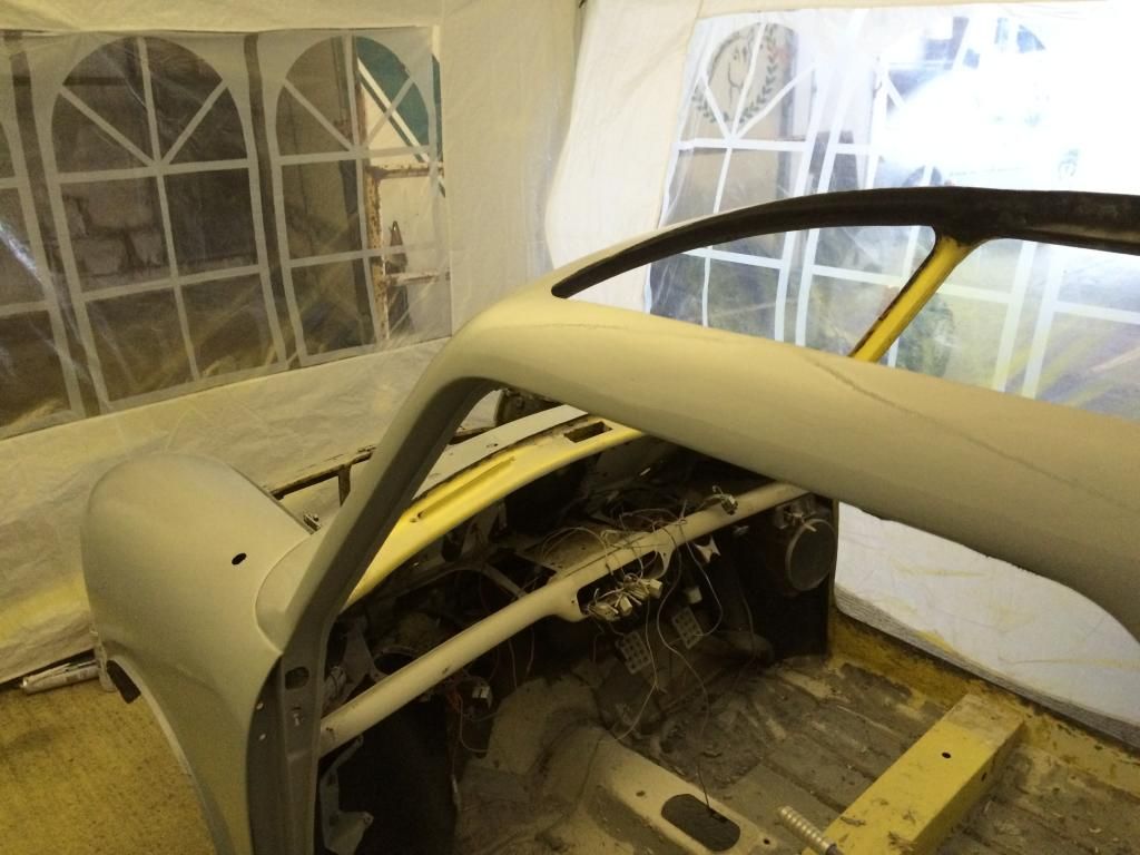

Last of my days off today and went out the hit the mini again.
Did a final skim and sand and finally got some high build primer on. In total i got 4 coats on. Ill wait to see how it wet sands before i decide where to go but for now its all coming together!
Quite pleased as to how smooth the de seaming is too. I weren't to sure show it would come out but seems to look straight and flat. :shifty:

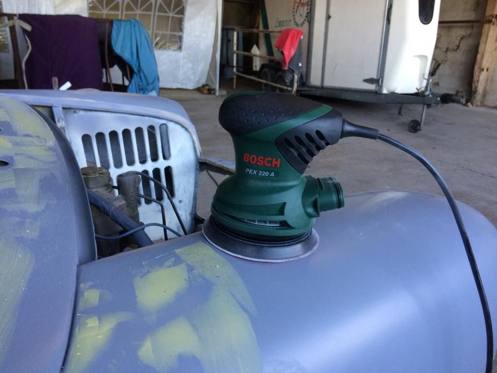

I attempted to smooth over some very minor imperfections with some U-Pol glazing liquid. Looked awesome, went on incredibly smooth and nicely. I felt myself getting a tad carried away with this. Next thing I've got about 30% of the car skimmed lightly in this in an attempt to maintain the fact it WILL be flawless paintwork. No problem i hear you all call. Well if you've tried sanding this stuff its horrific! Clogs the paper like no bodies business. So i used up all my rolls of paper, the went to rub the rear quarter down with panel wipe and grabbed the topcoat thinners instead!! Next thing i have a small run of primer where its reacted!
Today was one of this days! Fingers crossed tomorrow will be better and i should have it back in primer. hopefully extra smooth :)
this years purchase is definitely going to be a DA sander. My fingers are in tatters!

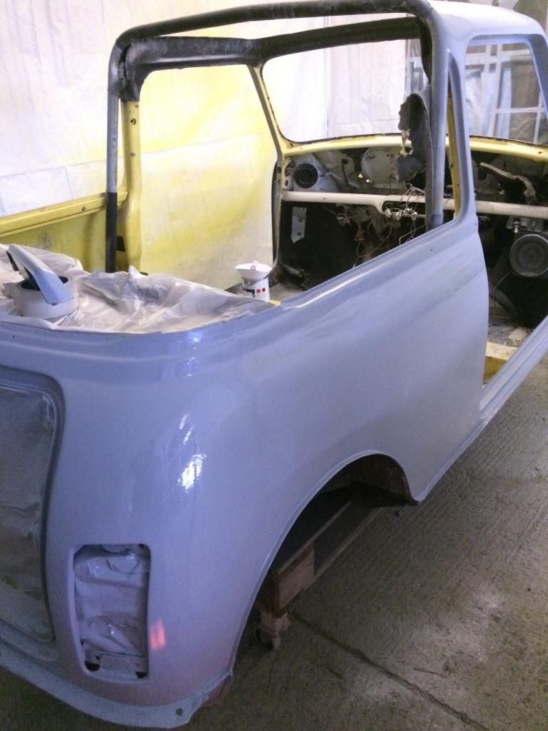

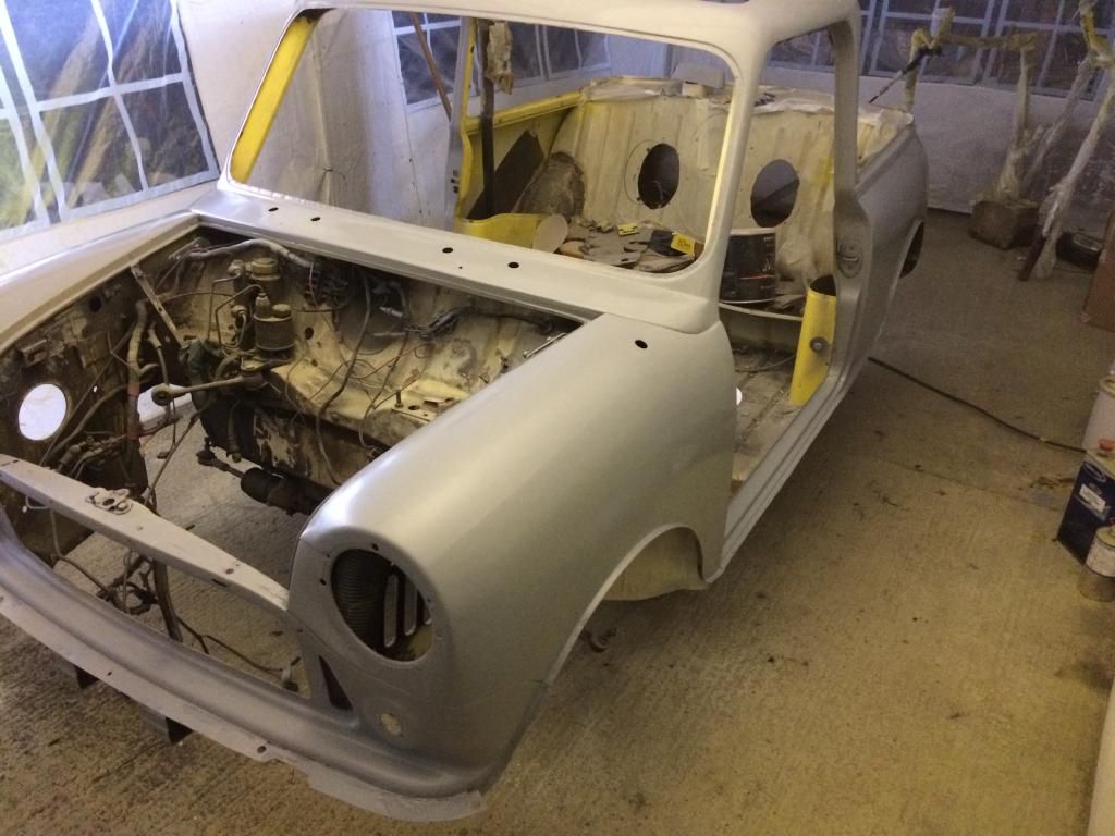

Picked up a tidy little DA sander and I'm blown away. It amazing. That amazing that i managed to sand, prep and primer the mini today! Honestly made my day
This primer went on far better. Smoother and there are barely any defects in the bodywork so good start

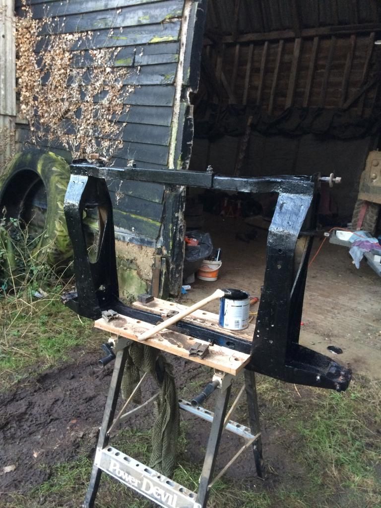

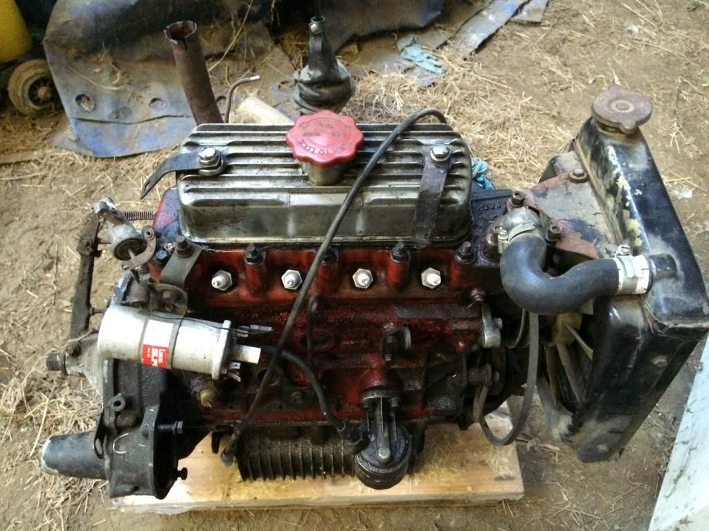

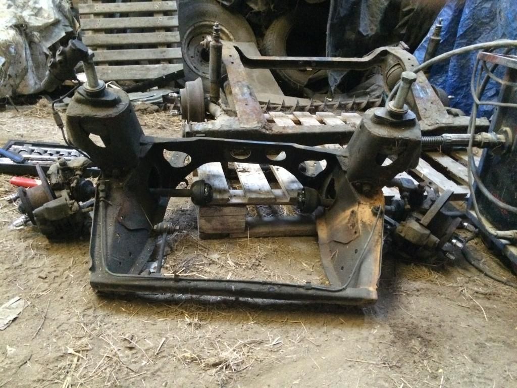

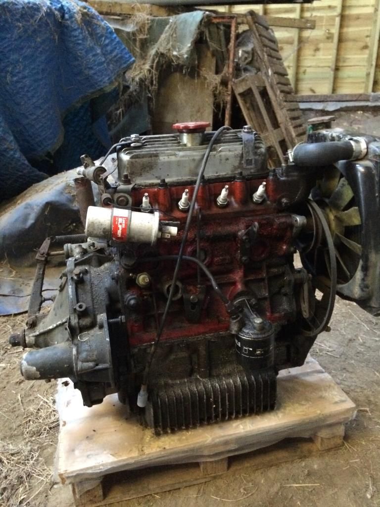

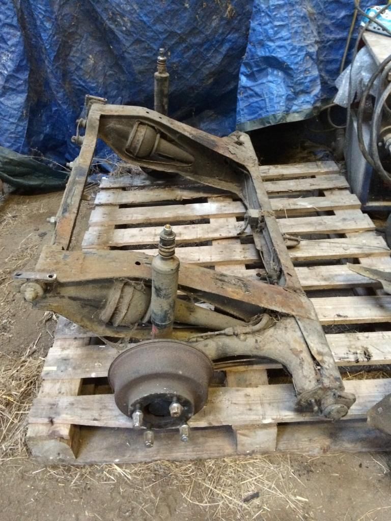

Left her to dry and went attacked the subframes!! Tore out the engine and stuck it on a pallet, that'll be refurbed at a later date.
Stripped the rear subby, wire brushed down with the grinder and a good slap of Hammerite.
pretty much everything i took off was in great condition bar the dirt. Im going to clean and salvage what i can.

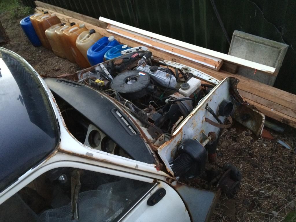

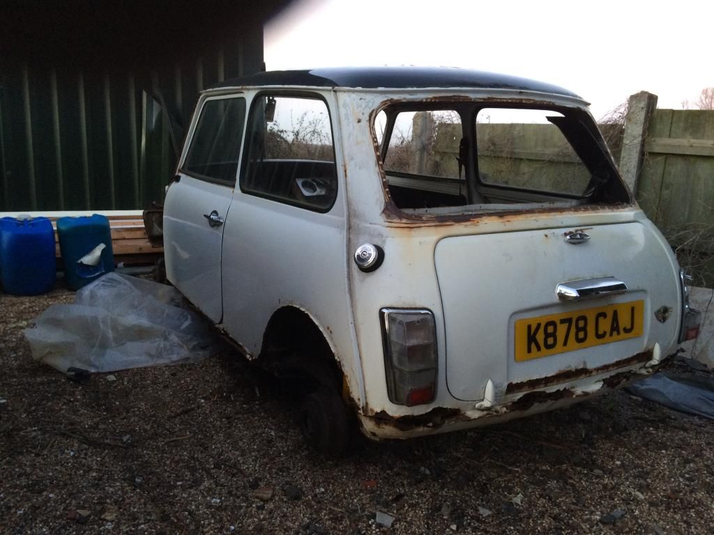

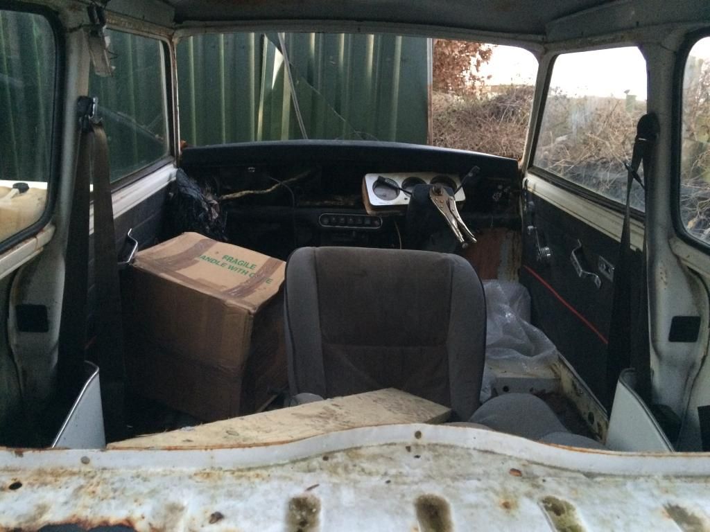

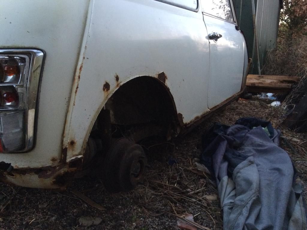

Decided to go view my potential new project too. I need someone with an ounce of a brain to tell me "No Gareth thats too far gone, it'll take ages blah blah blah"!!

If it's just rusty Gareth, then it's not to far gone IMO.
If it is full of hideous bodges and badly fitted plates, then i would walk away and find something better.
Mine was/is very rusty but it's mostly original apart from a pair of cut down and well fitted oversills and a patch on the front floor.
Don't know about you but i much prefer removing holes panels than piles of patches
