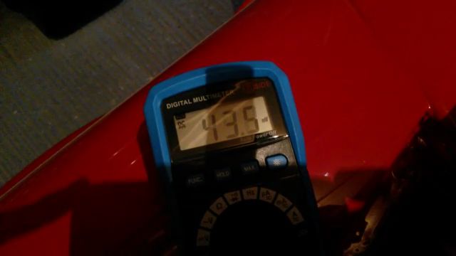

I have taken a short video of a multimeter vs snap-on measuring the o2.
http://i237.photobuc...1102_162224.mp4
It appears to be switching OK on the multimeter and a bit slow on the snap-on

It appears to be switching ok until about 7 seconds in, then there's a high reading on the volt meter of 1.37V. Not sure if the snap-on is showing the peak voltage or an average, but they look to be showing the same thing.
I would have suspected the sensor itself, but you've said the unusual voltage is still present without the sensor. Generic replacement sensors usually don't have the correct plug, (if they have a plug at all), so start checking the wiring at the sensor end to see if someone has altered the loom close to the sensor. Also hunt around the engine bay for places where the wiring loom is earthed (EDIT: I would suspect there could be than one place). A bad earth on a signal wire can cause signal voltages to float higher than the really are.
