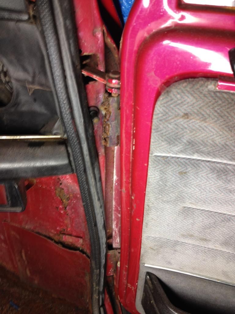

Posted 01 December 2014 - 08:38 PM

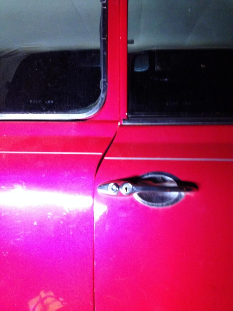

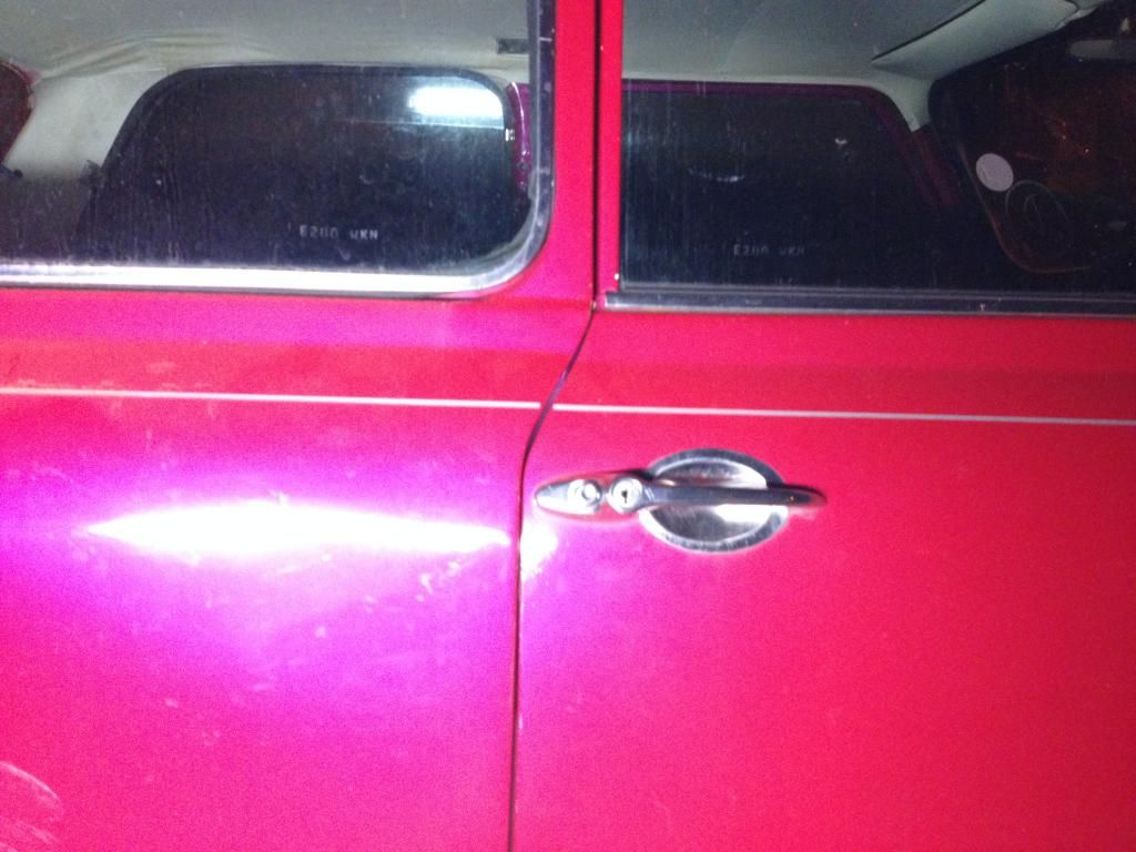

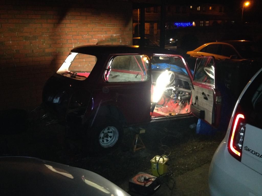

as soon as i got back from work i un wrapped it and got busy.
as you can see not the best.
this is the only place the door is rubbing

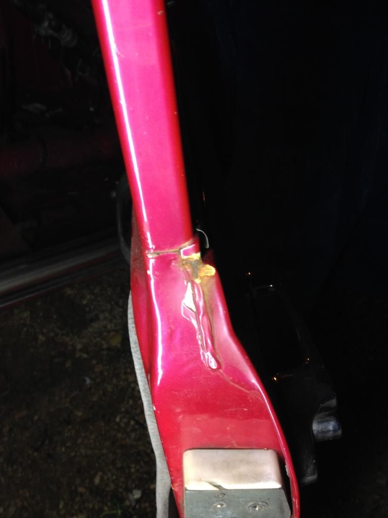

this is the really bad repair that has been done to the hinges
this is the gap at the end of the waste rail on the passenger side
and this is the gap on the drivers side i would have thought if it had been push this gap would not exist any more??

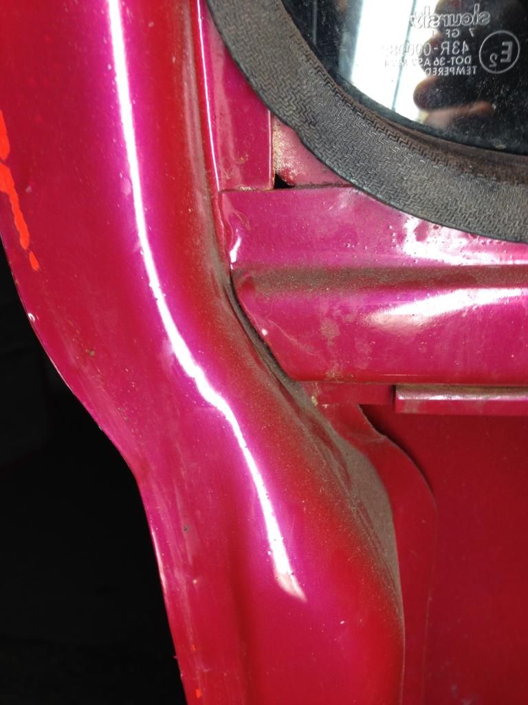

this is the door at the bottom notice the over lap

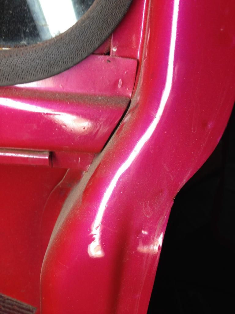

this is the door ajar resting on the catch notice the detail lines out of line
with door fully shut
the door drops about 8-10mm when opened due to the hinges
with all the measurements i have taken and crossed over, added up from all over the place i do not think that there is any thing to worry about.
every one was with in 2-3mm of each other or there abouts.
does this look/sound alright
thank you for your help
