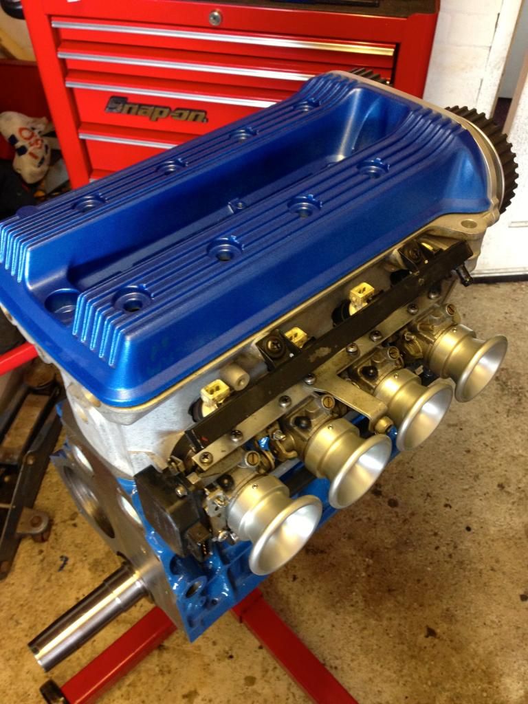

Hi you all...
Does any of you guys have any experience wit this kind of engine? ( link below )
like: woud it fit to a force racing titanium front subframe or not?
Would it stick out like in the second picture?
Wich gearbox could it fit to it?
thats pretty much it :)
link:  http://www.twinkam.c...=12&aid=SCE002
it's a bad picture but you can se what's going on wright ;)
Thanks for everything, Jure

Any mini gearbox. But which one and gear set it up to you.
Standard subframe mounting.

It's a normal  Mini engine with a BMW motorbike head, so no different.

Yes that is a BMW cylinder head on a Mini block.
Been done for years and years.

The twin Kam conversion is one of the better ways to make power from an a-series. The standard head is asthmatic at best so by fitting a BMW k-series (k1100,k1200,k1200rs) head to it which breathes a lot better you can get more power from the engine. Generally speaking on a 1275 you can get about 120 bhp provided you work on the rest of the engine.
The main issue I found with this engine is cost, I was seriously considering it (and still am to a certain extent) but you are looking about £1000 in gearbox bits so it can take the power, and probably won't be left with much change from £3k for the engine including all the machining and components. But it tends to be a more reliable way to get more than 100bhp from the a-series. Other options is a race prepped engine - mini miglia engines produce about the same power but only last a season of racing and the likes of swiftune charge £20k for one of those. Then theres forced induction and more likely turbo for the same sort of power but that comes with its own costs and complexities.
