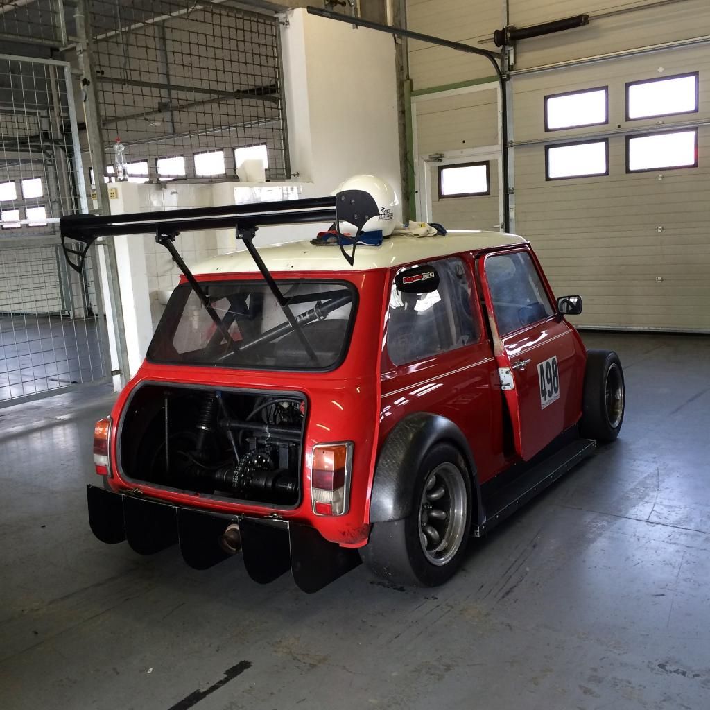

And I have some videos of mini in the pic #4 on my you tube channel: https://www.youtube....vxBZdPiPn-bQl3A

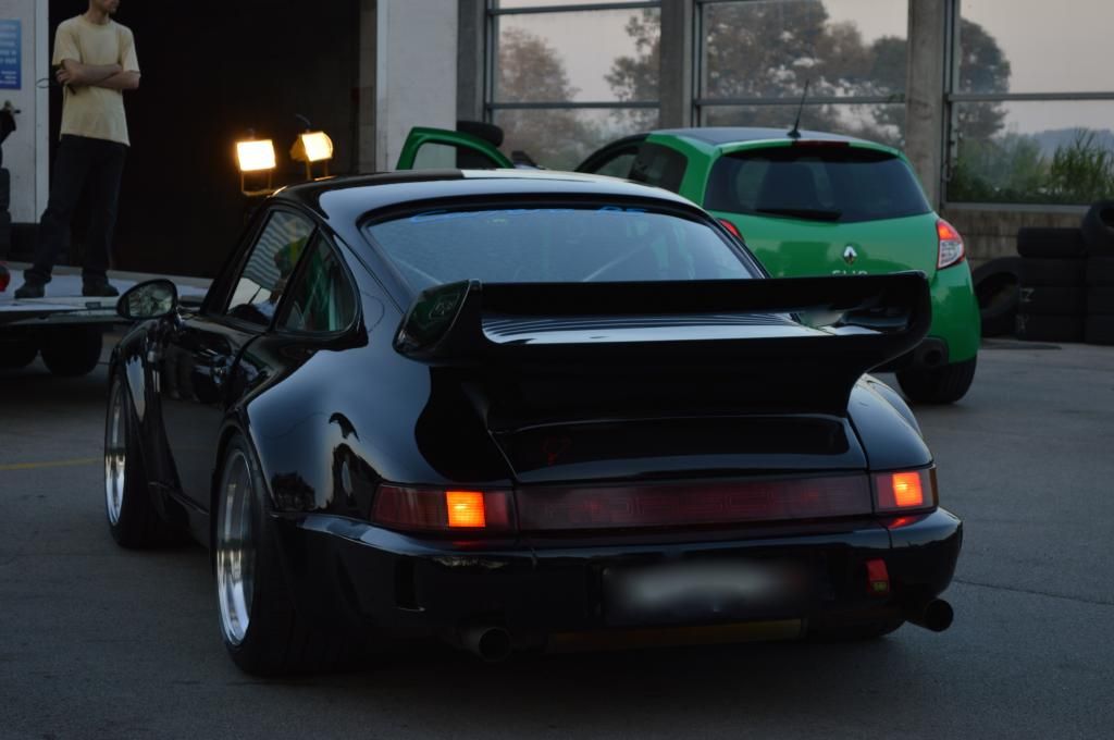

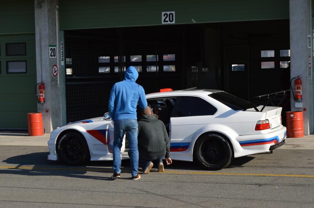

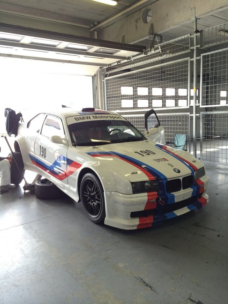

I wil attach some pictures of the car my dad has for the road use and the car he has for the race track:
and in the pic #4 is my dads friend's car!
road use car: ( I don't have better pic )
race car:
friends car:
