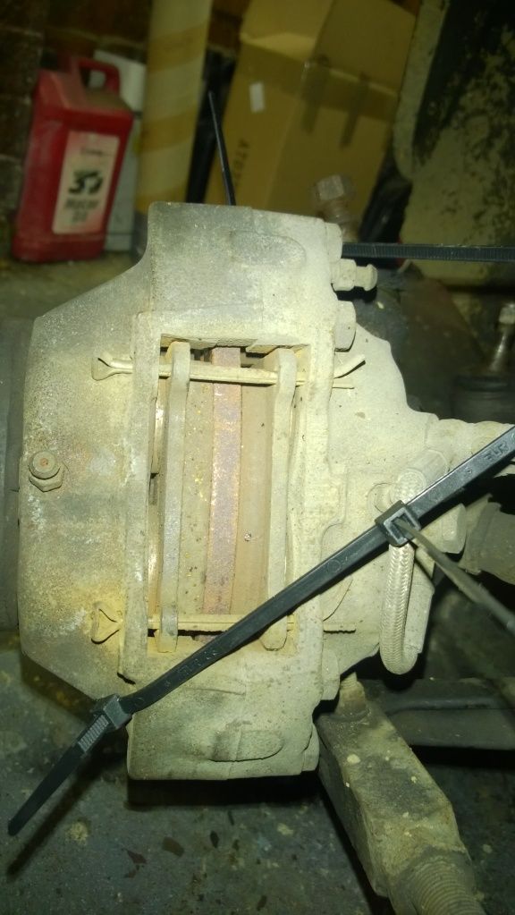

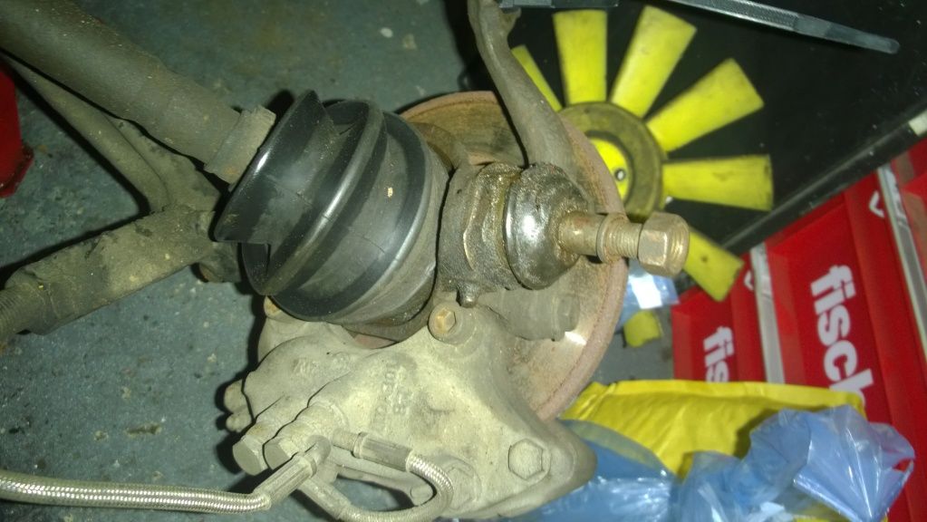

Here we go, disk hub, but I cannot decide what has been modified to make these calipers fit.

Does not look like it.
Let's see the side of the caliper that would rub in the inside of the wheel.

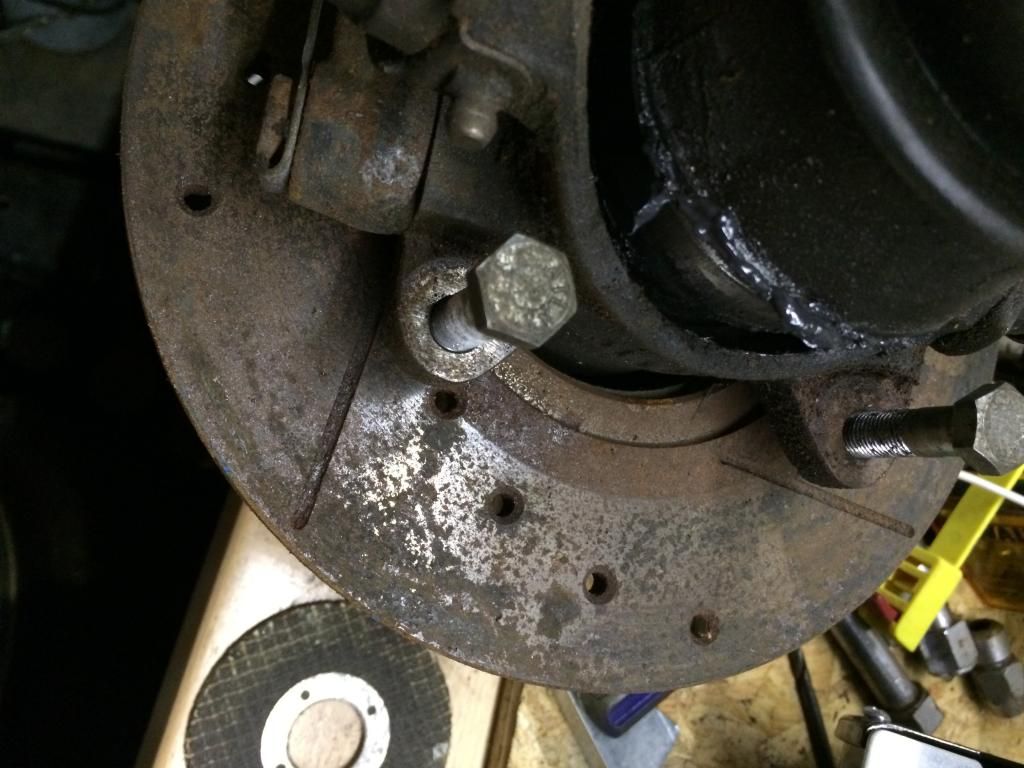

Posted 15 January 2015 - 06:34 PM
excuse the flash, but to me it doesn't look like its been ground down, but I have nothing to compare it to.

Posted 15 January 2015 - 07:26 PM
Don't look like they have been touched. Discs look like the right size for the calipers as well.
Time to get the tape measure out and actualy measure the diameter.

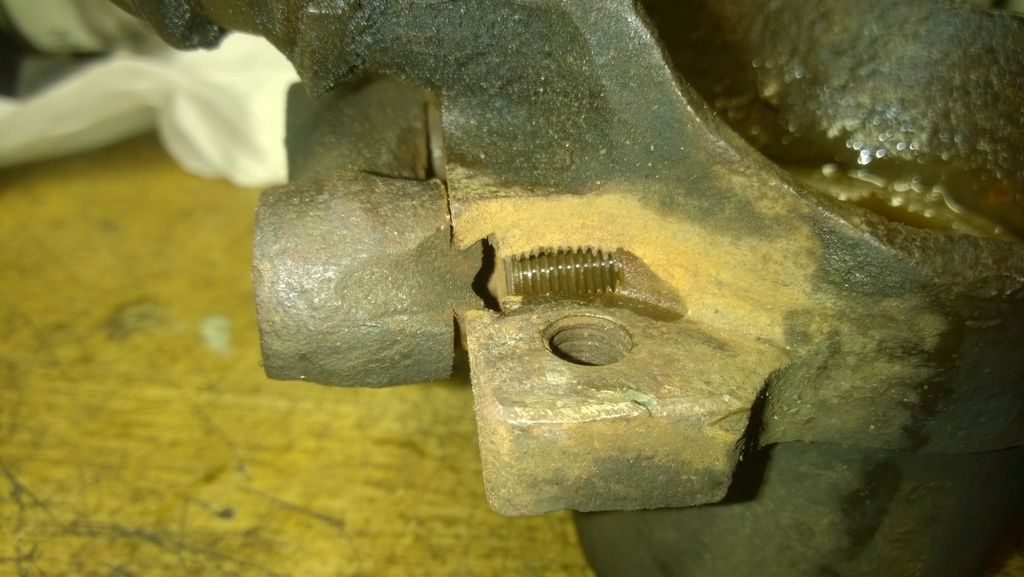

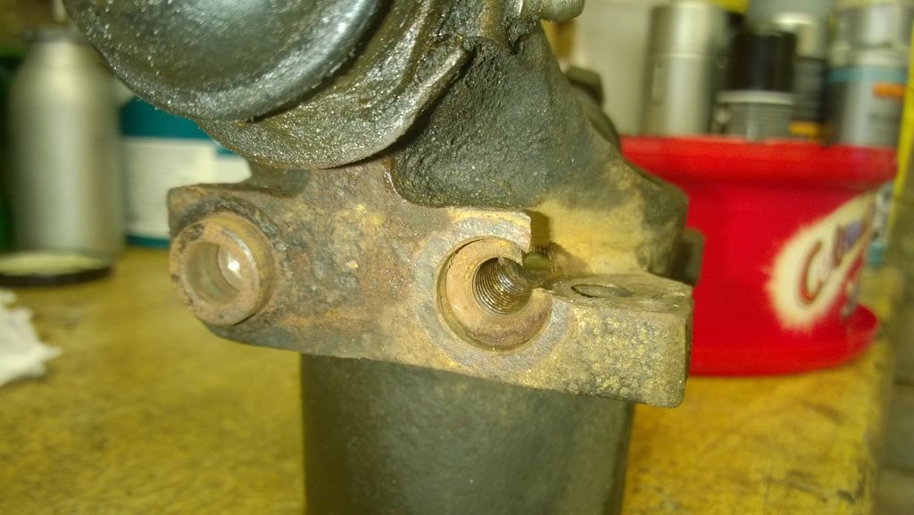

I had a set that looked just like that but with vented discs about 10 years ago, same cap head bolts holding the calipers on and modded to fit under 10's. I bought them 2nd hand and didn't realise at the time there should have been more than 1 bleed nipple, could never get them to bleed properly until I found the centre one had been ground flat to clear the wheels.
I ran a set of modded mini 8.4's for years, they'd had a lot of work and were noticeabley ground down on the outer edge though.

Thread revival I know, but seeing as I have finally taken them off, its fairly obvious what has been ground off to make them fit.
So new hubs, calipers, disks and ball joints are going on. I'm just worried I'll miss the feel of the 4 pots...
