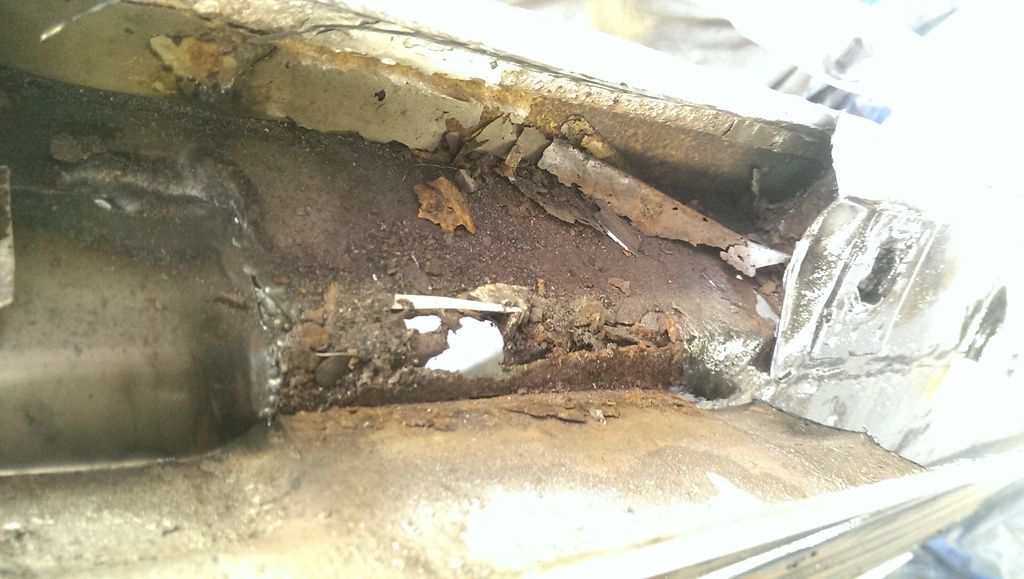

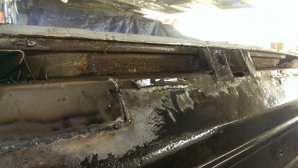

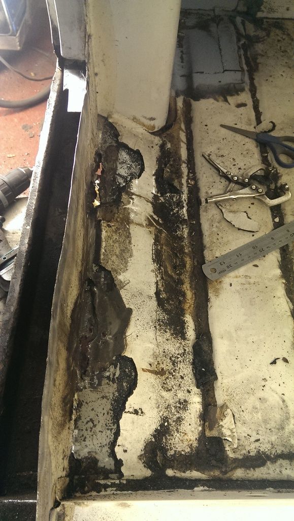

Done a bit more today, to start heres a picture of the passenger step i'd already patched
Had a poke around thursday night and got alittle disheartened as i thought i had done the floors but turns out the inner and outer drivers sill was all manky. Probably going to have to replace the whole sill now as its going to be to many patches and look rubbish.
Anyway this was the poking
Then manned up today and fixed the inner and then sorted out the door step after lots of faffing with door clearance
Still not welded the step to the sill as i reckon i'm going to replace it as its manky.
Heres my next piece of rot to deal with.
I'm hoping to get this sorted tomorrow but as usual its worse than i thought so going to take longer than first thought.

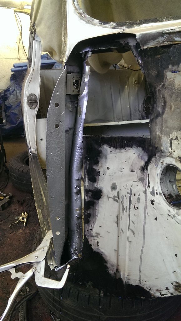

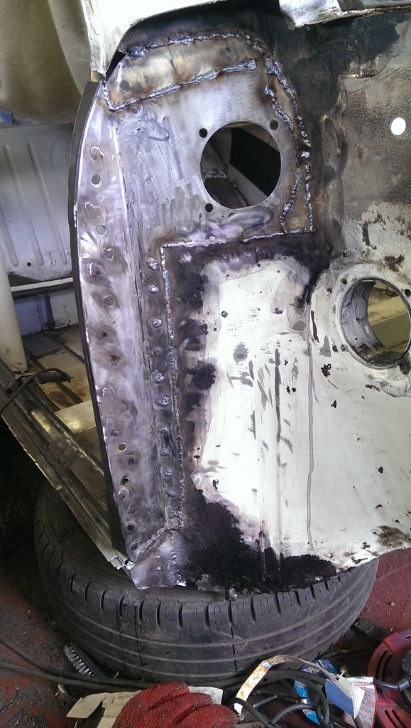

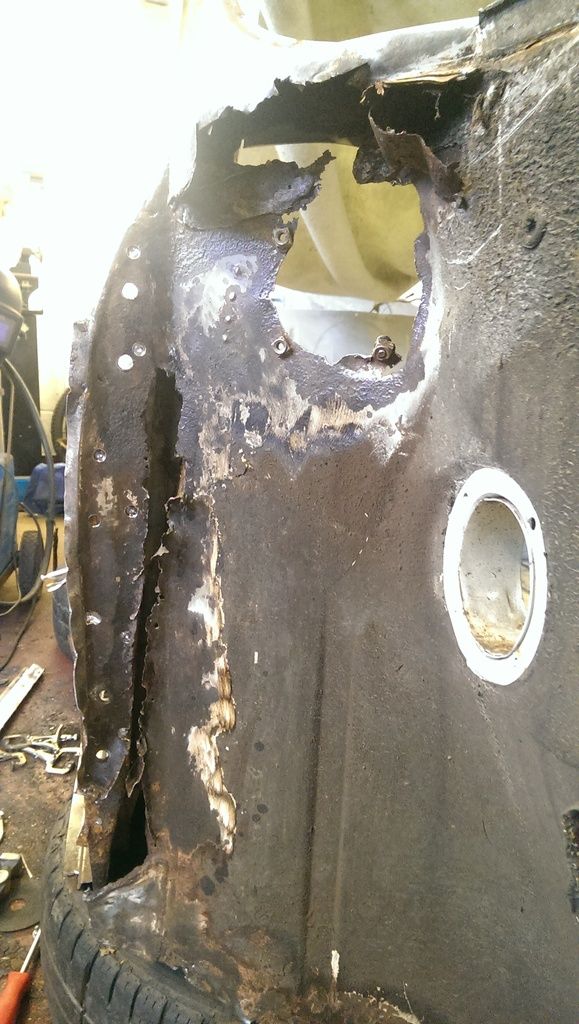

After a good poke about:

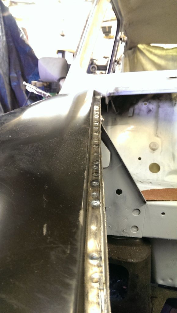

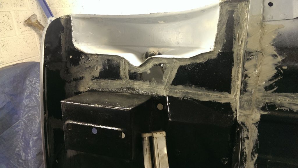

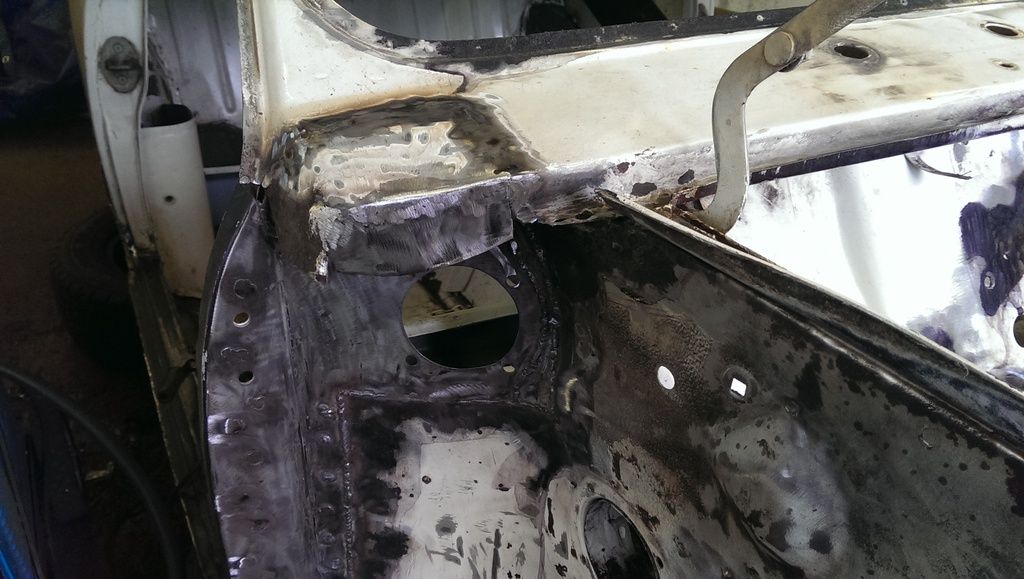

So started by cutting out all the rot on the flitch panel

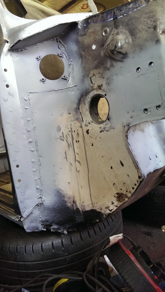

Cut new panel and welded it in tying in all the strengthening points
Rebuilt the scuttle where I had to cut it for access
Patched behind the shock mount and scuttle closing panel then a coat of paint
The welds look kack in the photos but they are pretty good in real life. Plenty of PENTRATION :) which is always a good thing.
Cleaned up most of the inner wings so going to sort the subframe out this week and hopefully get the front on over the weekend.

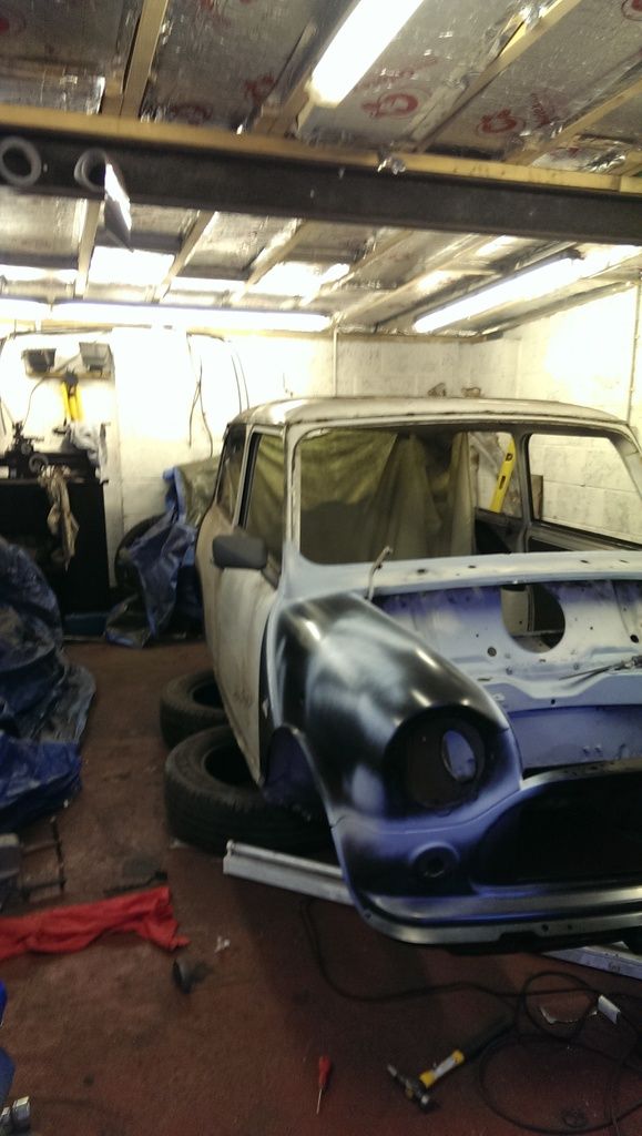

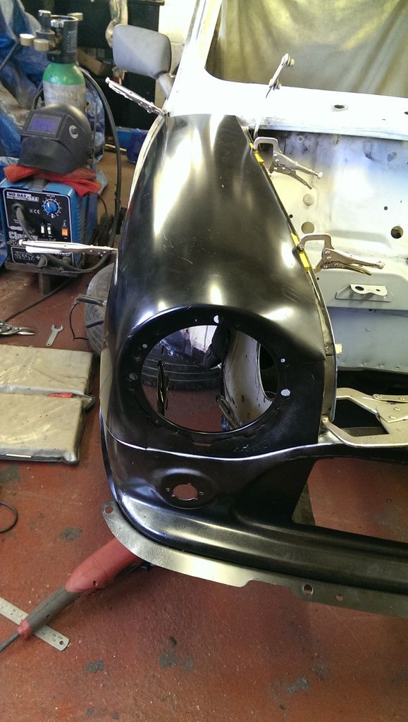

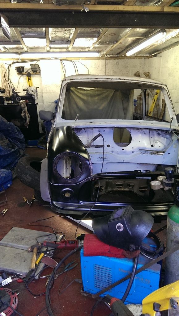

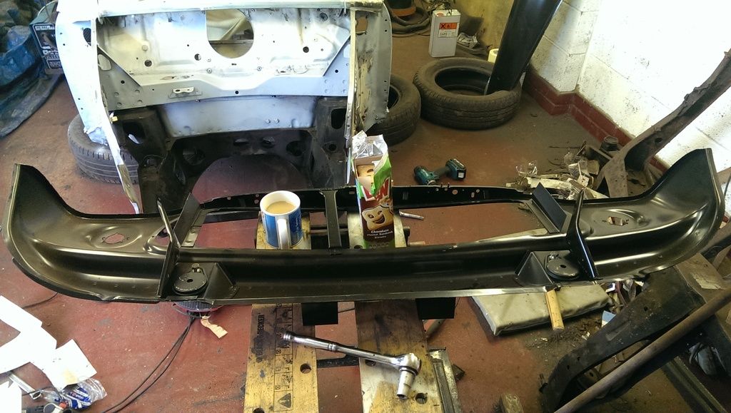

So todays adventures.

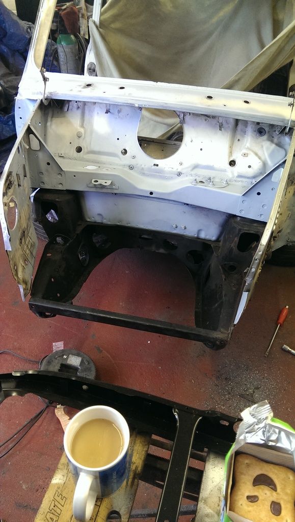

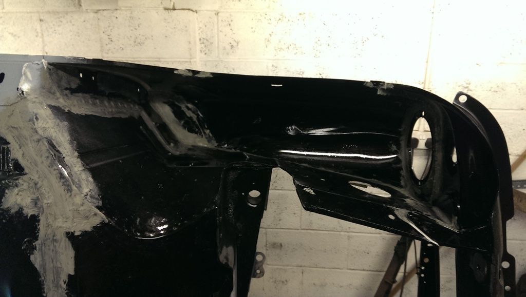

Started by getting the front subframe mounted nice and square.
The mounts bolted up to the front panel
About 2 hours of fettling and all the clamps i own
Cup of tea and a fresh set of eyes before i then started welding
Also managed to get hold of a spot welder which really sped things up
Lots more fettling and I finished up with this, banged on a coat of etch to protect it before paint
Started fitting the other side but got really tired, been at it for 7 hours so called it a night. Got most of the way there, just some slight adjusting before i can start welding.

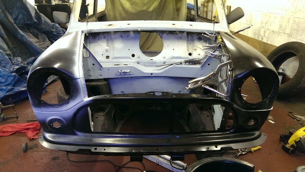

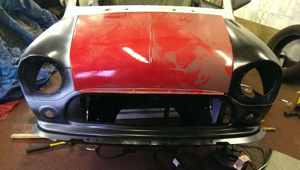

Did you try the bonnet on before welding the front on?
#28 Mad Max
Mad Max
  • 306 posts
  • Location: On a driveway under a car
Posted 29 March 2015 - 05:22 PM

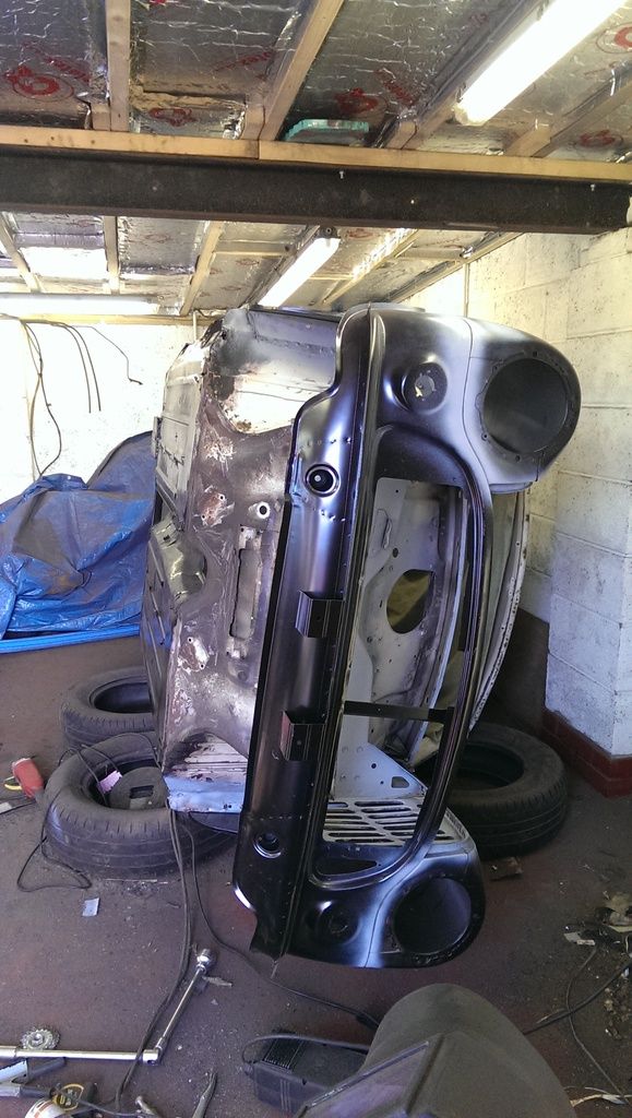

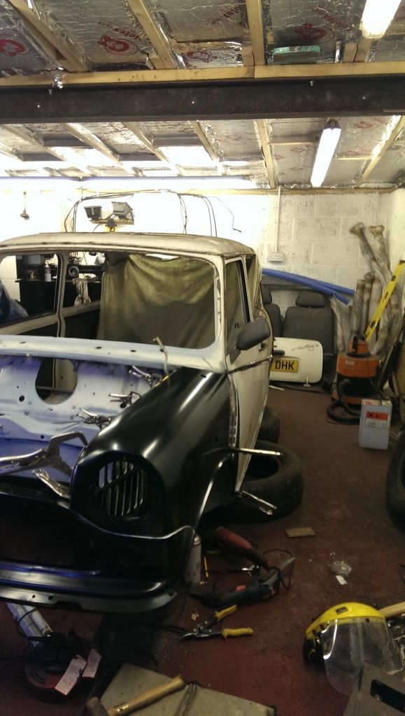

Yes i most certainly did. Its abit tricky juggling all the gaps, might have to take a slice out of the bonnet ether side to even up the panel gap. Its a tad narrow at the front but i couldn't pull the wings any further apart otherwise the gap opens at the wing/valance join.

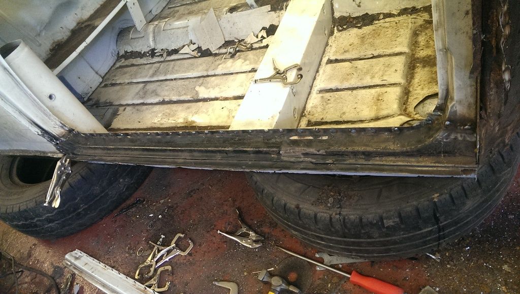

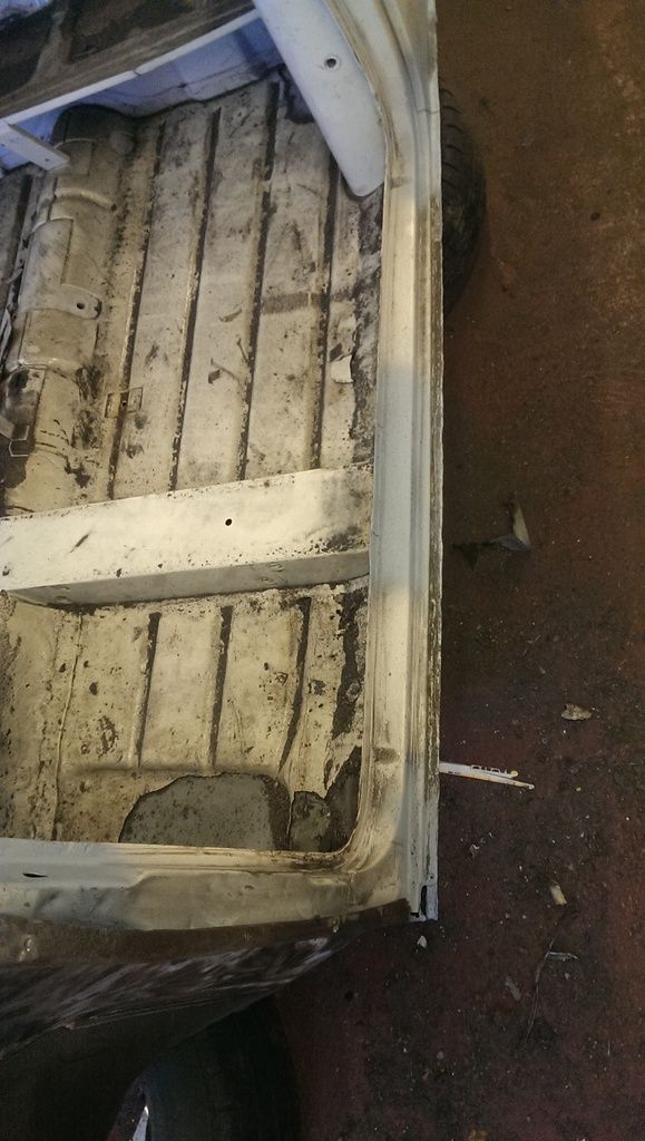

So after finishing the front stripped out subframe and doors and bent over A-panel flange, then rolled on its side to investigate the sill corrosion.
Abit of a state considering i thought i was nearly done with the floor.
So a couple of inner sill holes to sort before putting the sill on. Going to replace the other sill as well as there is bound to be rust there too.

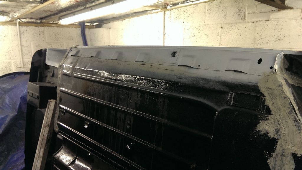

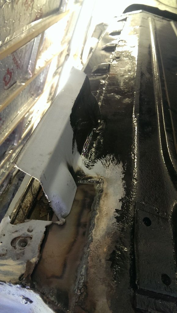

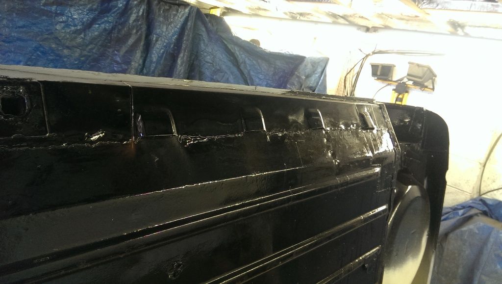

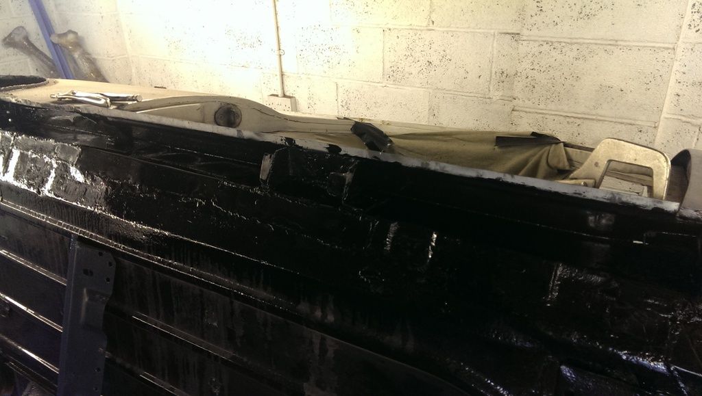

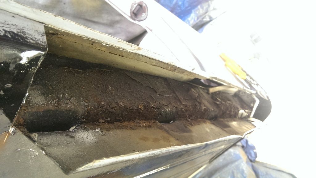

Been plugging away at the last bits of rust under the sills.

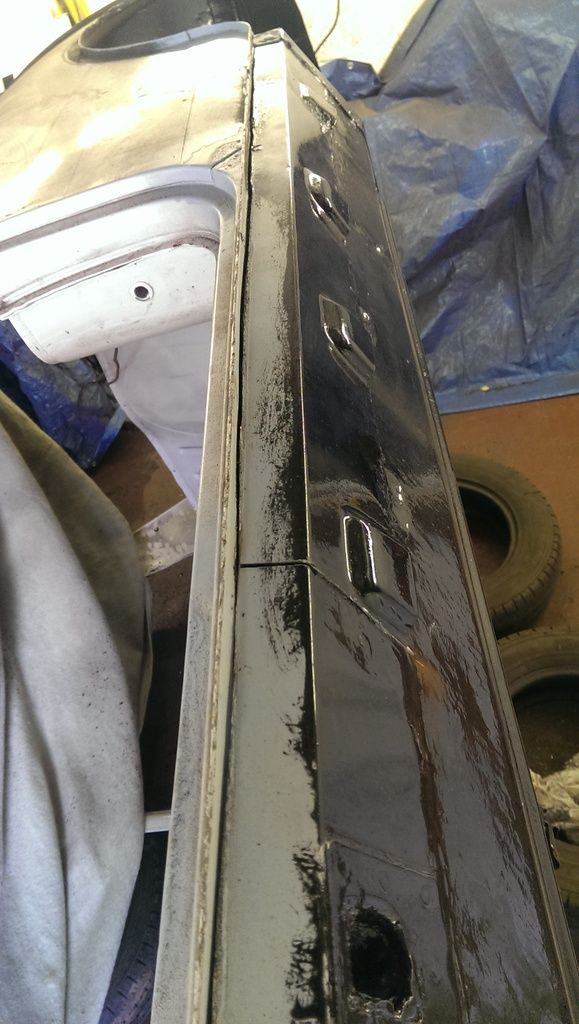

So carrying on with the drivers sill I sorted all the rust on the inners and gave it a generous coat of POR15 also painting under the wing.
Then welded the outer sill on after zinc priming the seams.
Seam sealed all the butt joins

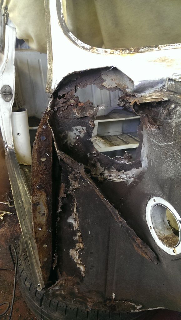

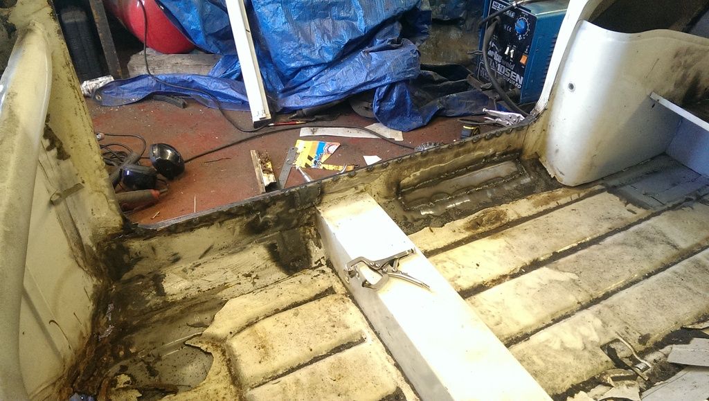

I've now started on the passenger sill.
So this is what it looks like, sitting there all deceptive
A few surgical cuts
A quick fold
What a surprise
