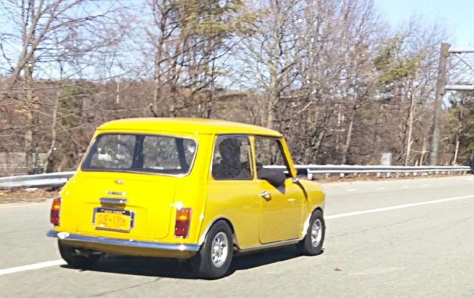

#40 mini-fvr
mini-fvr
  • 338 posts
  • Location: New York
  • Local Club: Long Island Mini Enthusiasts
Posted 04 April 2015 - 10:44 PM
Driving shoot today... Finally getting some nice weather!
[URL=http://s1336.photobucket.com/user/bpatanjo/media/Mobile%20Uploads/F1B5CFAA-A5B8-46F5-8BAA-110A945CFE82_zpslhffu83g.jpg.html]F1B5CFAA-A5B8-46F5-8BAA-110A945CFE82_zps[/URL
Just received a few parts today too! Hopefully get them installed this week!
#41 Vinay-RS
Vinay-RS
  • 2,115 posts
  • Location: Cape Town
Posted 05 April 2015 - 12:24 PM
That looks good, it sits really well on the road :)

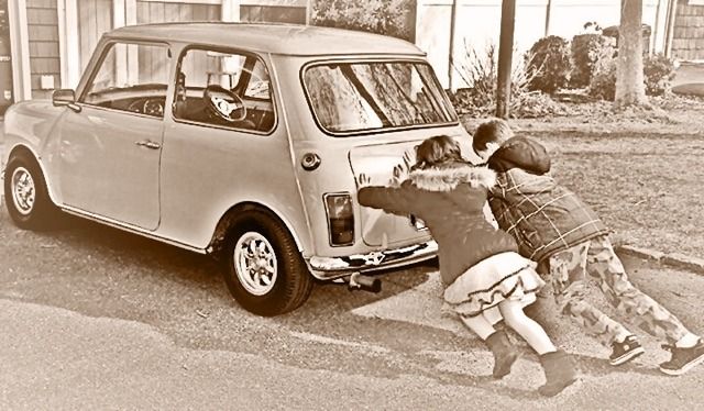

#43 mini-fvr
mini-fvr
  • 338 posts
Posted 07 April 2015 - 07:29 PM
My little helpers... Easter weekend :)
