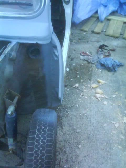

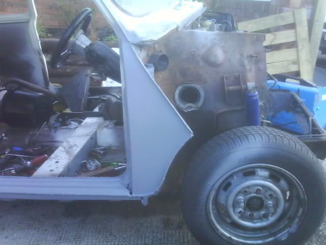

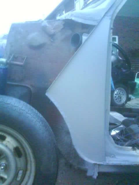

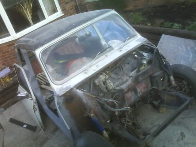

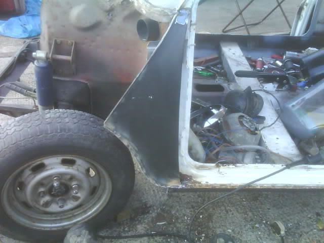

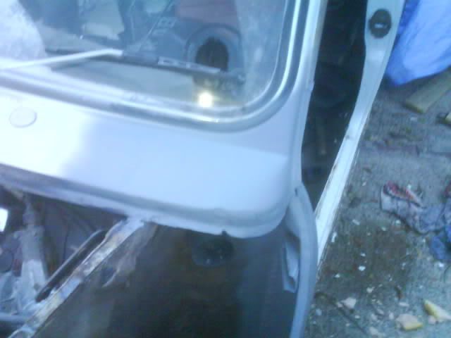

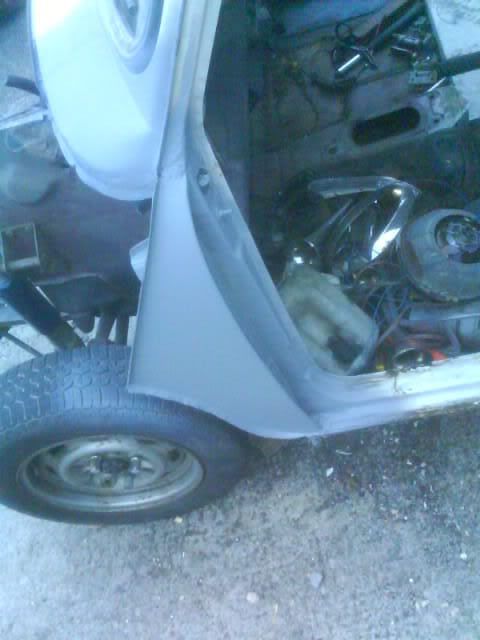

Anyways... project update!!
Welding is now finished!!!! well almost, only bit I've got to do is the mk1 light plates!
Apanels are a pain in the arse! spesh when you need to weld the mk1 inner apanel too!
One done... took me about 2 hours to get this one right!
Progress of the other side....
Underneth the filler... I found a surprise... the scuttle is ok! :w00t:
As she stands now... Look proud imo, bit like I am, the fact its mostly steel and not filler now :w00t:!
All that needs doing is, the Mk1 light plates, and a very small patch on the driver floor pan.
But other than welding, next job is to clean up the inside, I have some hammerite, and some thinners, I am going to give the inside a dose of hammerite, and then start to rebuild the inside!!!
Ordering a toad alarm system next month, so that will be fitted before I continue with the rebuilding of the interour!
But now shes in the garage, I cam properly strip her, subby off maybe next weekend, good clean up, lick of red paint, and then rebuild it... poly and metal mounts.
Once thats done, hopefully, I can look at getting the doors sorted, and drill the A panels and the doors ready for the hinges. then bit by bit, it'll start looking like a mini again! :w00t:

dog how do you know the A panels are welded in the right place with out fitting the doors ? :w00t:
#442 Dog
Dog
    Deathwish Fairy
  • 9,550 posts
  • Local Club: Shatrats.com
Posted 12 November 2006 - 07:55 PM
I was test fitting the doors as I went...
I have done the mk1 extruanl conversion, thats what the panel behind the A panel is...
So the next hard task is to send my doors off for repair, and then, drill the holes out, and fit the hinges...
Don't panic bungle I made sure I was 110% sure they were in the right places!

Yes its a great feeling knwoing that its steel!! and not bloody filler!
To think I almost scrapped it!
Just feeling that as each bit arrives it can go stright on, etc etc... Like jack said, I now have a blank steel canvas to play with now... I know how i want it, its getting there slowly :w00t:
