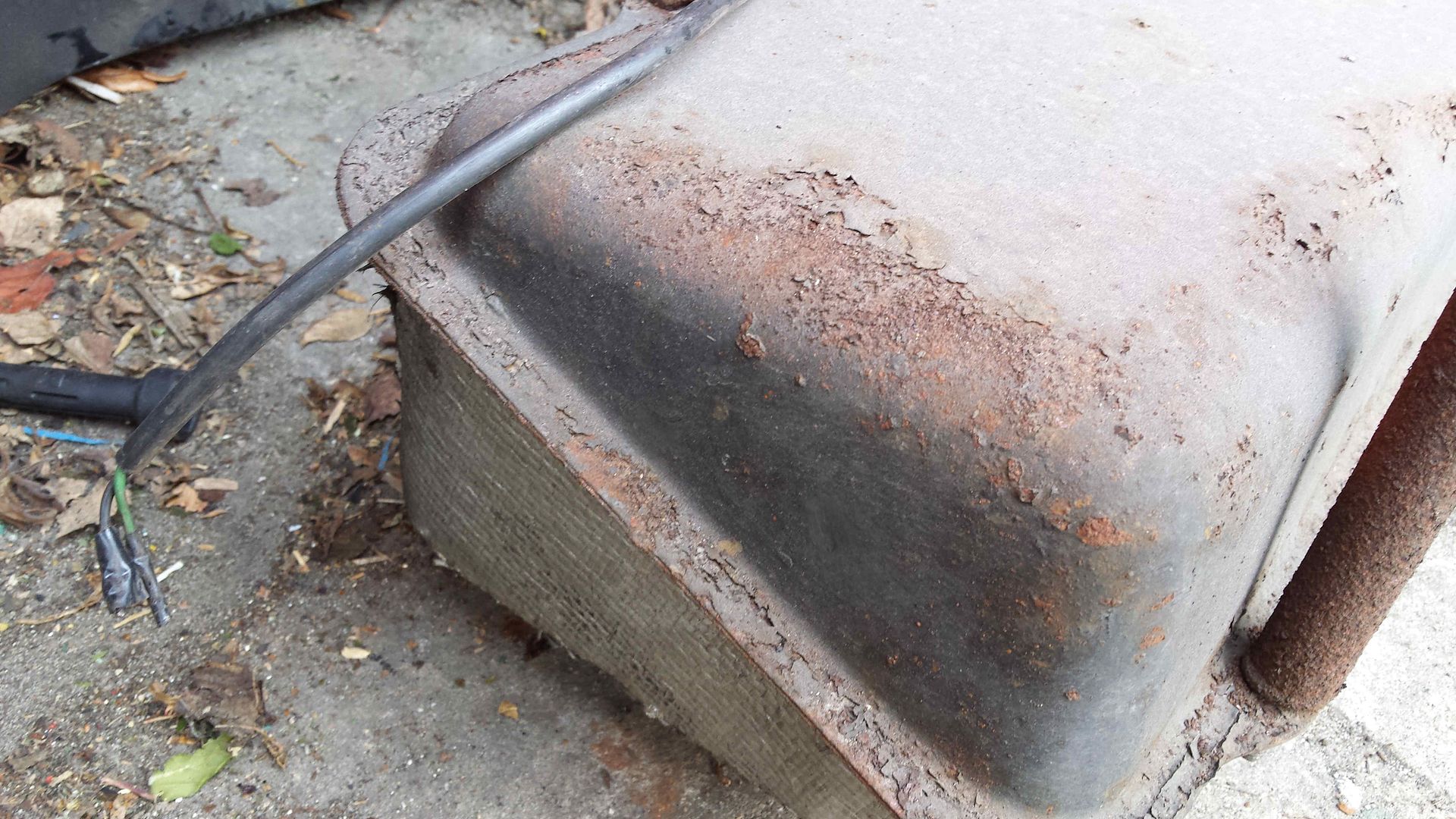

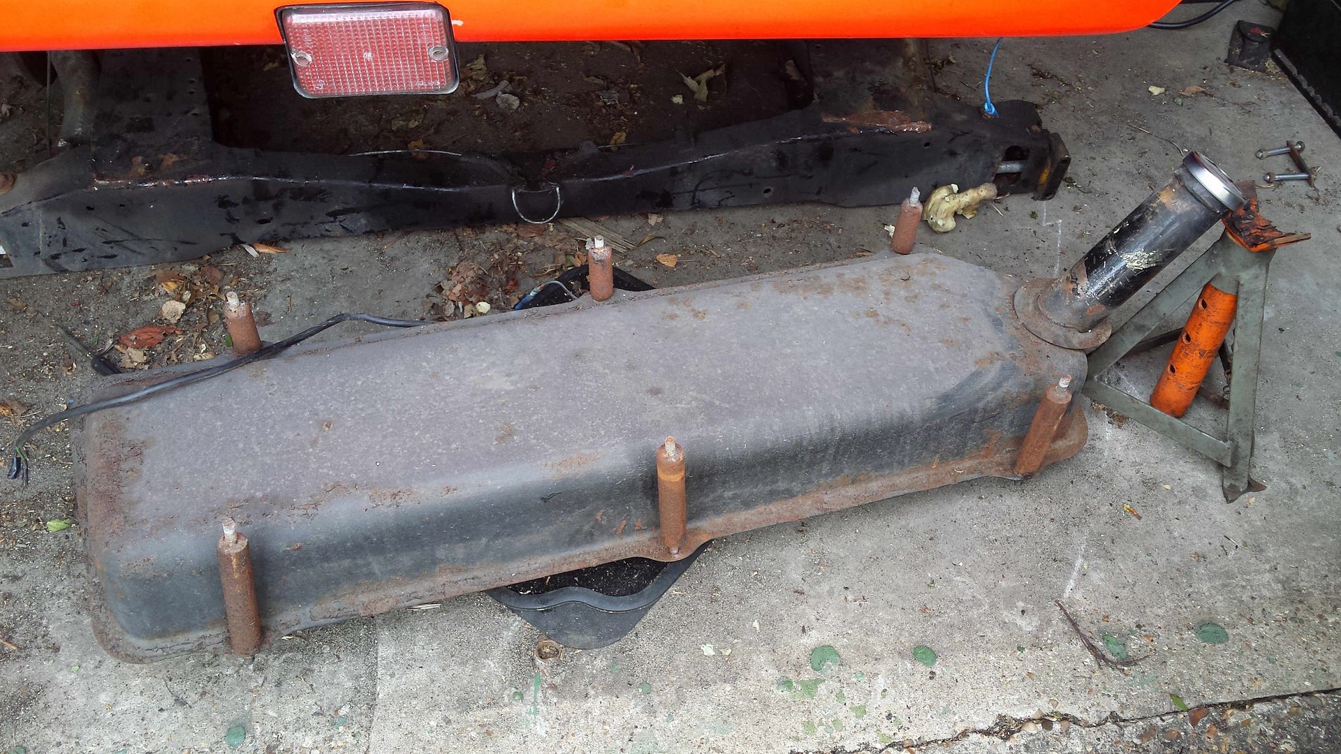

taken the fuel tank off
not to much rust just surface,
cleaned it up and rust treated it then painted black
more soon.

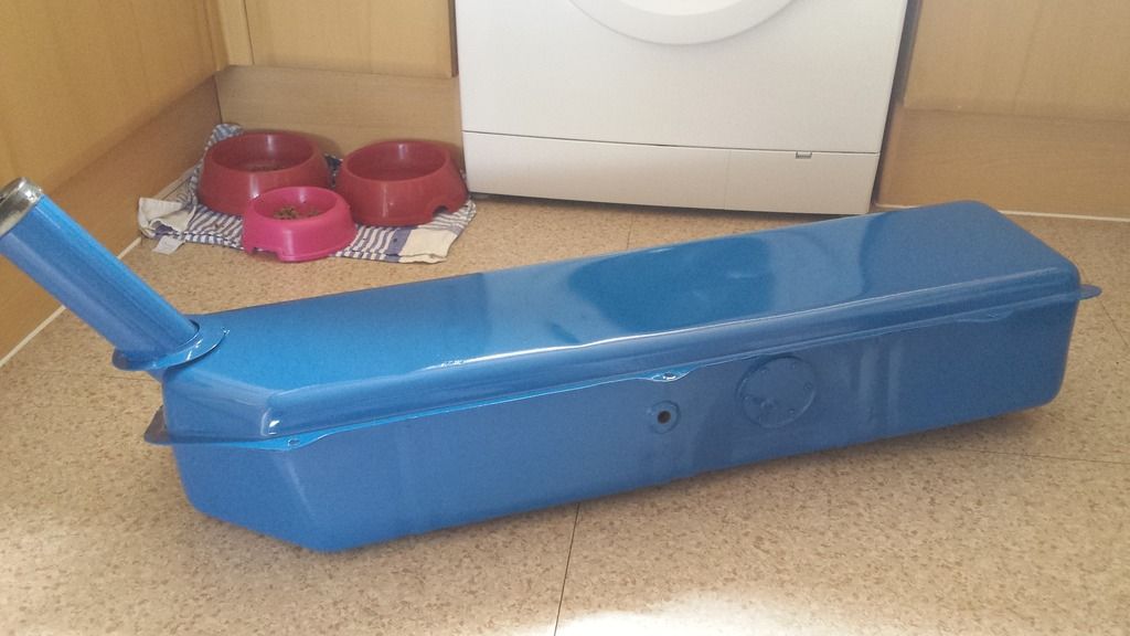

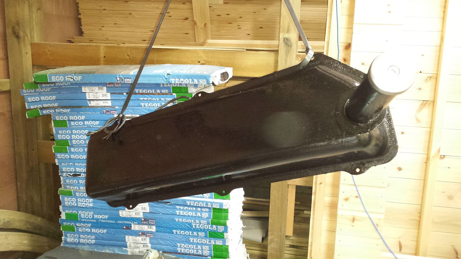

just ordered a nice new subframe, a bolt kit and adjustable camber and toe in kit now when it arrives i should have all the bits to send off for powder coating. Including the fuel tank as i decided that the black finiah sucked and if your doing a rebuild you beter do it right when you have the chance.

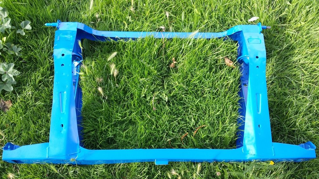

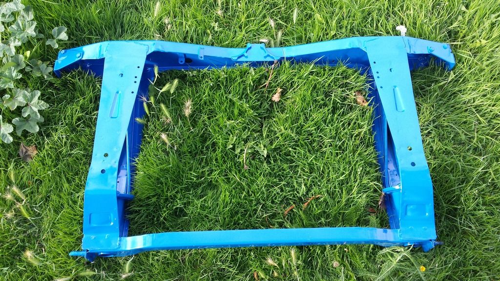

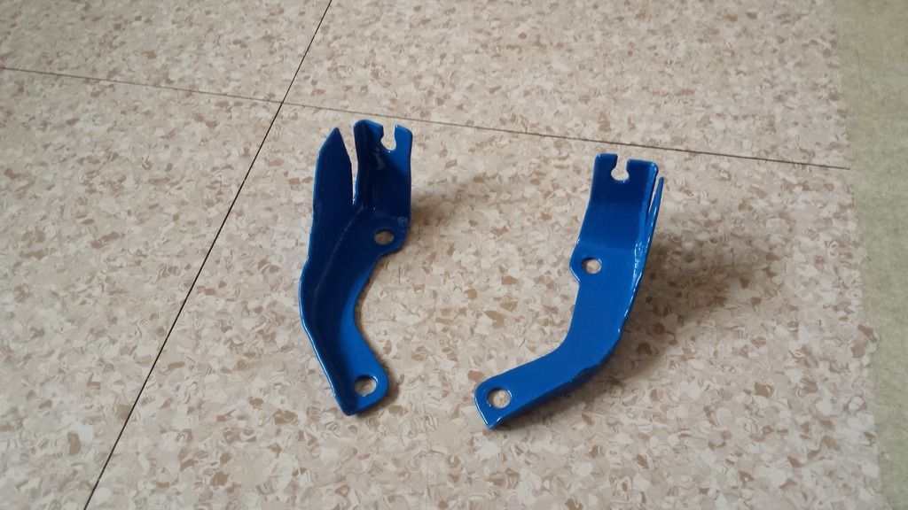

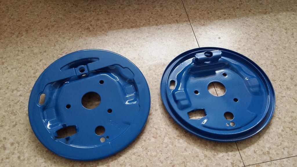

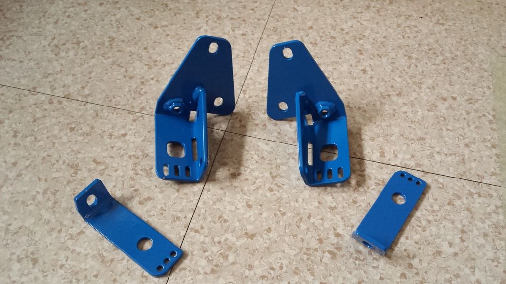

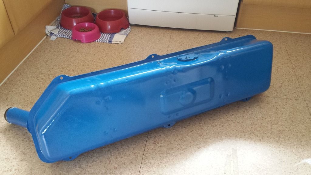

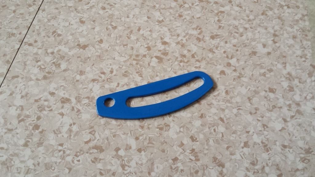

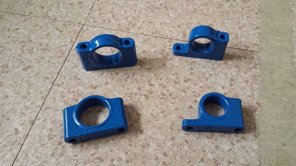

first update for a while
not done much been paying for stuff and waiting for a few thing before i could get moving again.

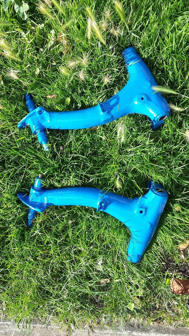

parts picked up from powder coaters
subframe
trailing arms
fuel tank take 2
drum back plates
handbrake cable bracket things :-)
alternator thing.
camber and toe brackets munus the bolt that seem to have vanished at the coaters.
subframe mounts
a few bits to order, clevis pins, quadrants and new 2 x pivot kits. then its time for the big build wahoo.
#19 Richie83
Richie83
  • 1,495 posts
  • Location: Somerset
Posted 05 September 2015 - 06:28 PM
Those parts look amazing. It's the little touches like that which make a car IMO. Was it expensive to get done?
Edited by Richie83, 05 September 2015 - 06:29 PM.
#20 swampy1978uk
swampy1978uk
  • 38 posts
  • Location: essex
Posted 05 September 2015 - 06:45 PM
no not too bad only £150 for everything above to be blasted and powder coated

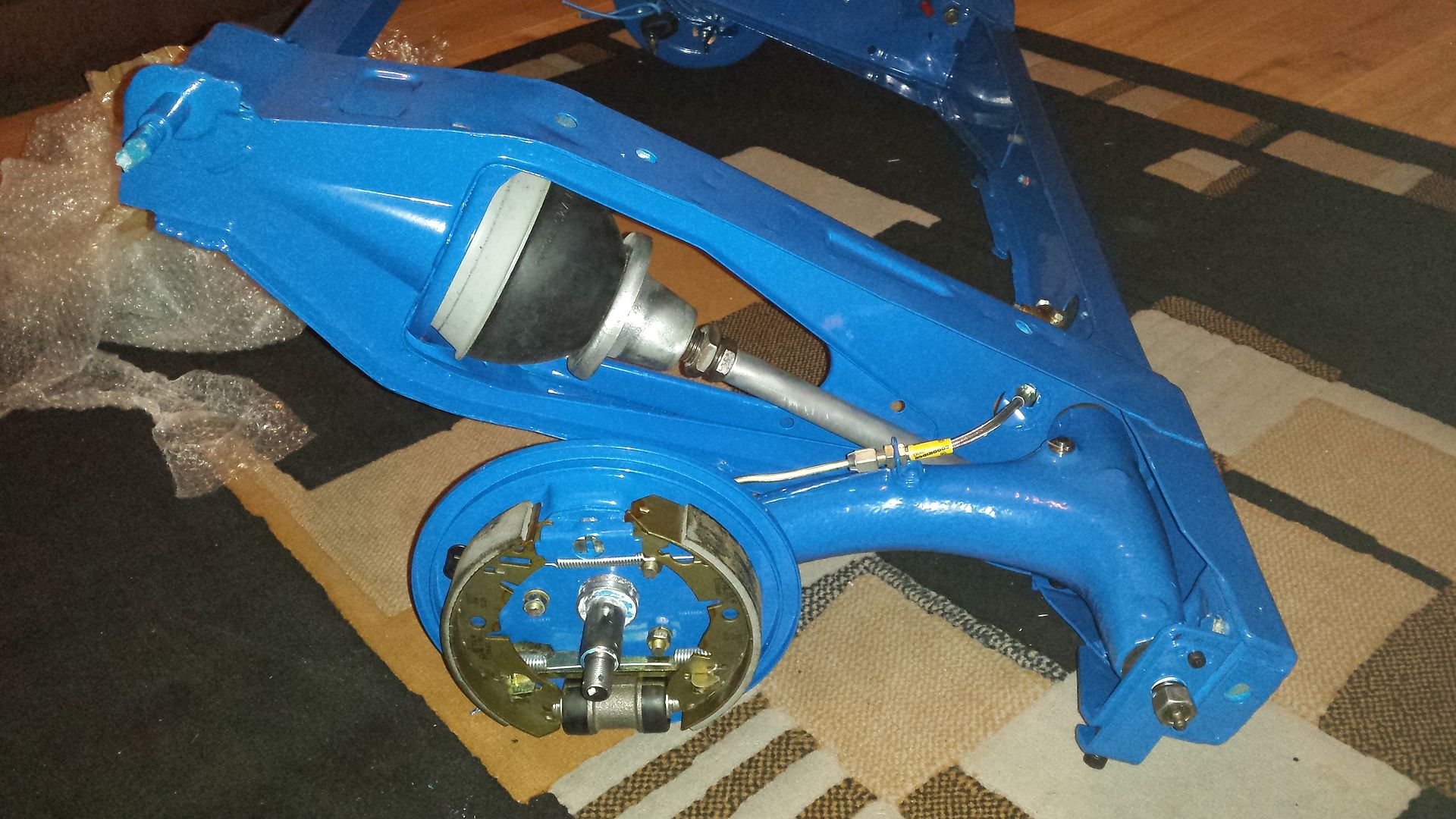

Posted 07 September 2015 - 09:53 PM

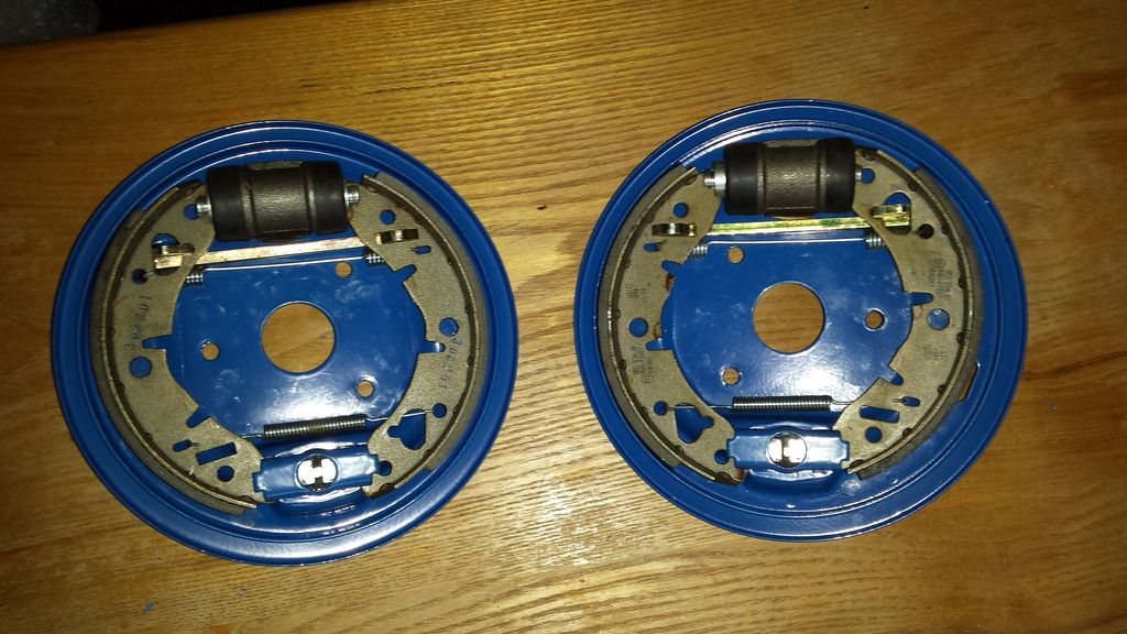

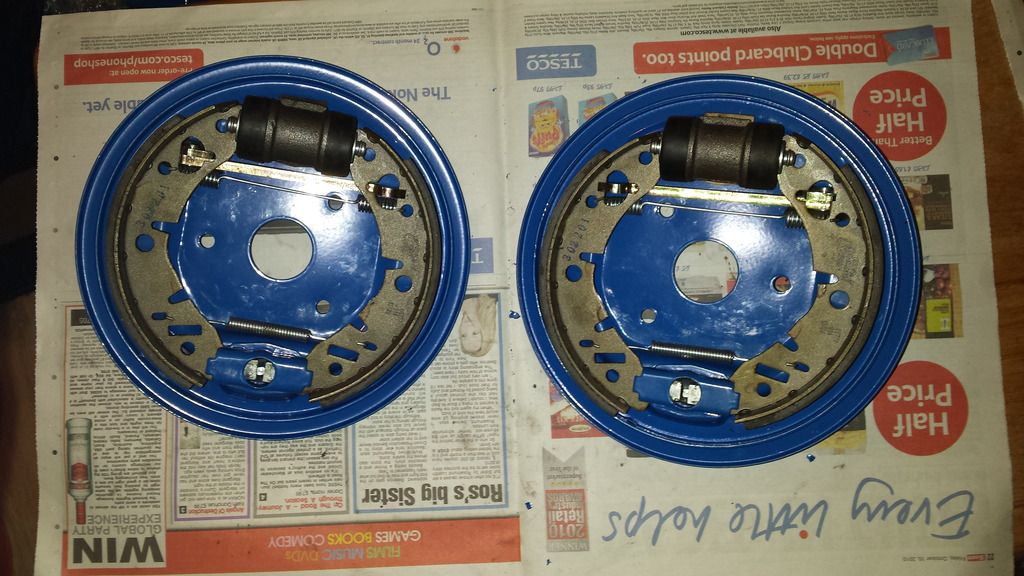

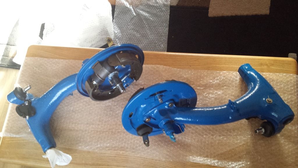

got my brakes back together.
think i got everything in the right (and left) place
if you spot anything i have done wrong please speak up as its all going back from memory.
note to self bung up threads before powder coating DOHHHHHHH
#23 phil hill
phil hill
  • 616 posts
  • Location: Lincoln, UK
Posted 08 September 2015 - 10:35 AM
One shoes is upside-down on each backplate.  I can't remember which though lol !!
I suspect the leading edge of each shoe should face the forward direction of travel, if you get my meaning.
Phil.
#24 swampy1978uk
swampy1978uk
  • 38 posts
  • Location: essex
Posted 08 September 2015 - 04:18 PM
Phil.
thanks phil
have just googles for pictures and you are correct
i think this is right now
thanks again.

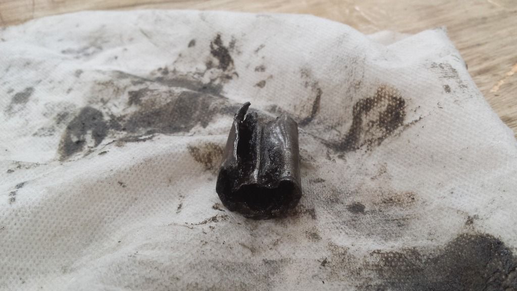

Posted 13 September 2015 - 05:08 PM
trailing arms back together just need the new bearing pressed in, they should arive tomorrow.
found this inside one.
and that wasn't even the bearing i was knocking out someone had left it inside.

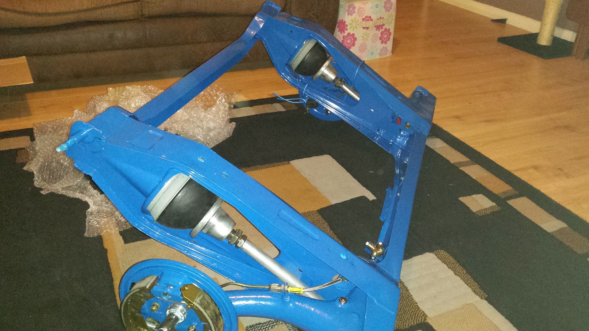

Posted 17 September 2015 - 10:29 PM
got a bit more done tonight
you know its bad when you clean your spanners before touching the shiny parts
just a couple of brake lines and a stubborn bolt that needs some fettling but not at 11:30 in my front room  :lol:
then hopeful get it back on this weekend and i can spin it round and start from the other end again.
Edited by swampy1978uk, 17 September 2015 - 10:30 PM.
#27 GraemeC
GraemeC
  • 7,440 posts
  • Location: Carnforth
Posted 18 September 2015 - 08:21 AM
Very nice, but I think you'll have to strip half of that back down again to put the front trunnions on :unsure:
#28 swampy1978uk
swampy1978uk
  • 38 posts
  • Location: essex
Posted 18 September 2015 - 09:09 AM
Thanks very pleased with the look. I thought about them just after i started packing tools away and was worried i might have to do that. I do hope not it was a dog to get the camber brackets lined up with the subframe holes.
