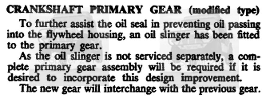

#10 Spider
Spider
  • 15,238 posts
  • Location: NSW
Posted 07 July 2015 - 09:44 PM
As Carbon hs said, early cars didn't have them, but good idea to have one there.
A 998 and a 1275 slinger will inter-change, even A and A+ - they were all the same.
You can remove it, 'panel beat it' true again and re-fit it. Even if it's not 100% true, don't loose any sleep over it, just be sure that it's clear of the seal when all fitted up.
#11 Spider
Spider
  • 15,238 posts
  • Location: NSW
Posted 08 July 2015 - 08:06 AM
Here's the factory low-down on the slinger (not much help I know, but maybe of interest)

If it's bent remove it....
The rear (clutch) seal should not touch it at all...
Most, if not all, Straight cut primary gears don't have it...
If you do refit it, make sure you don't block the oil holes with it.

If I don't replace it, is it likely to cause any problems with oil coming past the clutch seal?
#15 nicklouse
nicklouse
  • 18,751 posts
  • Location: Not Yorkshire
Posted 08 July 2015 - 01:41 PM
not really it just helps the seal not to quite as much work.
