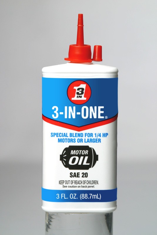

EDIT:  I think I mentioned in a previous post that people use everything from WD-40 to gear oil in their SU carbs.  The 10W40 should be fine for starting off with.  Don't worry about finding straight 20W oil at this time.  If you do want to try straight 20W in the future, you can buy it in expensive bottles from Burlen (the current owner of SU) and/or you can look for 3-in-1 oil.  Regular 3-in-1 with the black label is straight 30W, the blue label oil is 20W.
