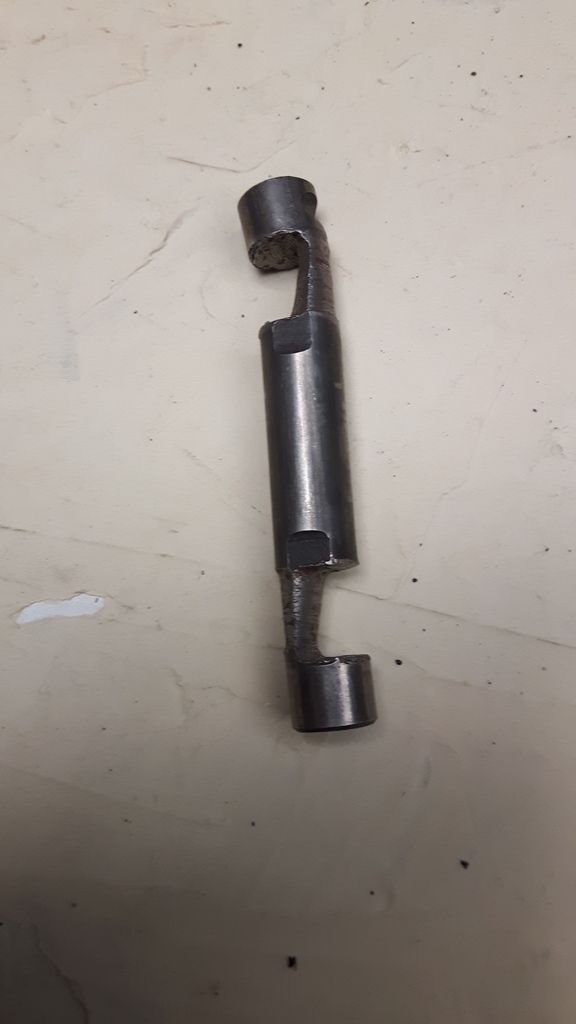

When first I built my 1293 Cooper 'S' rally car I fitted a single competition diff pin. This is what happened. I thought there was a bit of a clonk towards the end of the rally, but it still did some final speed tests. I guess I was very lucky and I've never seen a diff pin this worn which hadn't snapped before.
After this I fitted a cross pin diff, but managed to shear one of the pins and had to replace even that!

Looks like whats left of a 22g2583  Tuftrided Rover pin to me as it has the flats machined for lubrication unlike the MS comp pin c-bta164.
The sheer strength of the material used is very impressive not to have snapped, shame about its wear characteristics.
The bushed planet wheels are said to do this to treated pins, was this the case ?

Then I fitted a cross-pin and managed to spin the inside front wheel at a tight hairpin with a big drop off on the outside. I had to floor it in 1st to keep it from going over the edge (again!) and pulled around 7500 rpm with the inside wheel spinning. That friction-welded a planet wheel onto one of 1/4 pins and the steering went very stiff. We decided to carry on and suddenly the steering freed off and the car drove fine. The pin had sheared and was revolving in the diff housing. It carried on for the rest of the rally, a further 250 miles, and we won outright.
I thought I should see what had happened as it was clear there had been a problem. I had to put the diff in a lathe and part off the casing to get the output shafts out.

Looks like whats left of a 22g2583  Tuftrided Rover pin to me as it has the flats machined for lubrication.
It was a long time ago, but that sounds like the what must have happened. Sure was almost a non-finish on that event, but not quite. We got a good result at the end.

 diff pin.
Seems an odd place to find a crankshaft down in the diff :D
