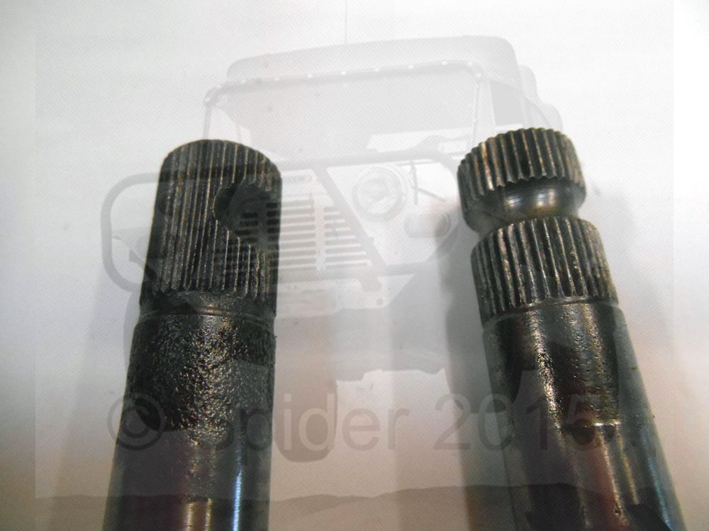

Does the bolt at the end of the column just slide in or does it have to be hammered to go in?
When it's all lined up, it will slide in.
Some of the racks only have a scallop out of the Pinion for the bolt to go in, others have a machined groove right the way around. The former, you do need to line up the column so when it drops over the Pinion, it lines up with the scallop. With the later, the Column can go on any way, though a good idea to line it up with the wheels in the straight ahead position and the Indicator Canceller in the right orientation.
Ignore for the moment that these are past their used-by, these are the two types of Pinions;

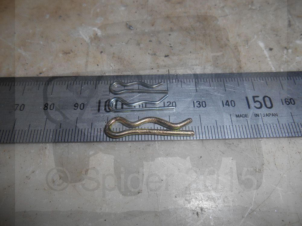

Do NOT use an R-pin to secure the brake pedal clevis pin. Always use a correctly secured clevis pin. Rover fitted them for a short time in 1990 and there were some brake failures as a result of the R-pin being pushed out. A recall was organised and a Service Bulletin issued to revert to original split pin. The tolerance build up can result in the pin catching on the body and being pushed out. In effect it is hit and miss whether it occurs. Therefore the SAFEST option is to use a standard split pin.
The only way an R clip can come out is either the wrong size, or incorrectly fitted.
They were fitted as standard in some markets.
...or be pushed out which was identified as the root cause of this happening to minis built in Longbridge in 1980. The build up of tolerances in production resulted in the r-clip contacting the bodywork disengaging the r-clip and then it worked its way out.
Sledgehammer , yes the problem was identified in 1980 so was earlier. Some cars leaving the line suffered brake failure due to this, so the Service bulletin was issued, production reverted to split pin. I was project engineer for Small car development when this occurred.
As the tools got older and older, assembly problems and service problems increased over the life of the mini.
As this item is clearly Safety Critical, So I re-iterate my Safety warning. A correctly fitted appropriate diameter split pin is more secure.
Some R Clips that have been sold to me over the years for this application;-
The top 2 Clips here are OK and quite safe to fit. The very top one is that that was used in our Local Production, the next down being those from Somerfords. Overall length of these is 20 and 22 mm respectively.
The lower one came from a local supplier, it's 27 mm long and, as I did find out, will pop out.
If they make you nervous, then don't fit them. Every car I've owned has had them from the factory and I'm happy to run with the right ones.

Moke spider, your picture of the various R pins perfectly illustrates the potential danger of "just fit an R pin advice" without confirming the detailed engineering specification and actual measurement of the applied condition.
Thanks for illustrating it so well.
