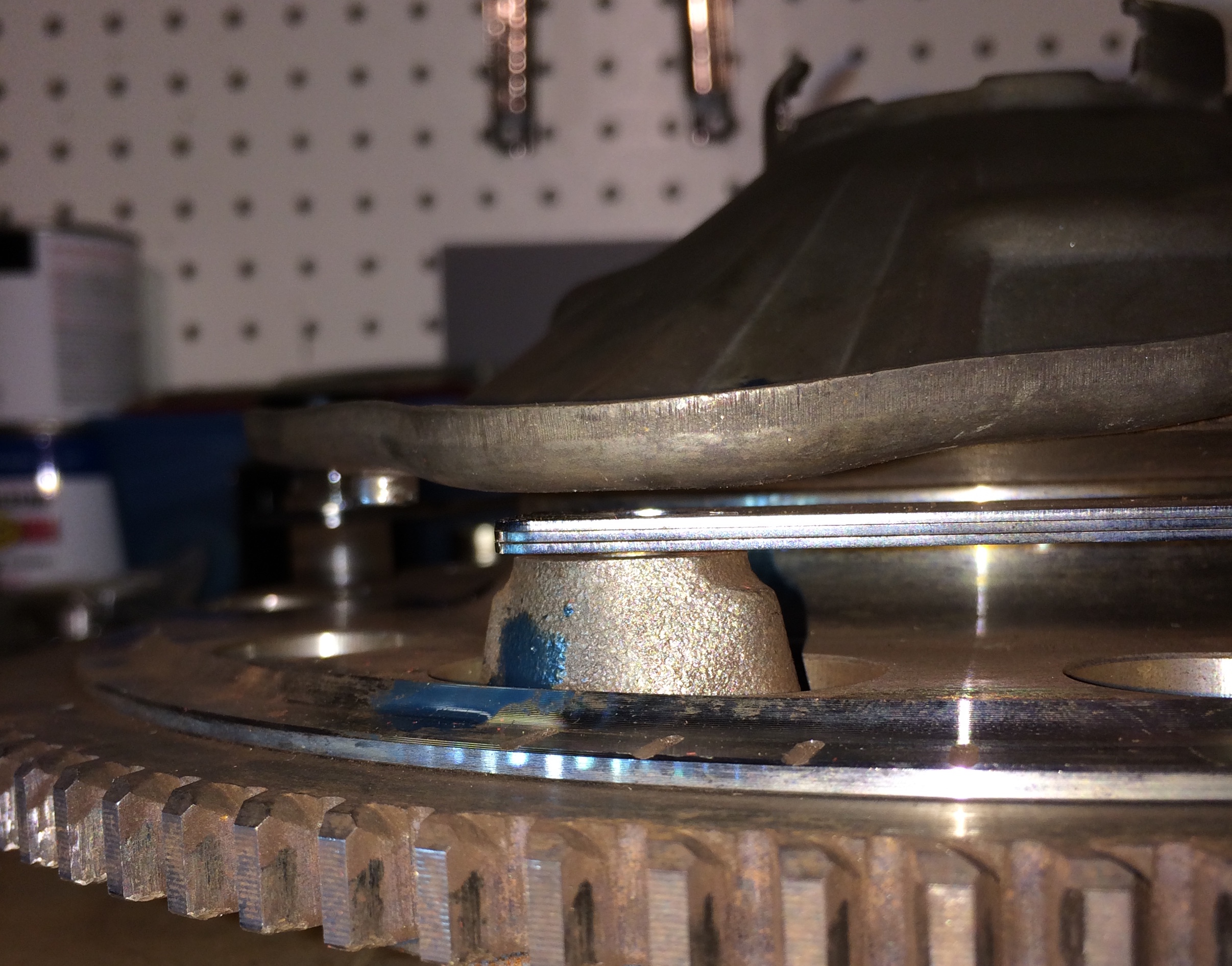

Folks,
Removed the flywheel today to fit a new clutch. Putting it all back together I'm now questioning if it was assembled correctly in the first place. Question really relates to drive straps and also the diaphragm plate/spring. Take a look at the first photo below...
That's taken with the backplate supported off my workbench, new friction plate sitting on top of it, then the flywheel resting on top of that. You'll see a gap between the backplate post and the drive strap (approx 0.8mm ... almost the thickness of a single drive strap). I understand that the gap should be zero, so do I:
a) add 0.8mm thick washer in the gap, or
b) do I machine down the 3/8" spacer that's bolting the other end of the drive strap to the flywheel... or
c) is either method OK?

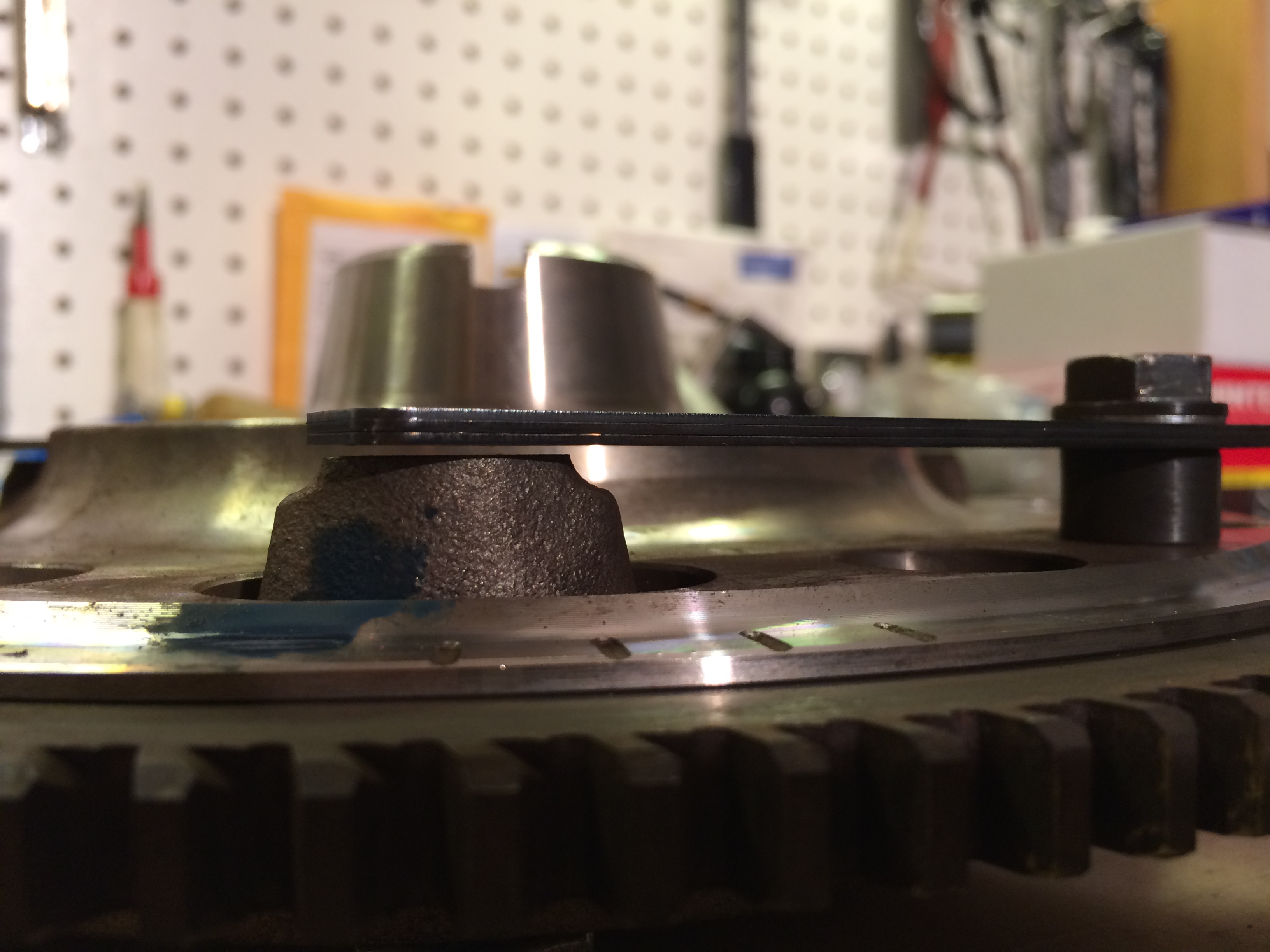

Or shouldn't I be thinking about setting the above until I've looked at the assembly with the diaphragm spring/housing sitting on top of it (see 2nd photo)?
There's a gap of approx 2mm between the top of the drive strap and diaphragm housing. I'm guessing that's too small (even if I took into account the other .8mm under the strap that a total of <3mm ).
Now here's the bit I've never fully understood... am I correct in thinking that when this assembly is bolted together that diaphragm spring should be compressed so that it is no longer conical, instead flattened so that is is parallel with the flywheel face. Yes? If so then I guess that's why I've seen a video and a few posts with the assembly in a pillar press and using a DTI gauge to measure how much movement is needed to 'make things flat'.
Eyeballing my diaphragm spring it looks like it would take 4mm compression to flatten it. If that's the case then it won't be fully flat when I clamp this assembly together ('because there's <3mm gap in my assembly).
So... if the above is sound reasoning on my behalf, then should I machine down the backplate posts, or use only 2 drive straps per post (currently using 3 but going to 2 might make the gap big enough???), or should I be doing something else?
And if it's of any relevance it's a 9.5lb lightweight flywheel, AP Road/Rally clutch plate, standard back plate, orange diaphragm spring, 1380cc/90+bhp, 3.44cwp.
   Cheers,
   Colin.

Checks must be made with the assembly bolted together as the fiction disc compresses when clamped up. I am for flat diaphragm and straps when all bolted up. Adding extra drive straps changes the diaphragm position by a lot. getting this wrong results in wiped out crank washers and an unnecessarily heavy clutch.
I do not agree with most of the responses above.
I did a miniworld tech article on this a few years back.
http://www.minimania...FAQ__non_Verto_
AC

AC ... That's the very video that made me start thinking about about this! At the time I did't fully understand exactly what was being done - especially how the diaphragm could be set to flat in that press if the posts were still too tall. But looking at that video for the umpteenth time it looks like the flywheel is resting on the 'lips' of the press table and the backplate is free to move below it - correct???
So would my conclusions be correct?...
  1. back plate post height determines how much the diaphragm is flattened (i.e. add/remove heigh so that it is flat when the fly/clutch/backplate/straps are all bolted together)
  2. drive straps should be flat otherwise you run the risk of a hard-to-disengage dragging clutch (in my case I should remove material from the spacers)
Correct?

Yes the back plate is free to move in the video.
1. Yes the backplate post height determines the flatness of the diaphragm
2. Not sure about hard to disengage or dragging clutch, bit can cause clutch slip in use. Flat is what to aim for
Look at the minimania link for a en excellent investigation piece performed many years ago which explains why the diaphragm needs to be flat
Just to add, every one I build is wrong and needs adjusting.

AC - Thanks for the reply. I measured my mine up this evening and looks like I need to remove 85thou from the post to get the diaphragm flat. Hoping to get it on a lathe at work before the end of this week.
