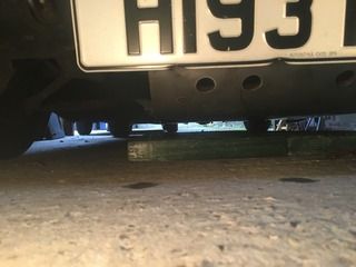

Hi All,
Ben has sent me the photo
Attached File  P1010345 (002).jpg   53.63K   11 downloads
looks like 4x2 and that's not cockney rhyming slang for what I think of it :ohno:  but the size of the timber supporting the sump guard

You can see that the sump guard will sit a little higher once bolted as it is resting on the wood. you would gain another 1/2 inch or so.

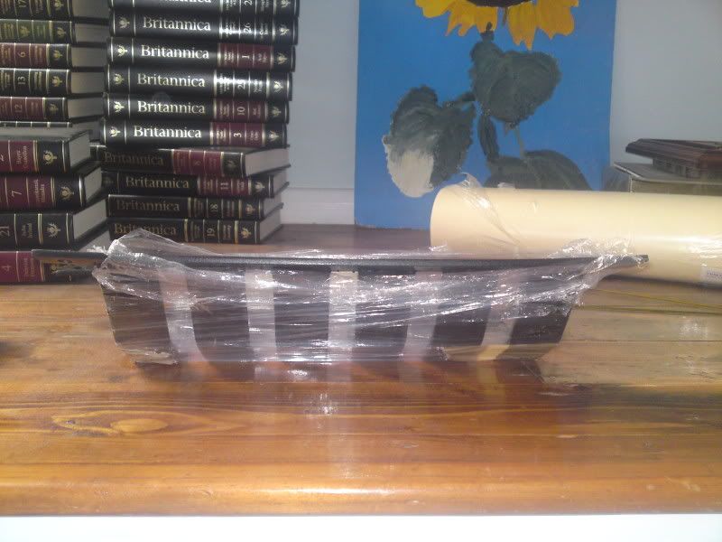

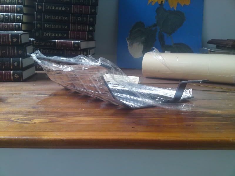

IVe got an innocenti style sumpguard fitted to Vini
http://minispares.co...|Back to search
pics when i got it
i dont seem to have pics of it fitted
YetI
