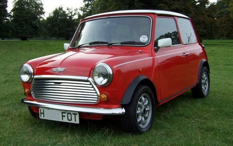

I know what you mean, but I think it'll look a little better. And I'll be happy not to have to swap the wheels over every year.
EDIT: just noticed the red Mini in the header at the top of this page. It looks like it has the same arches as mine, and that's the look I'm trying to achieve.

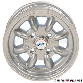

These are the wheels I ordered (and presumably are the ones I received):

the red car at the top of the forum is fitted with the rover 4.5 x 12 wheels that are standard fitment on the Coopers and later mayfairs and many of the limited edition minis.
your 165 tyres on these rims would give the look you want.
Yes, that's exactly what I'm looking for, and was hoping to get with the 5x12 wheels.

Another thought - my wheels apparently have an offset of ET14. I see that other similar replica wheels have an offset of ET31 - am I correct in thinking that they would bring the wheel 17mm further inside the arch?

It's the distance from the wheel's centreline  to the face that sits against the hub. If the wheel is marked ET 14 it'll sit 16mm further inside the arch than ET0. ET-14 (negative offset) will sit further out. So yes, ET31 sticks out 17mm less than ET14.
If the wheels are brand new, surely the sensible thing is to swap them while you can. Though take the opportunity to check the inboard clearance to avoid swapping sticky out wheels for ones that rub.

Yes, I'm sure it's the offset. Having spent all morning looking at other pics on cars with the same arches as mine, and also with similar-looking 5" rims, I was confused as to how the others looked fine, but mine didn't.
It seems that standard "Minilikes" have an offset of around 31, whereas those described sometimes as "deep dish" have an offset of around 14. I've just measured my car and that 17mm will make all the difference. Unfortunately, Minispares makes no mention of the offset on the product page for the wheels I bought, so it seems it's a case of caveat emptor.
Because I've fitted the wheels (although they haven't moved an inch), Minispares considers them second-hand and isn't interested in helping me, so not much to do but shop elsewhere and try to sell on the Minispares wheels in due course. It'll be an expensive lesson, but there you go :(
