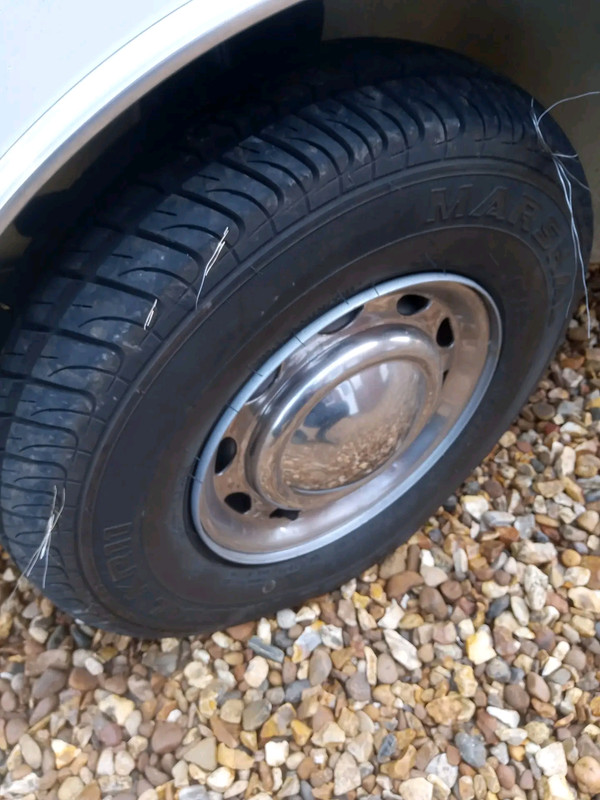

Posted 19 May 2022 - 08:36 AM
Posted on my local clubs Facebook page. The same Marshal KR11 after 400 miles.
#29 sonscar
sonscar
  • 3,047 posts
  • Location: crowle
Posted 19 May 2022 - 11:10 AM
So if it looked like that at 400 miles how did it fail after 700?It had already failed,Steve..
