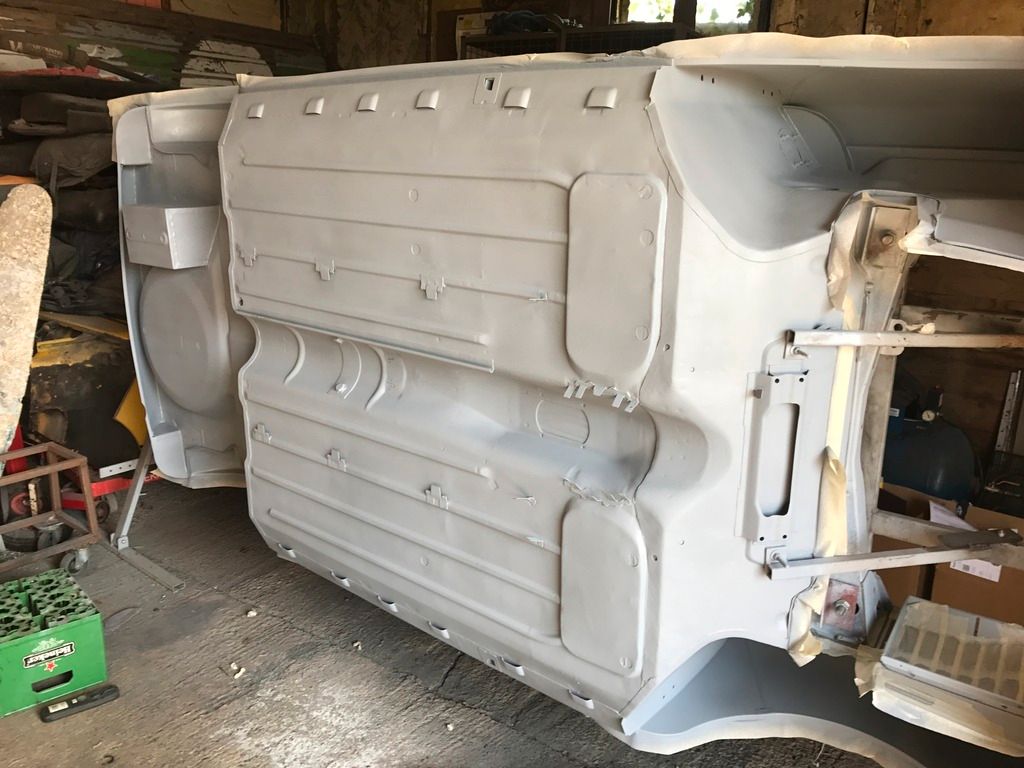

I would like to have it as one uniform finish and noticed I could buy Red Schutz cheaply on eBay. Seems the perfect solution to me as the mini is no show queen, But I'd like it to be somewhat colour coded on the underside. I'd like to avoid the hammerite/waxoil you can get in an aerosol.
Without a compressor, I'm wondering how I would be able to spray it thickly enough. Has anybody come up with a handy DIY solution? Would a Fence sprayer manage if it was thinned adequately,.. would it be too thin to build a nice layer? What about hand sprayers?
Or is there a suitable product out there I haven't managed to find yet? It would be nice to have it red to match (roughly) with the bodywork.
