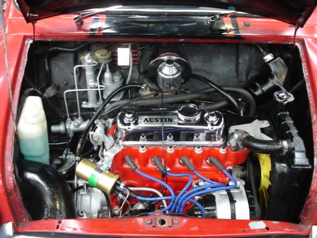

thanks - but strange - my car is 1984 and its original panel didn't have this nut - typical that  I can't find any pictures of the this before I took the car apart....12 years ago :-)
you're is obviously a newer car (given your inner wing) - I found this picture of an engine bay which looks closer to min - here the reservoir is mounted directly to the x member
http://www.theminifo...decb40aef01.jpg
I wonder if this is a later change?

Brake pipes master cylinder to PDWA are wrong way round - mine- 85 are top to left, bottom to right.

The valve was repositioned closer towards the inner wing side when the brake servo was fitted as standard in 1988 on.
