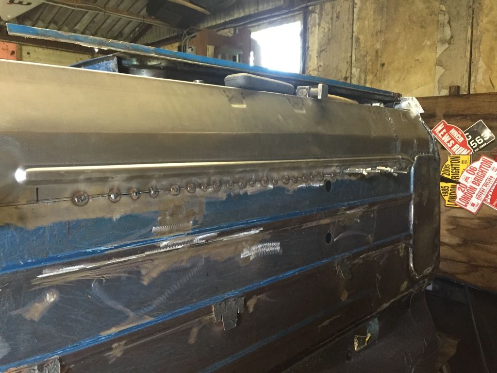

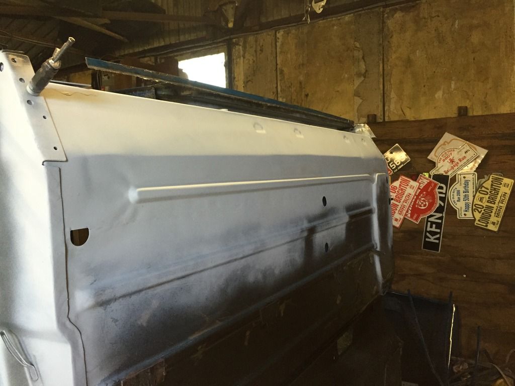

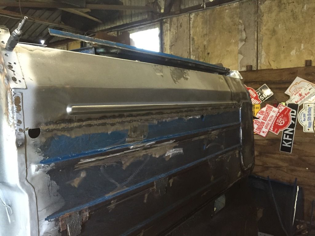

You can see at the back of the flute somedistortion there which was caused by the pressing process. I did give it a little tickle but to be honest by the time it was covered in stonechip and paint its barely noticeable. So unless you are going full on show level bare painted floor then dont get to fretful about it
Worst case scenario you can skim it with some filler.
0ee6ce158fea65069d03489e23a26e8a804c00e1

Once stone chipped and painted, yes you can see the odd ripple but not that fussed.
