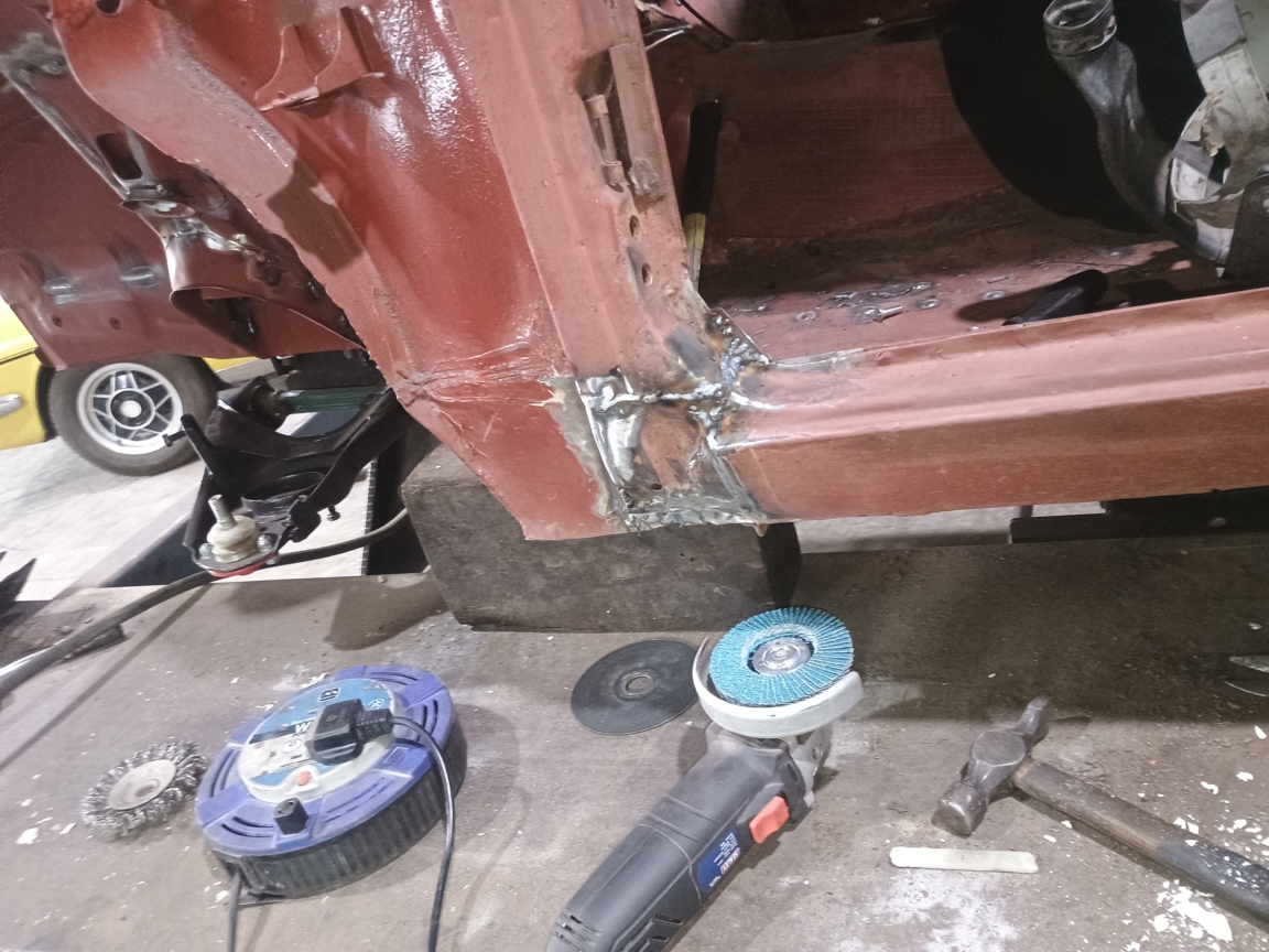

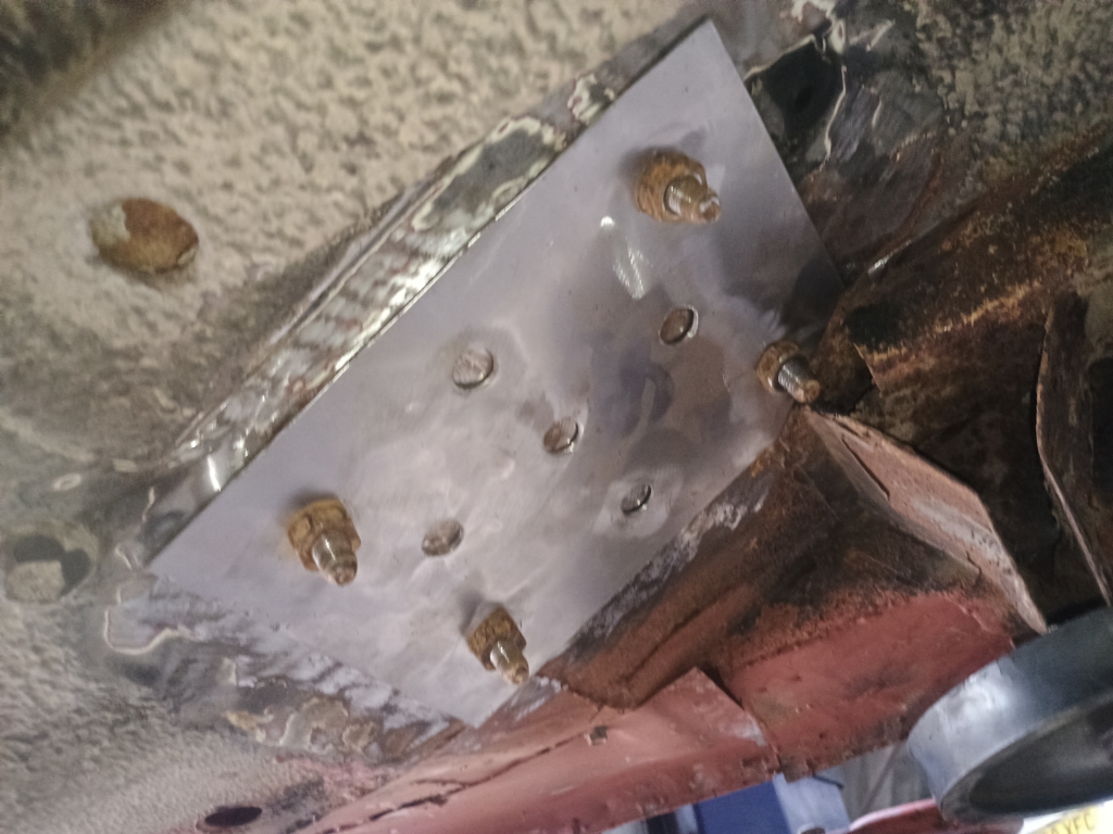

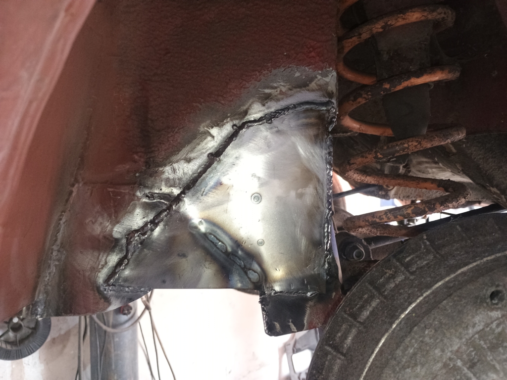

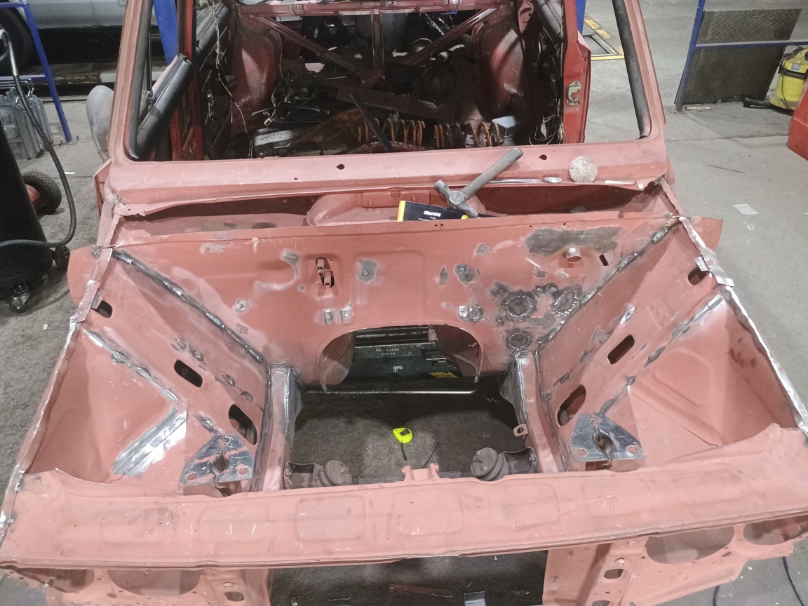

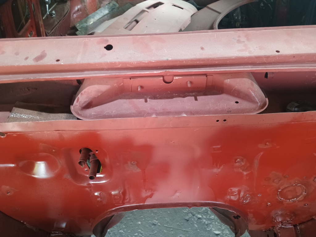

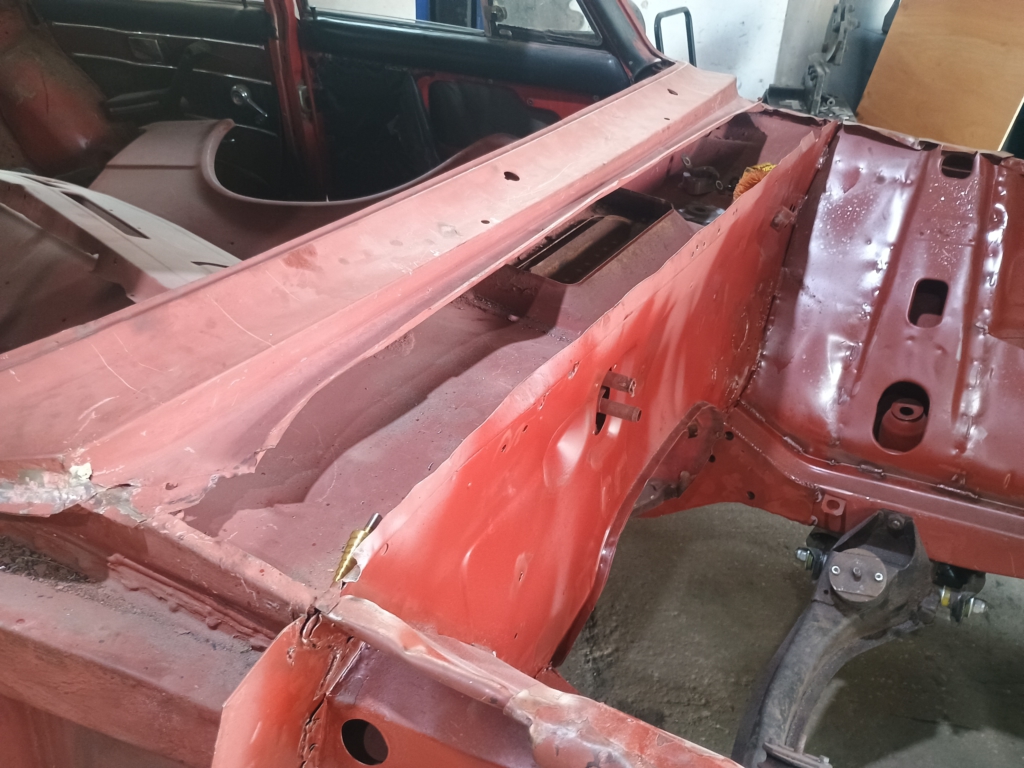

not massiev update but still... did a repair to the post
1000012253.jpg?t=1783273488
1000012255.jpg?t=1783273488
did some seam welding to the inner wings and chassie legs, put a plate to cover the holes where the old servo was etc

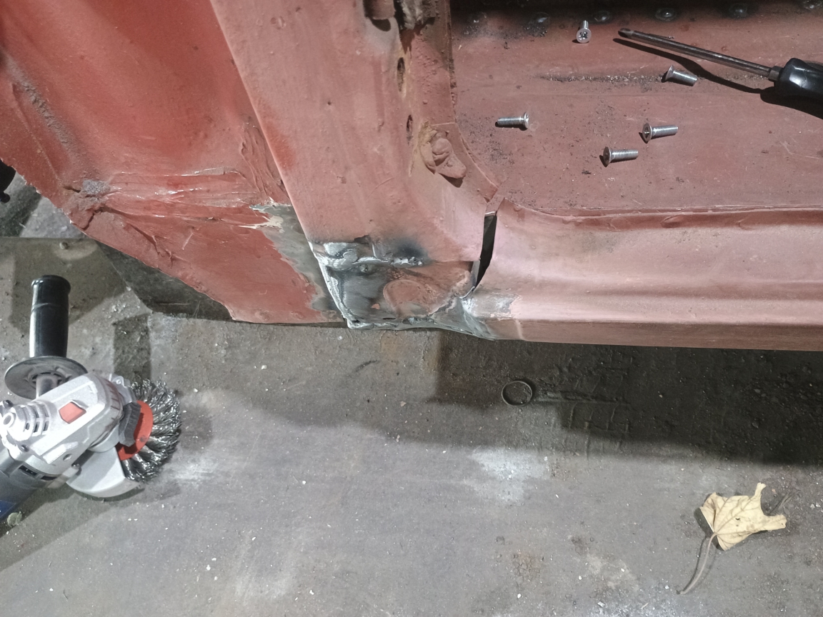

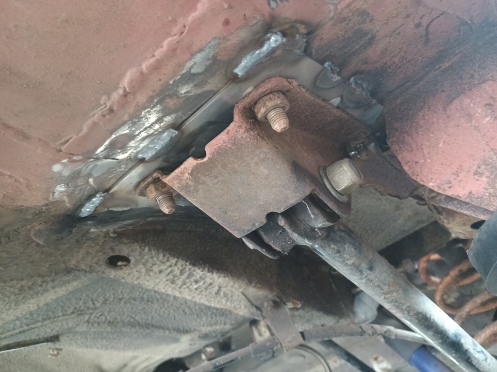

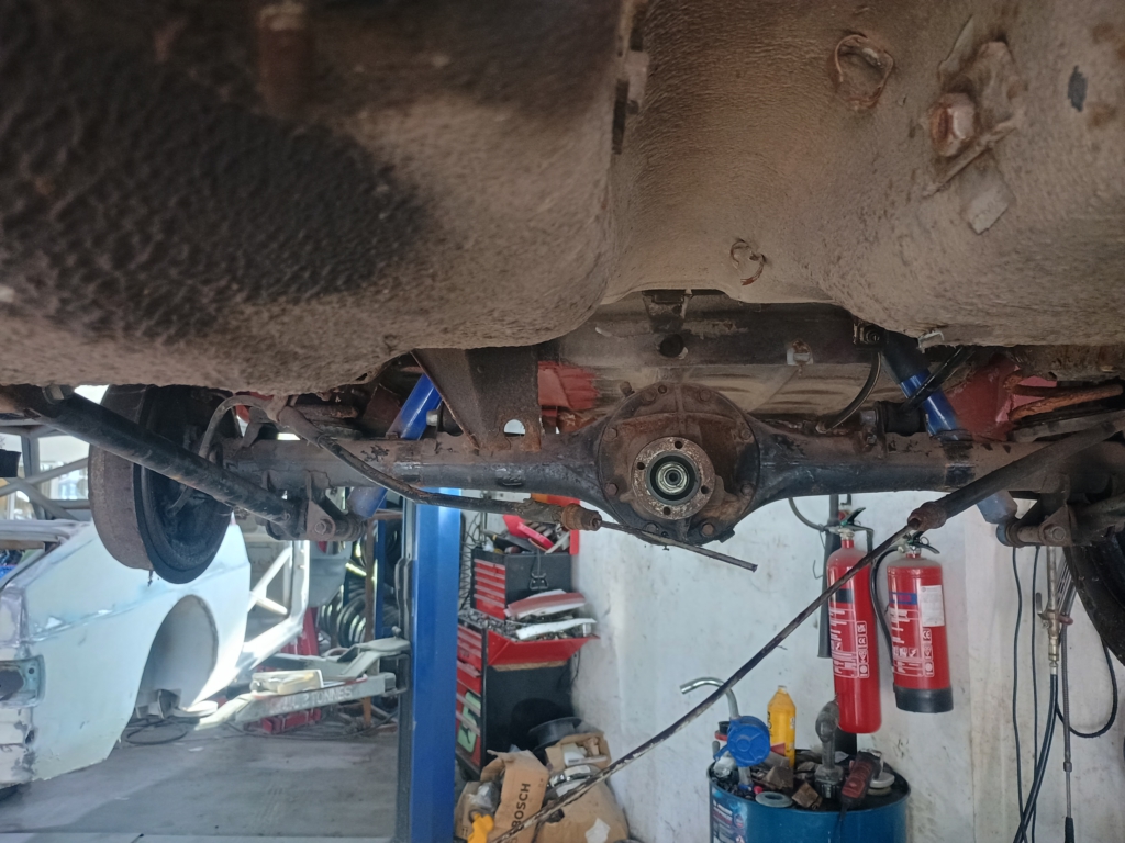

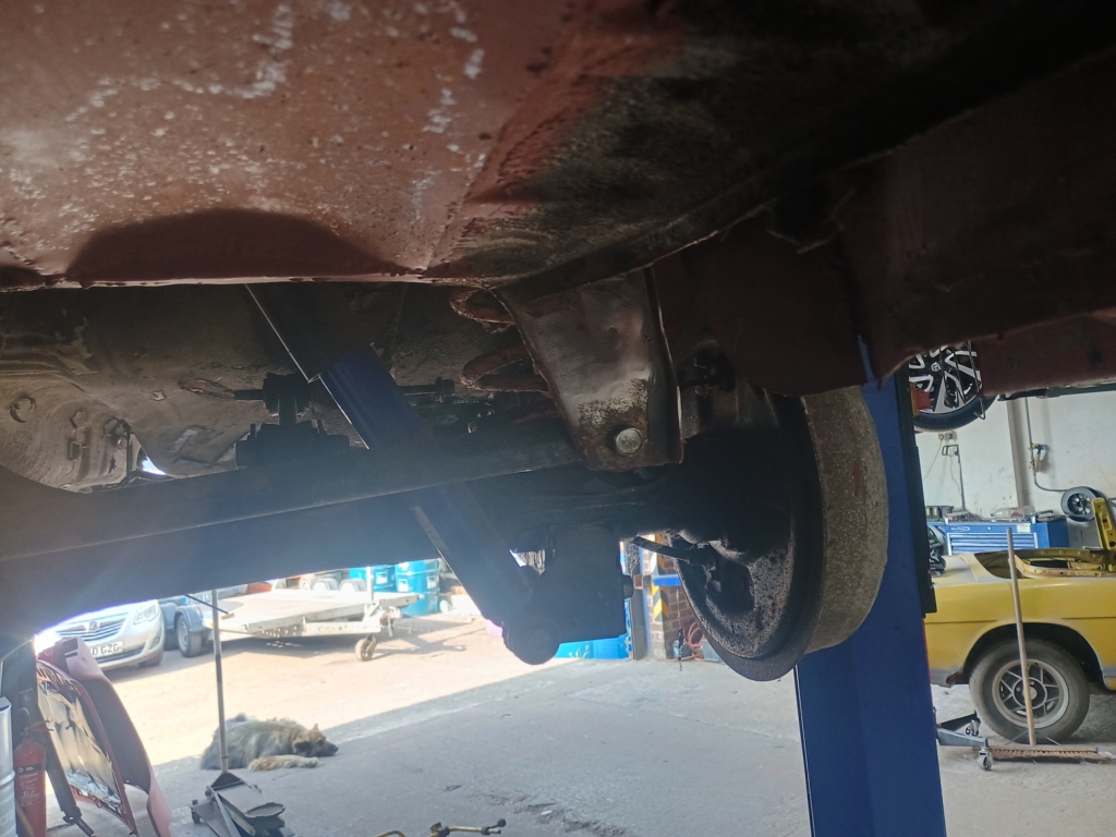

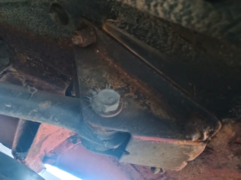

one part of the lada that seem to fail ive been told is the link bars to body. So i looked at them today
1000012480.jpg?t=1784411289
1000012481.jpg?t=1784411289
1000012483.jpg?t=1784411289
1000012484.jpg?t=1784411289
they are 1.5mm plates, will do new bolts instead of studs for the mounts.

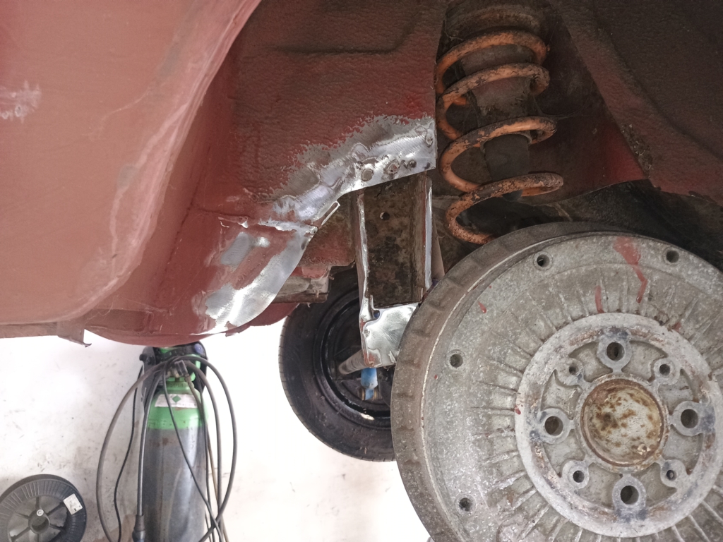

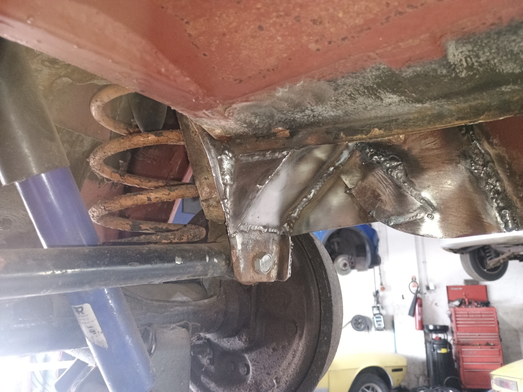

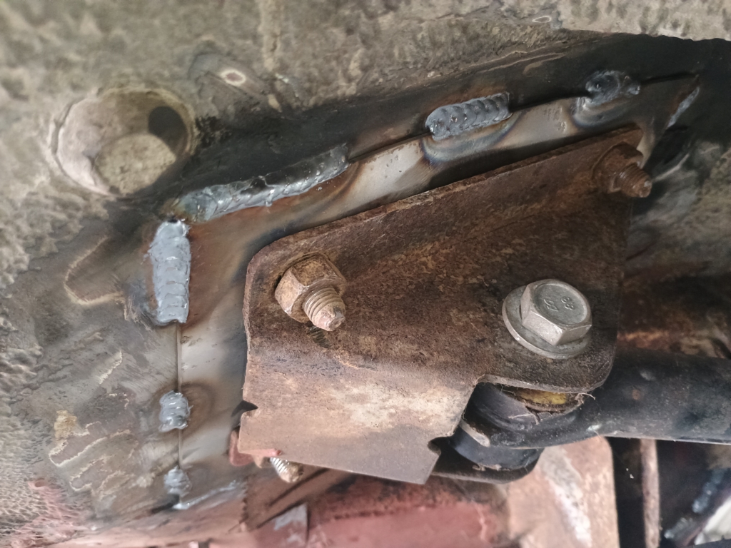

i also did some strengthening of the 5th link mount to body
1000012486.jpg?t=1784411289
1000012487.jpg?t=1784411289
1000012488.jpg?t=1784411289
1000012489.jpg?t=1784411289

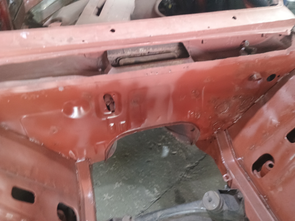

i drilled out the spot welds that hold the strengthener for the bonnet latch, reason is i need to put a RHD wiper motor on this car, but no lada factory set up will fit.
1000012490.jpg?t=1784411289
1000012491.jpg?t=1784411289
1000012492.jpg?t=1784411289
so ill be lookign for something like a corsa wiper set up.
