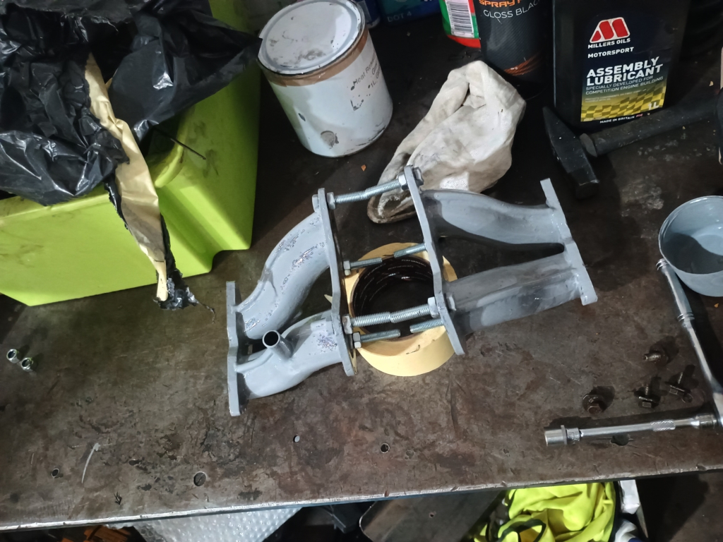

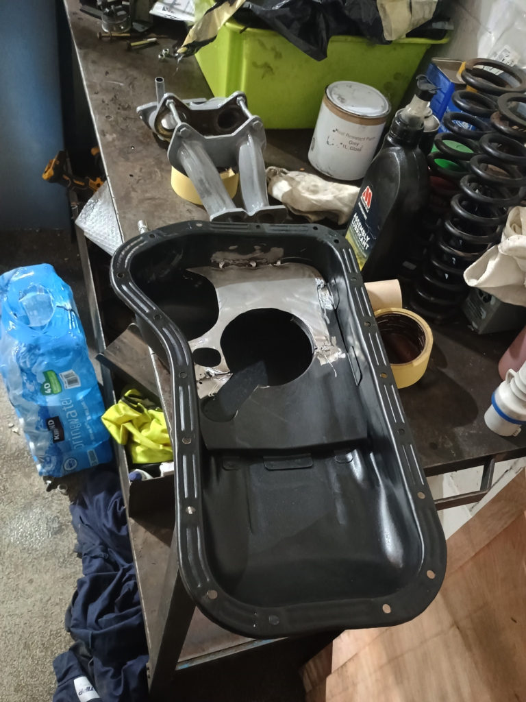

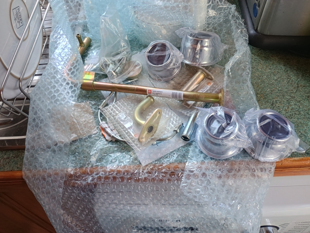

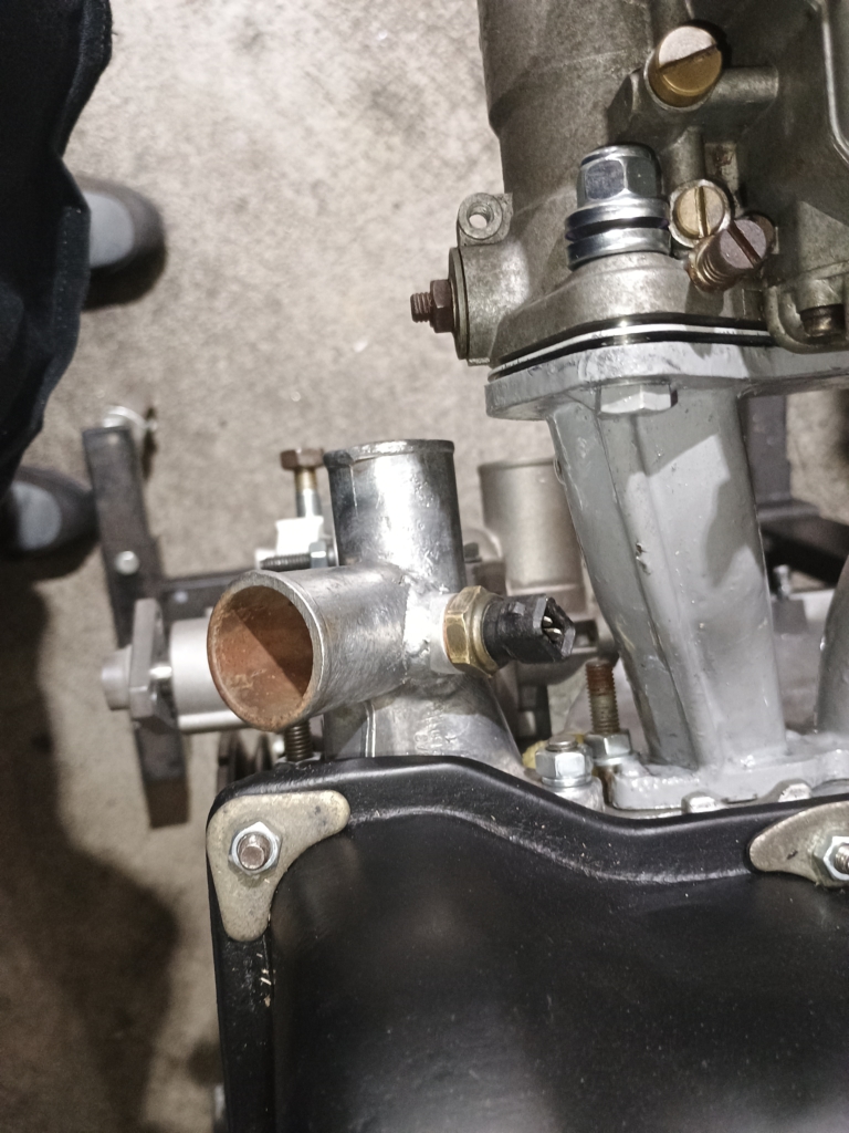

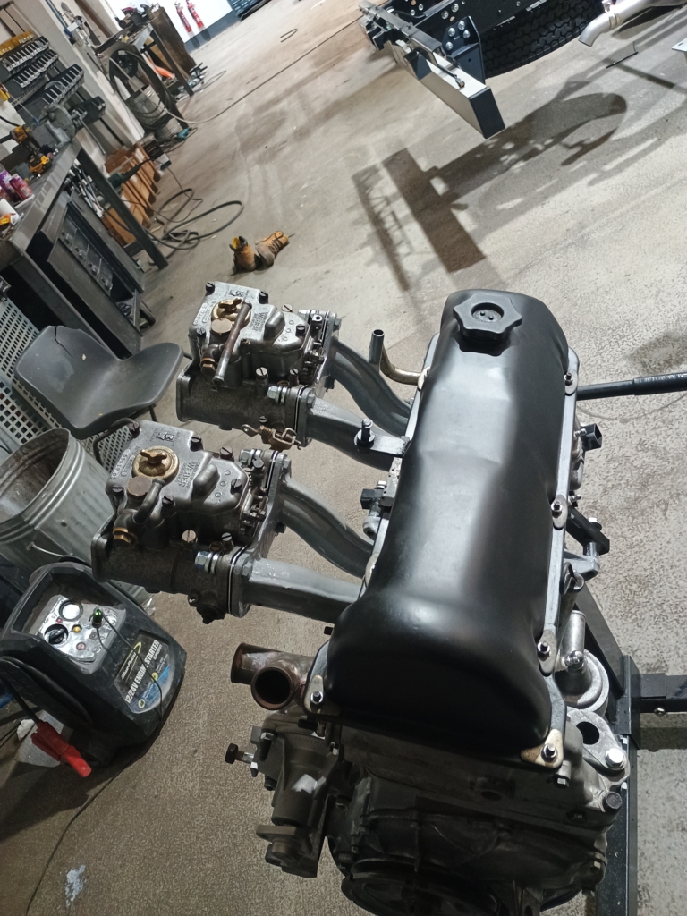

not massive update, been doing hte engine at work int he mornings, painted the inlet manifolds grey, and did the sump plates. found that a 21214 niva oil pump is deeper than a 2103 one, also the dip stick is in a different place.

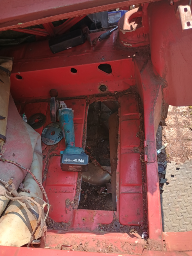

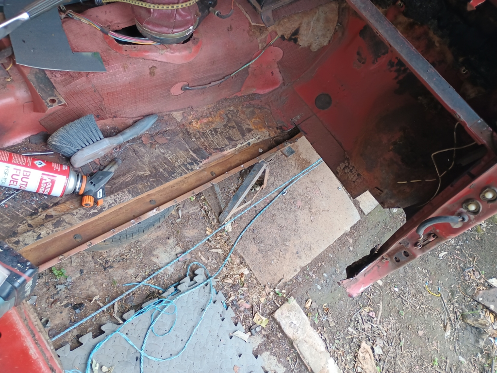

started looking at the boot floor today, and found that it had a strange rot to it. It was rotten right above the exhaust but it didnt seem right. so i started prodding and i never knew that int eh boot floor there is a sandwich of plates with asbestos in between!!

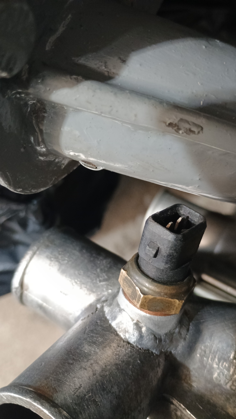

i have been doing bits as i say to the engine at work, new standard oil pump, sump is done, bought a crankshaft sensor, and a few other bits. found the water temp sensor for the ecu hits the carbs, so will have to do something else.
the carbs are early ones, they have the 7mm shaft, but i need to make a tps adapter for them, not sure exactly what to do as of yet

small update, its been too hot to do anything ont eh car really. but i did a few bits to the engine in work. I am working on a tps set up, but havnt taken any pics as of yet. I had a problem though, the Niva temp sensor for the ecu hit the dcoe inlet. I just bought a boss, and had it laser welded at work

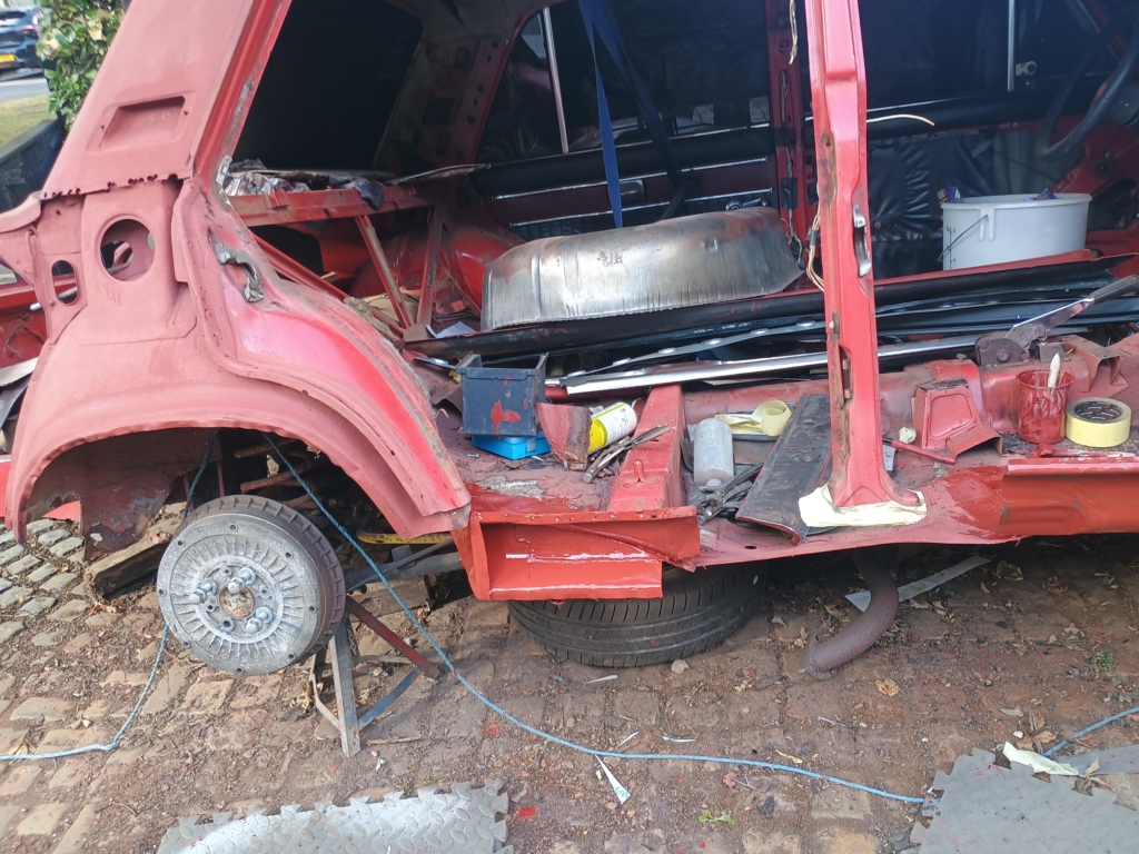

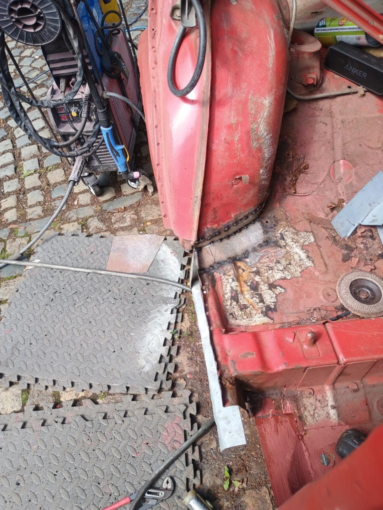

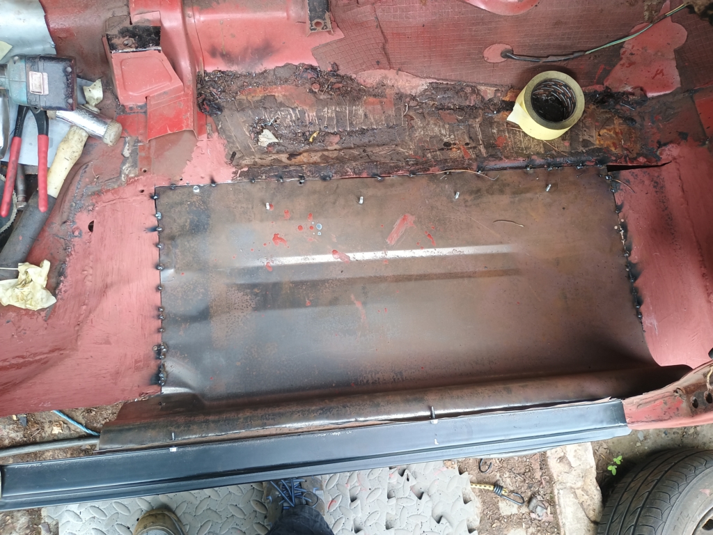

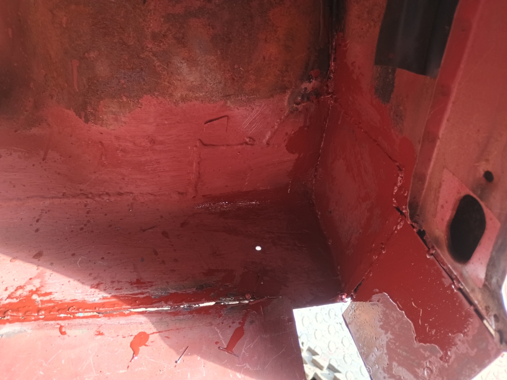

started on the side again today, welded a bit up a the rear suspension link rod mount, and started with teh floor.
found a visitor on the car too..

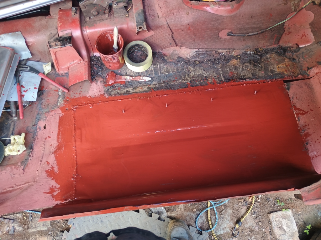

floor only partly welded but it willr ain tonight so painted it all. hopefully more tomorrow

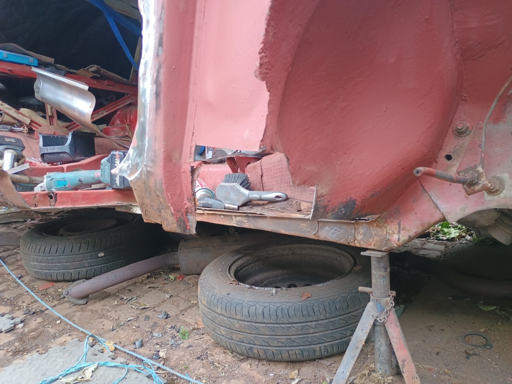

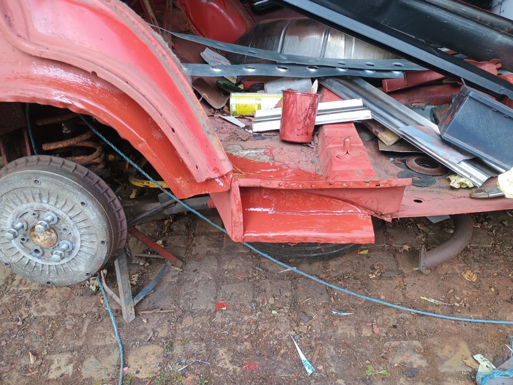

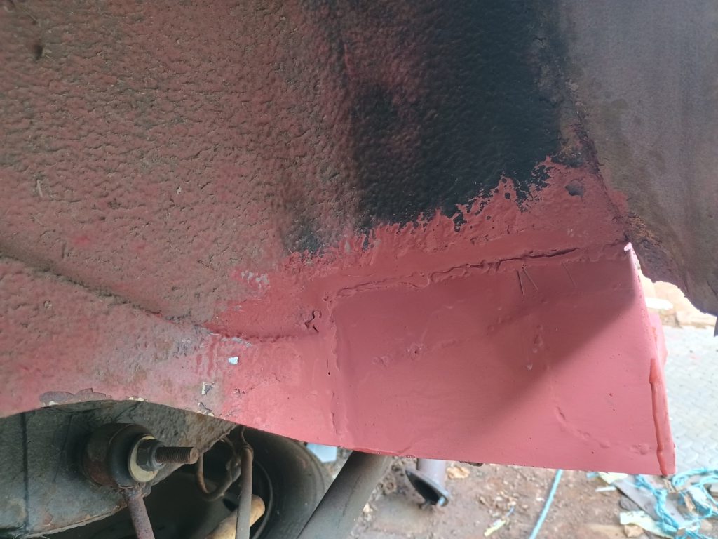

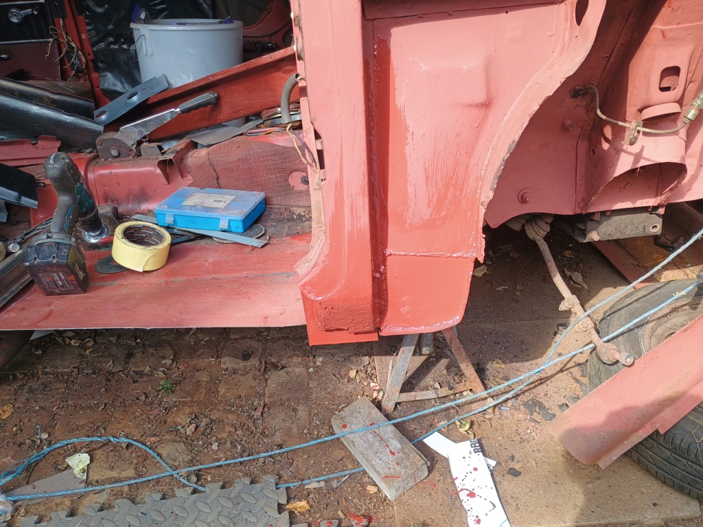

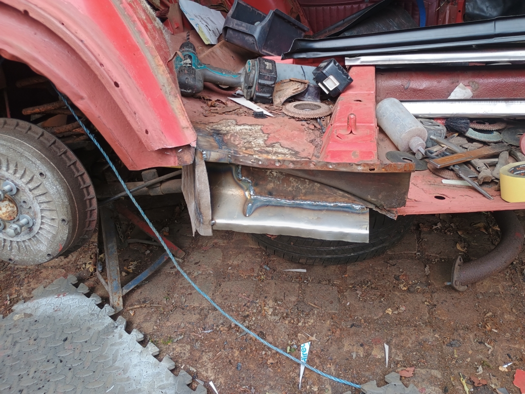

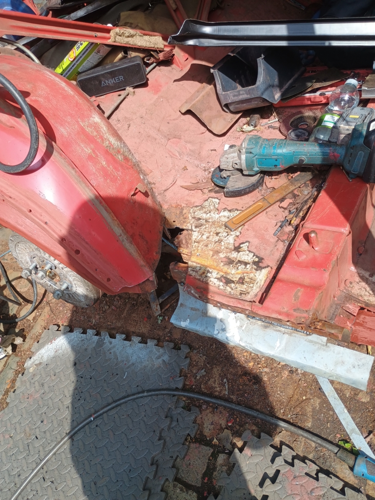

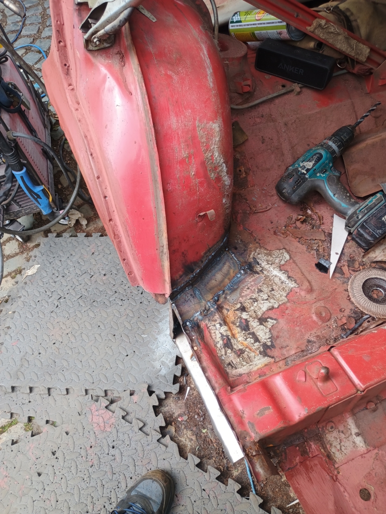

The Lada today, i welded up the front of the floor pan, then i added a patch to the inner wing type area. Then when i looked at the floor, i saw it was too material for the height of floor wanted. as in, i had to cut it and remove some from the weld.
where this is tacked on in places and painted, its not finished, its just being protected as itll be at least a week until im back on it
here is a pic of yesterdays repair, and the wheel arch area i didnt show yeasterday
plan is to weld it all then go back and make it look better.

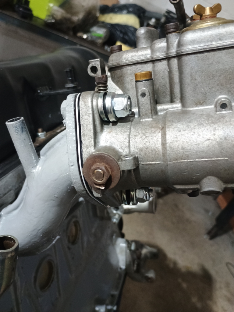

here is the tps addapter done almost [just bolts etc to do] i used a m7 tube nut, i cut it down, drilled it partly 6.8mm and tapped it m8. then i put a m8 bolt into it cut it down and put a flat on it to index into the tps. I then made a bracket to locate it

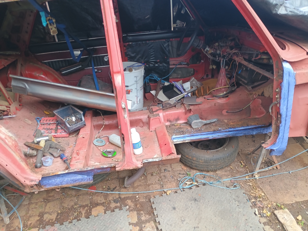

First job today was try the quarter panel to make sure the sill was going to be ar the right height.
then started trial fitting bits and welding them in

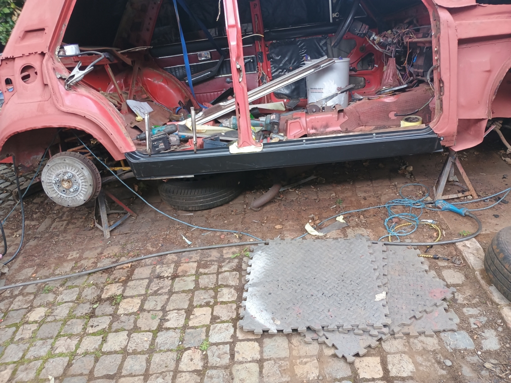

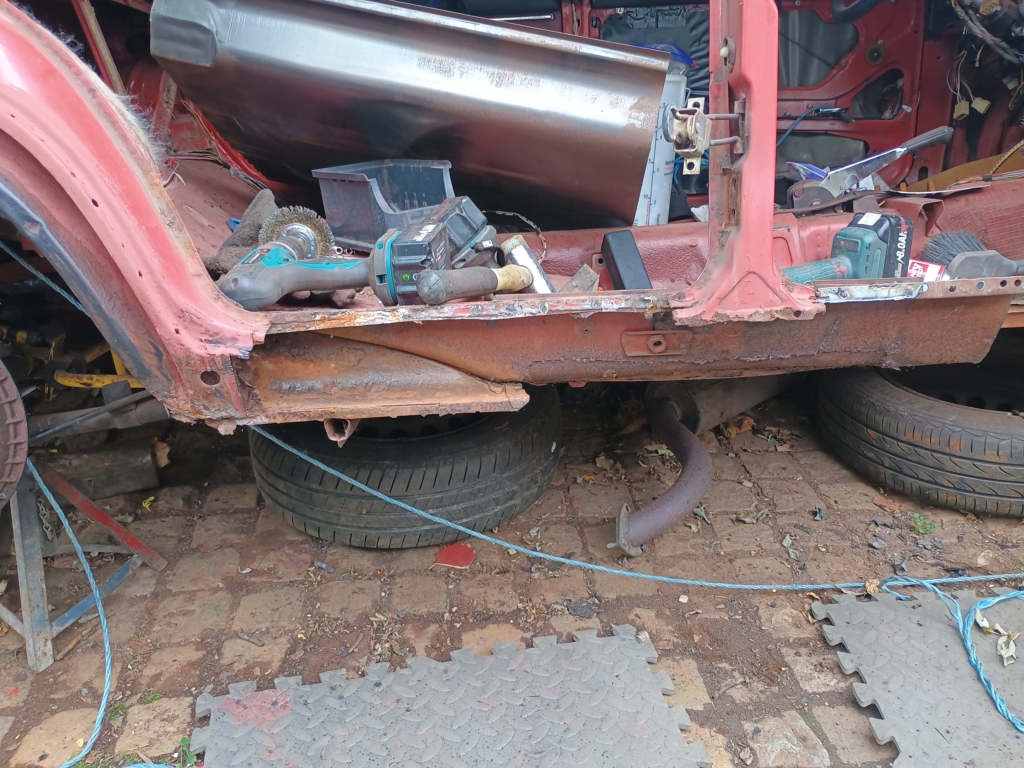

today i trial fitted the doors, sill, and parts, stripped it back adn welded the mid sill in and its support

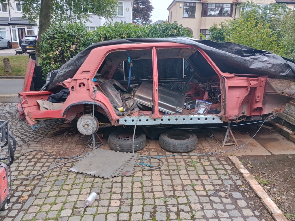

i have started to stip the engine bay more as i want the engine out soon and the box too. The car will be put on its side to have the floor sorted
1000006473.jpg?t=1759265232

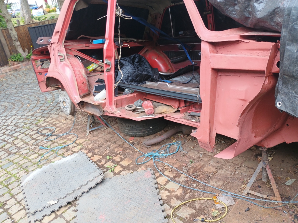

i started on the quarter panel too, tec screwed it on, and then welded it mostly on too.
1000006454.jpg?t=1759265232
1000006455.jpg?t=1759265232
not nice here, had to cut and weld it some

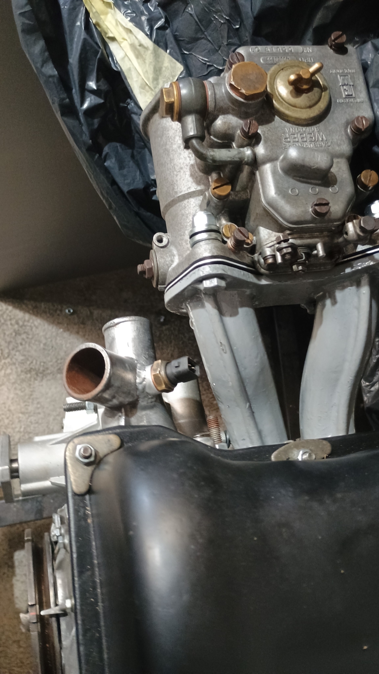

the last update is i ve decided the dcoe maybe ok, but to tune it and know how to sort it isnt me. So i have looked as a standard type down draft carb, but it is quite expencive mod for me as i dont have the parts, new the inlet from lada power is £100, plus carb and parts. Then i had the thought that, i have the bmw rally car, it runs megasquirt and a bosch ignition amp, and etc etc, so why not have the 2 cars simular so i can test parts on each other. As in, like when i had the R100 it just seems the right thing to do. So i am going to order a set of cherryberg 40mm twin throttle bodies, and probably use a microsquirt ecu. I am really looking forward to wiring this up.
i also found the engine bay wiring was either a fire or a call to the aa at best. I can run a lot of things from the microsquirt too, liek the rad fan, fuel system, etc. Ill use the same parts i have on the Bmw, 100% chinese fuel line fittings etc too.
