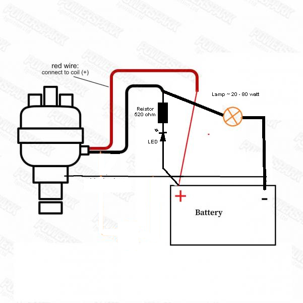

Could sketch a wiring diagram ?
#140 Spider
Spider
  • 15,811 posts
  • Location: NSW
Posted 14 December 2025 - 12:47 AM
This should do it
the 520 ohm resistor need only be a 1/4 watt type and is based on the LED forward Current being 20 mA

This should do it
Thats great, thank you very much !
I guess the resistor sholud connect to the +ve side of the LED, sure ?

This should do it
Shouldn't the high wattage resistor (bulb) go to the positive terminal of the battery instead of the negative?
Hahahaha,,,,, my turn !
That's what happens when doing 3 things at once !!
Yes, you are spot on, the bulb should connect to the battery + not the - as I have it in that diagram.
