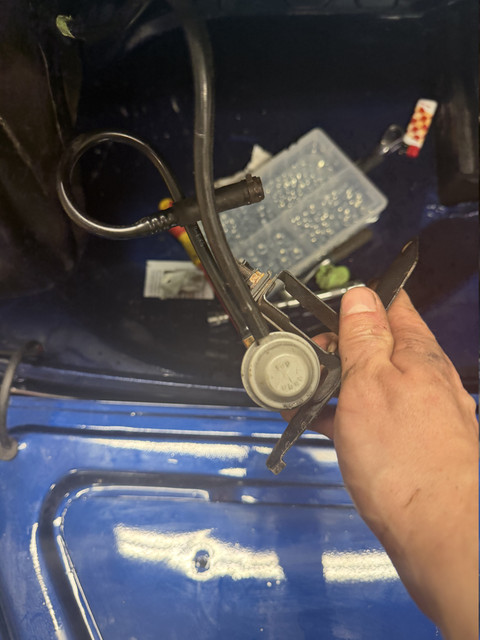

This might be a dumb one, but refitting the fuel tank I’m wondering where this breath hose connects to? I can see a line going to the boot floor but not sure on the other side. Hope the pictures helps a bit.
I don’t see anything going to the fuel tank for this, but as a breather hose maybe it shouldn’t!

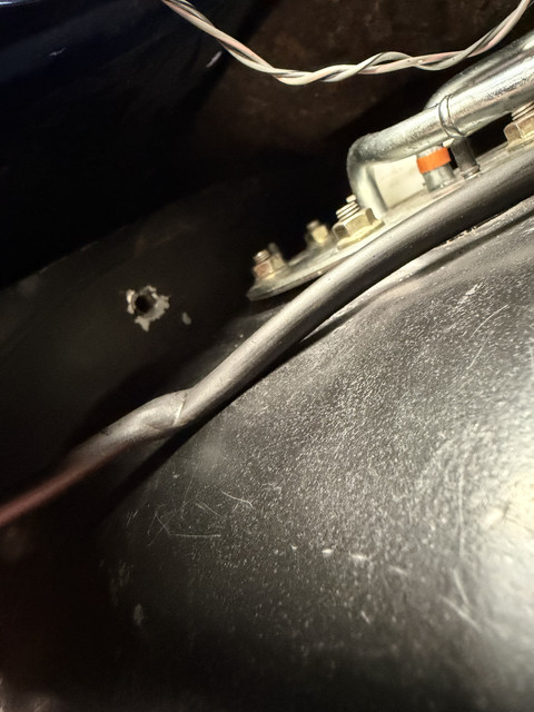

I think I might have found the source of my issues…doh
Is there a way to fit a new fitting inside this tank, looks like whatever thread was there has been stripped if there was one.
