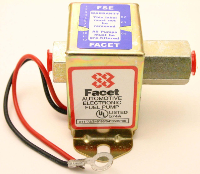

Which one do you think is better for feeding the twin SU HS2s? Is one quieter than the other? Pros & cons ⛽
Thanks in advance!

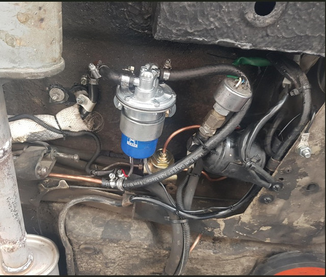

AUF214MS is the Mini Spares part number for the German made Hardi electric fuel pump that was recommended to me and I like it, I have one on the mini and also the MG1100.  You should give it consideration.

I've been using a Facet cube pump for years without any issues

Thanks Croc for your reply. As you can see, I actually bought that pump five years ago (from Minispares) but decided not to install it—and instead sold it—after a friend told me that only a tiny trickle of fuel came out when he mounted it on the rear subframe.

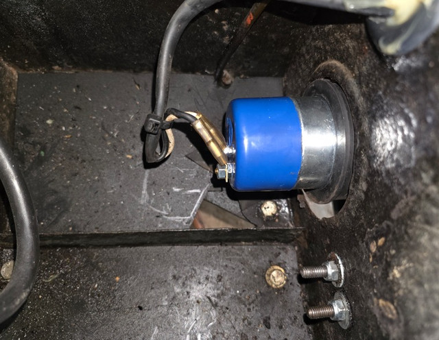

I have Ecco pumps on 2 minis at present and will be fitting another when the mechanical pump packs up on my wife's mini. They are the correct pressure for a mini, if you buy the right model. It acts exactly like an SU Pump, only ticking when the fuel pressure drops. I believe they are pos or neg earth and come complete with mounting bracket etc.
A New Zealand product which I know is used on Morris Minors. MGB's etc. think they're on the Fuelsave website, where you can see the various models available.
I recommend them. (hopefully I'll get a parcel in the post after this)!

No. these are the ones I use. 2 - 3 psi. https://simonbbc.com...Ss10amEhL5xj6fC
One  is on a 1293 with 80bhp and the other is on my 1098 with 78 bhp. Absolutely no problem with float valves or modern fuels.

That ECCO fuel pump model is exactly the one I was looking at yesterday. It delivers between 2 and 3 psi, which is precisely what a twin SU HS2 carburetor setup requires. Therefore, installing a pressure regulator might not be necessary, as it won't flood the carburetor float chambers.
Whistler, would you be so kind as to tell me what place have the ECCO pumps installed in your cars?
Many thanks in advance!

Original location on rear subframe, on both cars.
