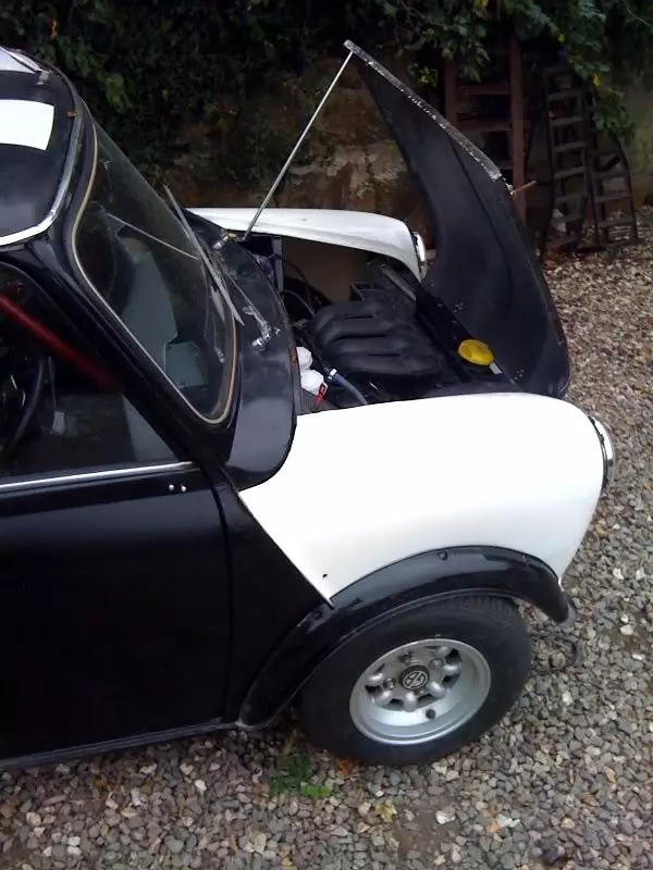

Made up the stainless link pipes for the water hoses, have ordered some more bits from CBS online for plumbing the heater in.
Need to go to scrapyard this weekend and get a VSS off an Astra and also the Corsa header tank. Also need to drill the MPi radiator to add an extra line for the return from the header tank. WEEEEEEEEEE.
I now have a forwards opening bonnet though. Awesome.
#1137 The Matt
The Matt
  • 17,232 posts
  • Name: Matt
Posted 08 October 2009 - 12:56 PM
#1138 alexcrosse
alexcrosse
  • 3,786 posts
Posted 08 October 2009 - 01:49 PM
nice >_< about ready for a test drive?
